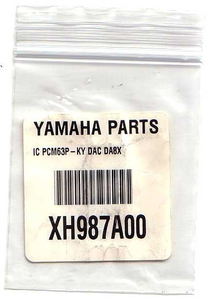

Actually, A’AF’s chips could indeed be from another factory: The PCM’s pins, both of his "Y"s and his "Military K"s, looks slightly different and it was quite difficult to insert them into the sockets.
This can be a good indication for some different production standard & manufactory, while they might have been produced under licenses - or unauthorized.
In any case: A'AFs new "Military K"s (from 2003 or 2004) sounds as good as some used genuine BB "K"s from 1994 or 1996 (Japan or Korea). If aging occur only when the chip is in use (thank you for this explanation), this might explain this point as well. In other words: A genuine - non aging-new-old-stocked BB “K” chip might sound even better. Someone should look into this.
As for the subject of this thread: A'AF's new "Y"s (2003) are good sounding chips. However, they doesn't sound as good as the genuine Yamaha "Y"s.
What can one do with all this info? Not much: After all this long exploring & sharing, it is quite upsetting to know that Yamaha does not supply the genuine part anymore. Instead, there is some “replacement” available, which costs about 100.- Euro each (!!). I wonder what kind of chip it is (am awaiting Yamaha's answer).
Funny, but the Yamaha “Y” which I got, were supposed to be “KY” (see the Foto).
By SONY-Parts, the catalogue it is even more disappointing: They are only 2 K2 Chips left, and they are somewhere in Japan… The last 2 chips which were kept in Europe are sold-out.

Bernhard,
One can however:
1. Select a good pair of “Y” (2003, not 2004!) from A’AF’s chips-selection; this is only recommended to those who can keep cool and not get easily angry or depressed. The chips are very different sounding among themselves. Hopefully A’AF is capable of re-embracing the money, like he was able to do at the past (??)
2. Look for NOS genuine BB “K” – there is no aging dangerous.
3. Buy some old Yamaha device (DA8X) and take the “Y”s (KY’s?) out; hopefully there will be no too bad aging to be noticed! We just bought one yesterday (am awiting it to come).
4. Look around to find some genuine Yamaha “Y”s like I did (this took me half a year of researching).
5. Study Japanese and hunt for genuine “Y”, “KY” or "k2" in Japan.
6. Go for the PCM1704U-K adaptors and fine-adjust the DAC.
7. Give up and go for a modern chip.
I hope I am not appearing to be cynical now. This is NOT what I am trying to do here.
Regards, IJ.
