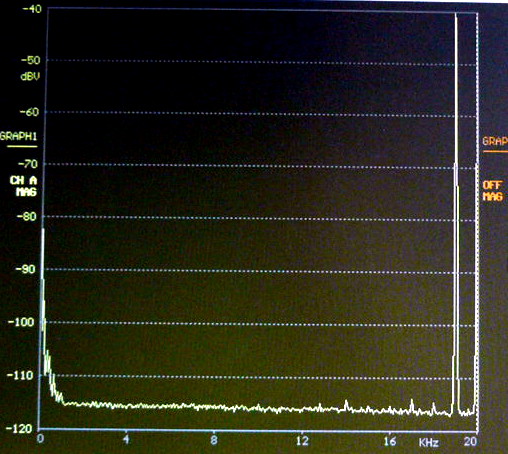

Intermodulation in my op amp I/V
Is there still somebody interrested in measurements?
With my challenged op amp I/V-convertor with second best PCM63-K's (I sorted out from a batch of K's and Y's from A'af + a number of myself) in my TentDAC, I tested with two tones: 19 kHz and 20 kHz - 6.4 dB so that the sum became -0.3 dB on the testdisk.
This measurement have been executed (or simulated?) by Hawksford in his article we quoted before.
Any comments?
Again I begin to think that I can only trust myself, my measurements, my ears, and let others shoot the breeze, including Hawksford.....

At this point it would be nice to see some IMD test for one of the jfet IV circuits..

To avoid misunderstanding: My TentDAC is the original DAC except the PLL, the VCXO and the IV-convertor! The print layout of the master board, with the reclocking, is excellent.
The IV-conv. in use, is the one on my web site with three times OPA134.

PCM1704 versus PCM63
Investigation of four PCM1704's on a altmustech plugin.
I measured the distortion of a 997 Hz signal with levels of 0 dB down to -78 dB in 6 dB-steps, just as I did with fourteen PCM63's reported earlier here.
The 1704's measure as the average PCM63.
I also measured the intermodulation distortion with two signals of - 6dB, 19 and 20 kHz, so that their sum is 0 dB in the peaks.
The intermod seemed to be better, but in fact the intermod of the IV-conv is measured. Because the output current of the 1704 is 1.2 mA in stead of 2.0 mA (with the 63) the intermod should be less, and indeed there is no intermod noticable with my opamp IV-conv. The 63 gives the same pictures with an input - 4dB which correspondents with 1.2 mA.
With recordings that do not exceed the -6 dB, I could not hear remarcable differencies between 1704 and 63.
