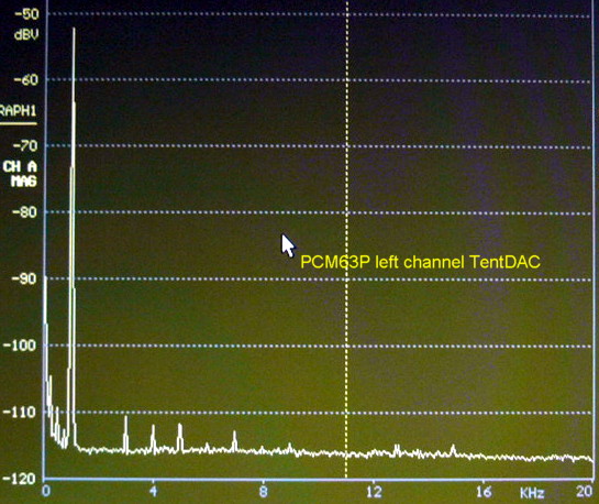

spzzzzkt said:from page 5 onwards there are spectrum analysis of various dithers. Only one has a flat noise floor.
Yes, the one without noise shaping... (TPDF dithering).
For measurements you should not use noise shaping. With only dithering, the noise floor is flat. 😎
