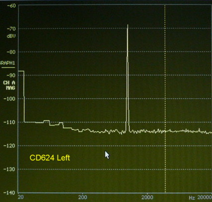

PCM63 K's and Y's compared......
For the comparison I generated me a test disk with 991 Hz-signals of -78 dB up to 0 dB in 6 dB-steps. Measuring only at 0 dB and -60 dB is absolutely insufficient. Some IC's are excellent with -60 dB and very bad at -66 dB or -54 dB. Be careful!
Thanks to A'af, I could test 14 PCM63 K's and Y's with this disk. I counted the harmonics which were 3 dB over the noise floor with each step and added them finaly.
There is one K and one Y which showed no more than 15 harmonics over the noise floor in the 16 measuring levels. These are the best ones.
The worst one was a Y with 76 peaks!
There is no any correlation between distortion and the type Y or K, so the Y's are no fake !!!
Some K's are dated 1994, some 1993. All Y's are from 2004.
Did the best IC's sound better than the bad ones? Hardly.
As soon as the harmonics peaked over the noise, the THD was always better than 0.02 %. In the very most cases 0.01 % or better.

The rising noise floor of the dither ?? I never noticed this. (Look at the pictures above).
For me, the only way to test a DAC is in combination with the I/V-convertor. Otherwise you should measure the output current of the DAC. (Be aware that the input-impedance of the circuit behind the PCM63 should be low! With my I/V this is less than 1 ohm because of the virtual ground.)
It is not so difficult to build a very good I/V-convertor + low pass at 20 kHz with 12 dB/oct without any capacitor in the signal-path and with less than 100 uV DC at the output. You could find one on my web site (the explanation is in Dutch, sorry!).
For the measurements I use a CLIO-system from Adiomatica: a special sound card + special software for measuring loadspeker systems. One of the options is FFT. The noise floor of this system is -130 dB. If I play a track with 'silence', the noise level is also -130 dB, so the I/V and the power supply are OK. If I start a track with, say, -90 dB than the noise floor rises to -113 dB with an I/V-convertor which outputs 8 dB more than the red book prescribes (0 dB is with my set up +8 dB on the analyser).
I also generated a CD with a 'log. fade in' from -96 dB to 0 dB over a time range of 10 min. Watching the analyser with this test signal is very instructive.
