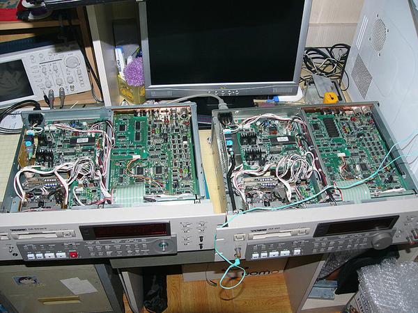

See how my friend and I toyed with Tascam DA-60 MK.II.
I have about 10 DATs, 7040, R500, 2700, 2500, two Tascams, one Fostex, etc.

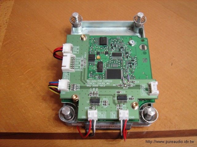

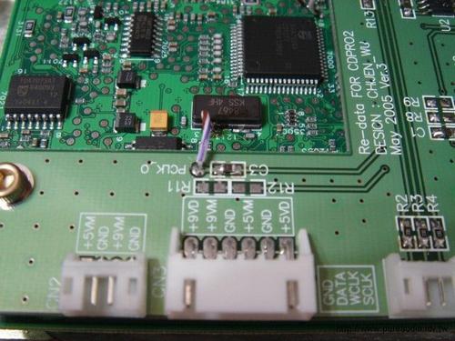

Got some free time tonight, let me rephrase the whole thing again. Let's start with DIR901.
1. DIR9001 already has a controller-PLL-vcxo loop inside. TI/BB even gives it a fancy name:
Sampling Period Adaptive Controlled Tracking system (SpAct)
2. TI claims that this PLL loop will only add on 50ps jitter. I can see in reality it's more like
100ps. Still a very impressive number, consider there are so many components involved.
3. The PIC-ADC-VCXO loop is just like a second layer of PLL loop after DIR9001
4. With a tiny buffer, the PLL has to react quickly to lock on the incoming signal.
5. Yes, you can adjust the filter in the loop to lock on incoming signal aggressively.
The PLL will keep locking on beautifully but this also means the output clock signal will
follow the input clock closly.
6. This means you are actually following the input jitter instead of reducing the jitter.
7. VCXO in frequency transition is a phase noise generator. You also have to count in the extra
jitter generated by the components in the loop.
8. In short, this loop is not much different from the PLL loop inside DIR9001. This redundant
layer will just add more jitter to the signal.
9. To reduce jitter, you will have to create a circuit with high Q value, i.e. the output
clock and data should stay as stable as possible when the input keep changing.
A properly built buffer/FIFO control is one major solution.
Now go back to the ground zero:
1. If the SPDIF is clean, DIR9001 will do a job good enough. One extra loop with tiny buffer
most likely will just follow DIR9001's output and increase jitter
2. If the SPDIF is clean, DIR9001 + ASRC will be an attractive solution because ASRC has
a decent size buffer and the read out clock definitely has low jitter. Currently this is a very
popular option.
3. If the SPDIF is dirty, DIR9001 will struggle to follow the input, the second loop
will be busy with catching up all the input change, too.
4. CS8412/8414 has a relatively noisy PLL loop. In some scenarios, the second PLL with small
buffer may actually remove some jitter. Yet dont bet on this.
5. Therefore, it's much more beneficial to get a clean SPDIF output at the first place.
