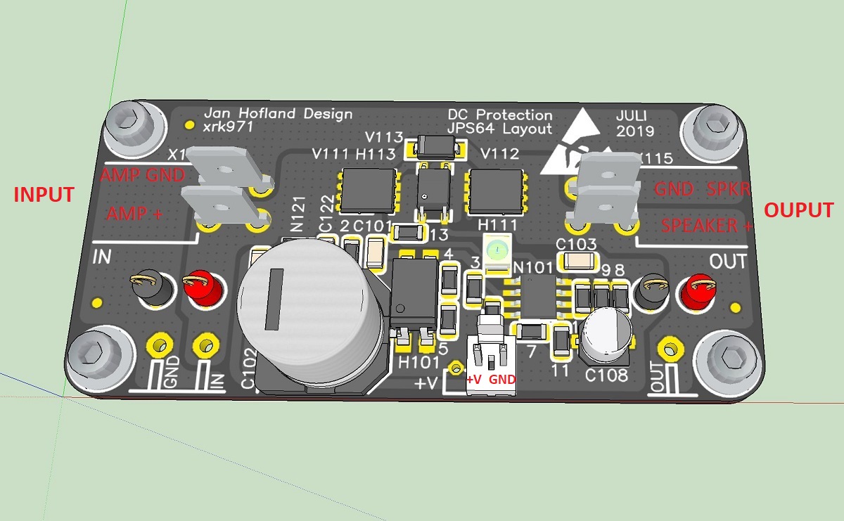

1. Do you have a simple wiring diagram to help wire up these 3 connectors (for those using them) showing which channel plus and and gnd connect to on the 4 pole molex connectors and the supply polarity on the 2 pin connector you are installing.
2. Also, I assume one of these SSR boards will handle both channels for a stereo amp chassis build.
3. I think I read that the power for the SSR pcb can be derived from the amp positive rail and GND. What are the min and max values for the DC supply for this board.
4. Also can it be powered from a separate supply - that is , it does not need to be referenced to the amp supply for the amp it is protecting.
5. It might be wise to supply a wiring diagram with each pcb you sell so members get them installed and wired correctly from the outset.
Gary..
The top row of pins is GND, the lower row is Amp input + on left, and Speaker + on the right side. The +V input is on the left pin of the Molex connector, right pin is GND.
attachment.php
No, it has been clearly stated early on that these are mono, 1 board per channel.
Minimum would be about +18v, max value that we recommend is +50v. The on board voltage regulator can handle 150v, so no issue there.
That's correct, a 19v or 24v volt supply from a wall wart would be fine.
That's what the thread is for, but a good idea to make it more idiot-proof. It's hard to mess up the connections.
I'm sorry, but I am a bit confused with the connections.
I can understand the two QC connectors for leads from the amp on the left, and two similar QC for leads to the speaker on the right, in your 3D model image above. But the connectors at the bottom of the image, lower-power ones, are confusing me. I understand that some sort of DC supply will be connecting to some of those leads, but there seem to be more connectors than necessary just for the DC supply. There is an "in" and "gnd" on the bottom left, and a "v+", "gnd" and an "out" on the bottom right.
I am guessing that the 2-pin Molex on "v+" and "gnd" is for the DC supply. The other three are for....?
Please help?
The leftmost connections marked GND and IN are redundant with the QC inputs so you could use right angle pins there to plug the board into a mother board. Same is true for the connection on the lower right side of the board marked OUT. The footprint in the lower middle where local power is supplied happens to be three pins with V+ (positive) in the middle and V- (GND) on either side. You only need to connect to two of those three, as is done with the header shown in the picture.

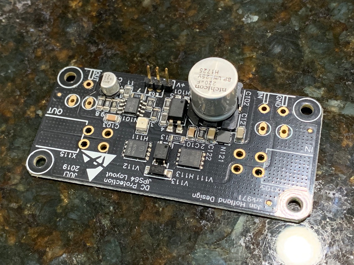

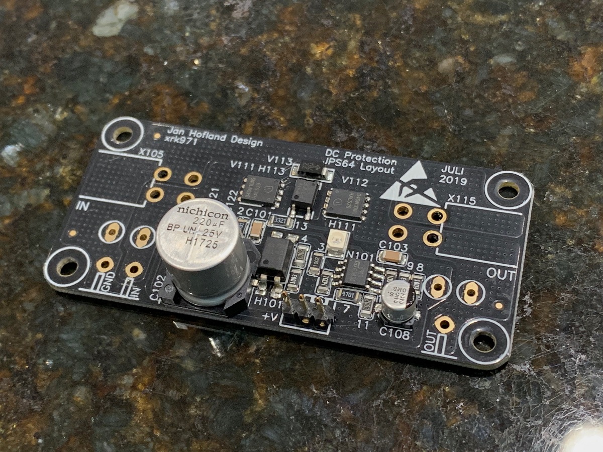

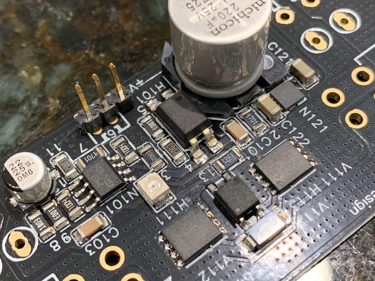

Good news folks, we just got word that the full production run of 120 units has been completed!
Also, I received the 1st unit sample that they sent Jhofland to test. It looks much nicer in person compared to the grainy photo that they sent. Here are some nicer high resolution photos of the sample unit. I hooked it up to my VHEX+ amp and it works well. I even made a video of how easy it is to install. I will have to see how to best post the video (might have to be on the IG account... TBD).
