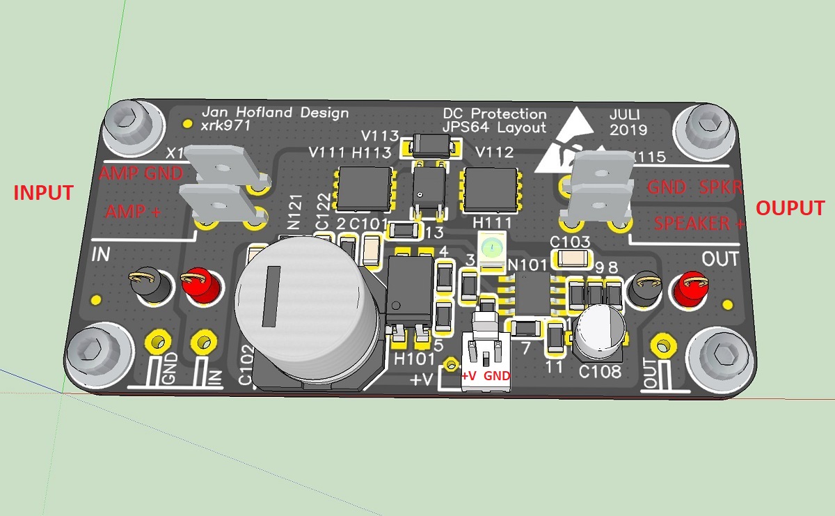

Video on how to connect your RTR SSR Protection board in under 1 minute:
XRK Audio on Instagram: “How to connect your RTR SSR Speaker Protection Board in under a minute. 5 wires: amp output +ve and GND on left, speaker +ve and GND on…”
787429d1570918357-ready-run-rtr-ssr-dc-speaker-protection-delay-gb-srr-protect-wiring-diag-jpg
788077d1571199829-ready-run-rtr-ssr-dc-speaker-protection-delay-gb-rtr-ssr-protect-sample-01-jpg

I just got confirmation that all units have been shipped via DHL and I should receive in a few more days. Looking forward to sending these out so that everyone can start using them. They are so compact and easy to install, that there is no reason not to add them to almost any (non bridged) amp project where you need some DC or turn-on thump protection.
Alhough we have not tested them at 200w into 8ohms, the 100v rated MOSFETs are referenced to ground, so they never see anymore than 57v peak (+ or -), so should be safe for use in 200w amps as well. The +V supply for a 200w amp is typically +/-60v or higher. Rail voltage should not exceed 100v (absolute).

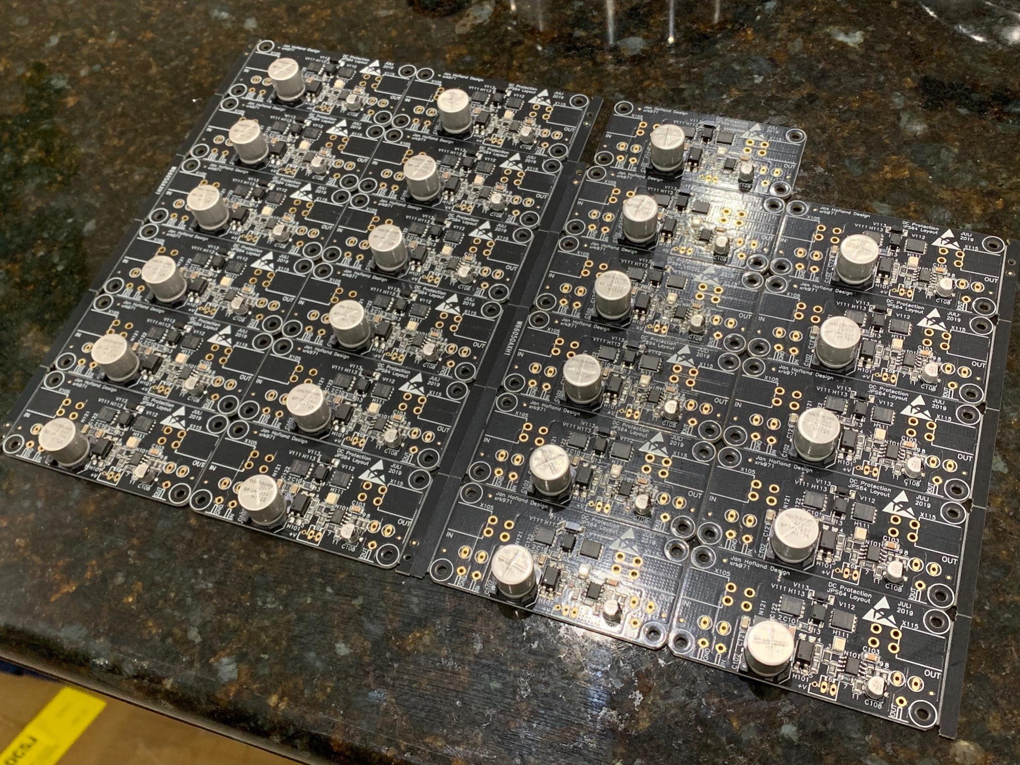

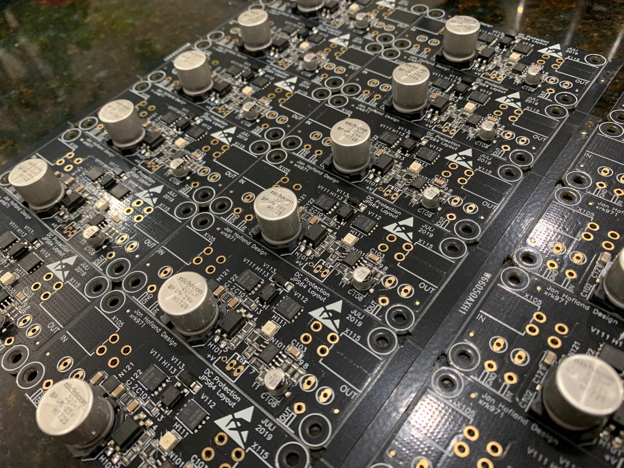

RTR SRR’s arrived
Here they are - still panelized in sets of 12. They look really neat and well made.
attachment.php
attachment.php
I need to set up a jig to test each one individually before shipping.
