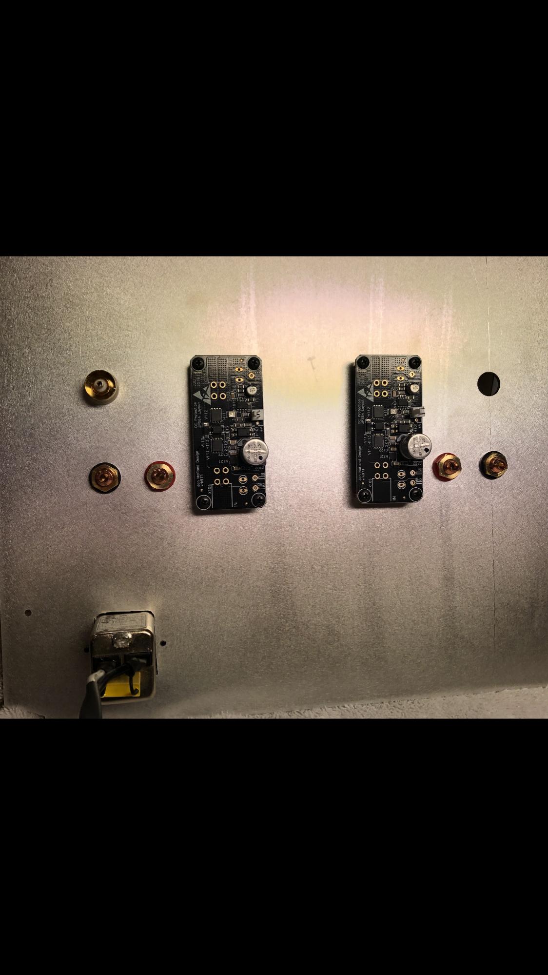

That Phoenix connector is too bulky to fit there, moreover, the pitch is incorrect as positive and negative terminal are side by side and narrow. I highly suggest you use crimp terminals either spades or Molex quick connect as designed. Screw terminals are really not ideal for the best connection. Get a crimper tool and use Faston female spade connectors with male Faston tabs. That’s how many amps are wired anyways.
