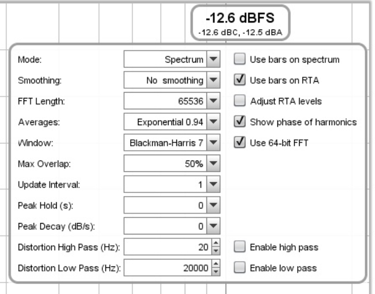

Tom Christiansen suggested that the circuit be tested under load connected to a low distortion amplifier. I acquired one of his Modulus 86 amplifiers that is capable of 40W out into an 8 ohm load. My test setup uses an Akitita low distortion 1 KHz oscillator as a signal source and a first generation Focusrite 6i6 connected to the amplifier via a 10:1 attenuator. Using REW to measure the apparent distortion. I first tested it without the SSR protection circuit and adjusted the input to drive the output to just above 18VRMS into 8 ohms.
The first plot shows the results. There are no apparent distortion products above the noise of the test setup.

Very nice work Jan. Can you click the THD analysis button so that we get the inset window showing % HD from various components up to H9?
Most should be able to look at the data points at 2k, 3k, 4k ... and see that there are no harmonics sticking up above the noise floor of the measurement. What you'd get from clicking the THD button is the THD+N. I suggest pondering the internal validity of such experiment. 😉
Ahh... Life in the precision lab. Your instruments may lie to you.
Tom
I think with some settings changes, the thick grass at the baseline could be reduced and perhaps a glimmer of some sort of peaks at 2k, 3k would show. The peak from the Akitika might be observable. I am not sure why the grass on mine is not as tall?

Do you use more averages?
Tom
My settings appear to be the same as jhofland’s as shown on his plot. I am using ASIO driver and 96kHz data rate. The data rate may be 2x higher than default 48kHz.
