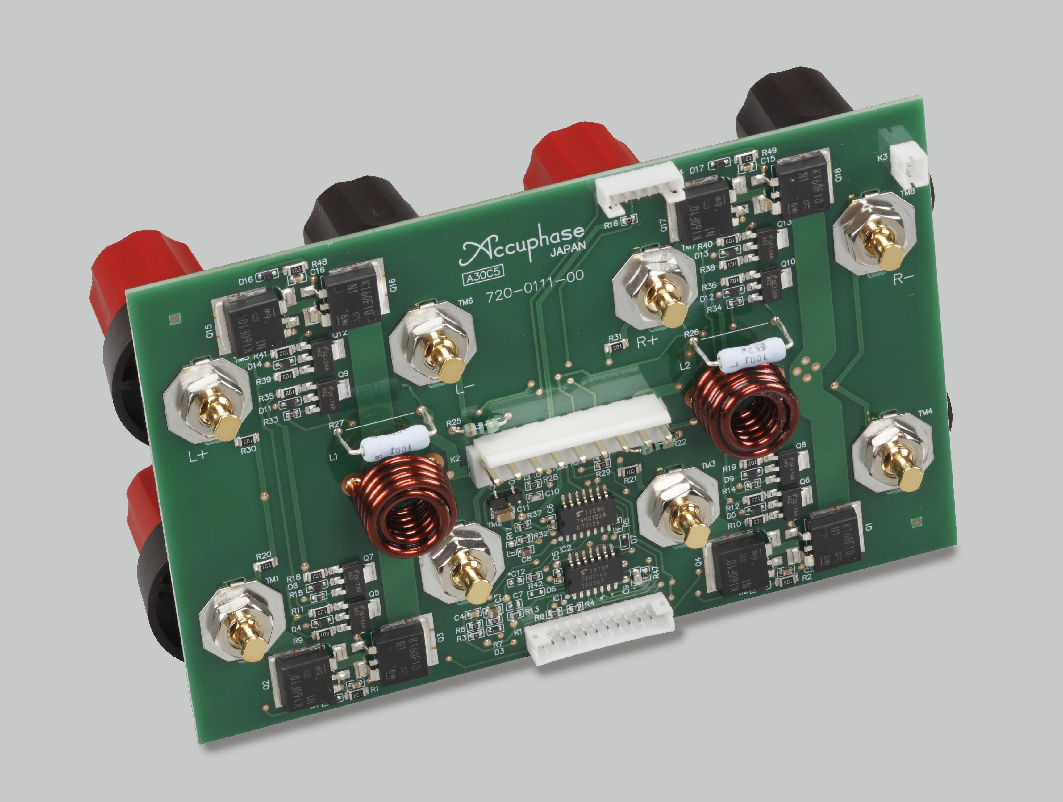

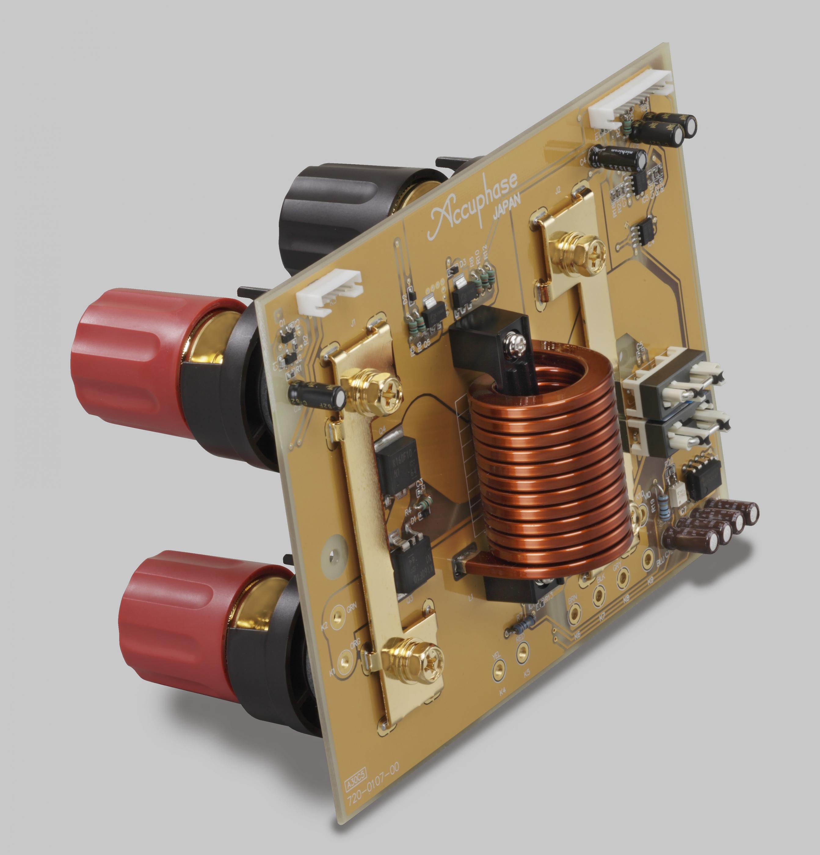

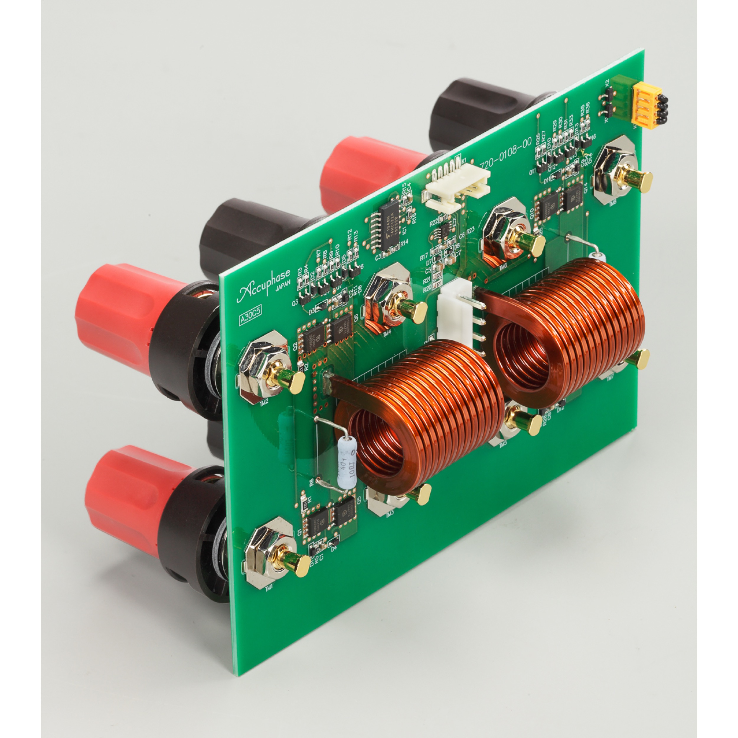

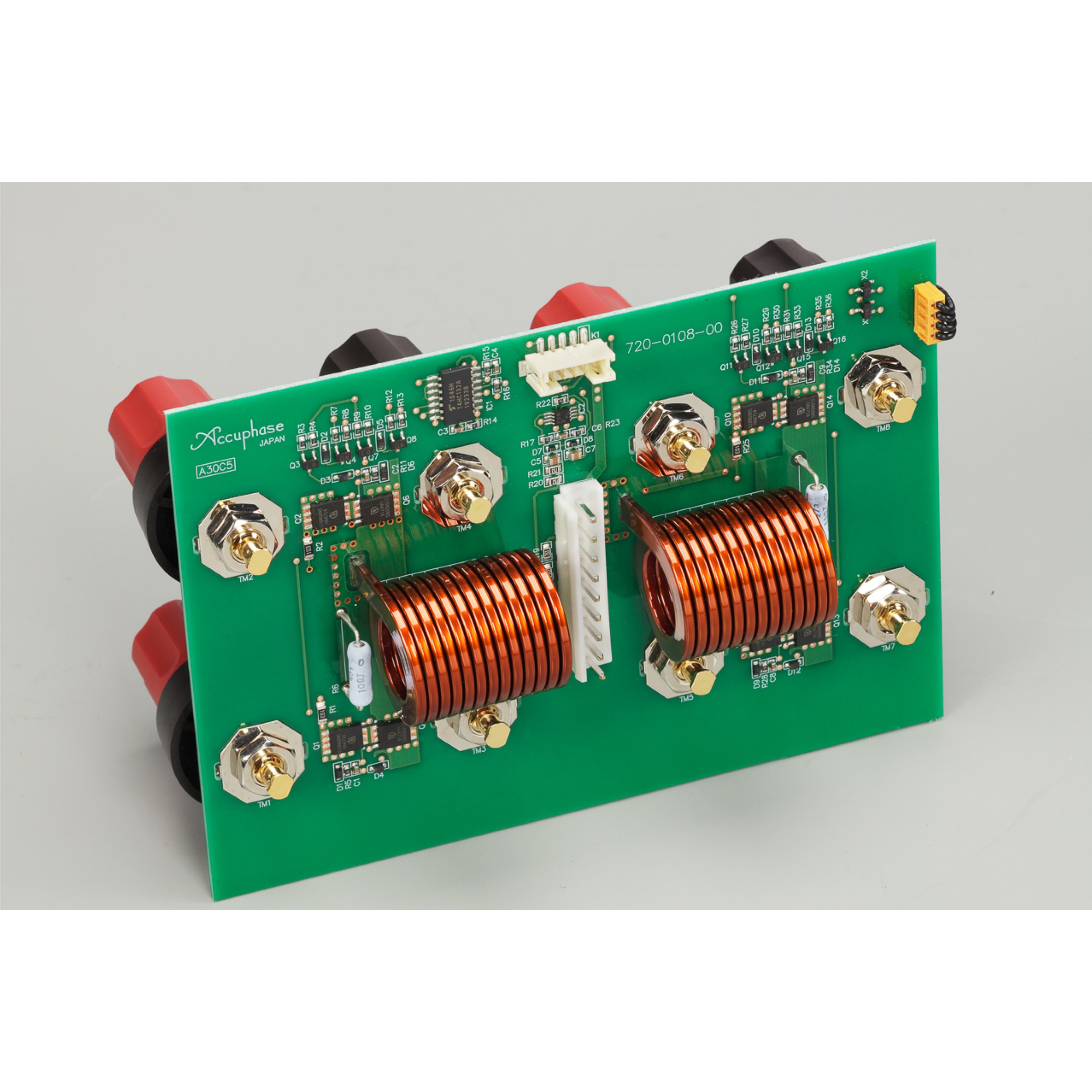

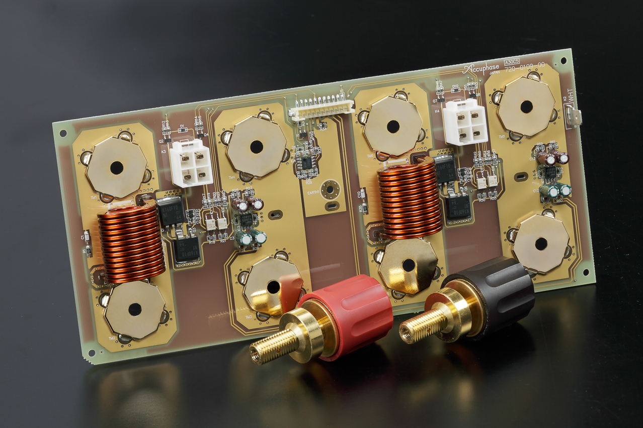

What do you think about this beautiy is this have same logic?
Those look very nice - possibly similar topology. Looks like dual comparators - closer to the HPA SSR protection circuit that I have above.
After a little bit more investigation Accuphase using mosfets (k160f10) for speaker protection and as mentioned here below they have significant advantages over solid state relays.
ESP - MOSFET Solid State Relays
I also check high end yamaha amplifiers they also use mosfets.

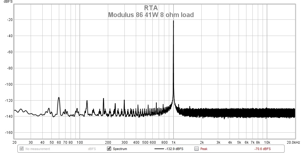

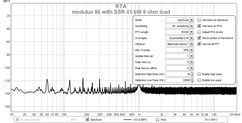

SSR protection circuit testing
Tom Christiansen suggested that the circuit be tested under load connected to a low distortion amplifier. I acquired one of his Modulus 86 amplifiers that is capable of 40W out into an 8 ohm load. My test setup uses an Akitita low distortion 1 KHz oscillator as a signal source and a first generation Focusrite 6i6 connected to the amplifier via a 10:1 attenuator. Using REW to measure the apparent distortion. I first tested it without the SSR protection circuit and adjusted the input to drive the output to just above 18VRMS into 8 ohms.
The first plot shows the results. There are no apparent distortion products above the noise of the test setup.
I then added the SSR protection circuit between the amp output and the load and repeated the measurement without making any adjustments to the Focusrite input. The second plot shows the results. The banner showing the REW setup happens to override the 1KHz peak of the plot, but the harmonics, or lack thereof, are apparent. There is no discernible difference in the output harmonic content with or without the speaker protection circuit in place.
