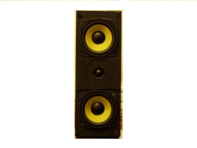

carlosfm said:jaudio, what 'power hungry' speakers do you have now?
This are the first speaker that I have built and the only one that I kept(for stereo listining). The speaker have 4" woofers,dome tweeter in the front and cone tweeter in the back. In the listening position the speaker is about 83db and averaging 4ohm or less. The room is 10' high x 15 x 12.
Well anyway,I will have new speakers soon and go with Walter Jung preamp with Carlos' lm3886 power amp

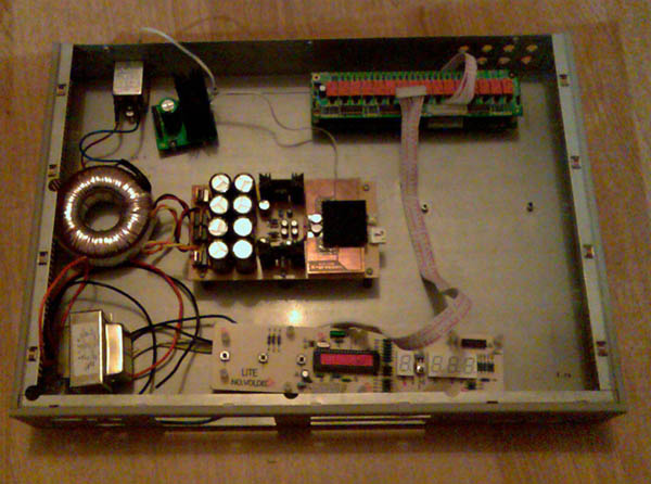

This is as far as intergrating my preamp together with its remote voule control has gone. Waiting to get some spare time and a wooden front panel for the gutted router unit my Dad is making for me.
Just wondering how i should go about the grounding scheme in this unit? Any ideas?
Have a star ground for input and output sockets and also the input and output from the ad815 board. Should this all then be tied to the safety ground or not?
Sorry basic question but just thinking out loud.
Phil

Been playing around with the grounding of the pre and trying it on various positions. Now I know this is old tricks but I am just going down the road that millions did before me. And sometimes even the old folk need to be reminded of this
1-get the ground reference to star ground as close to the signal ground as possible - more clarity
2-if possible split power gnd and the signal gnd to star gnd
this way I got more clarity from the preamp
For the guys with Ref-C and the X-calibre. Remove the 1R resistor that connects the signal gnd to power gnd. connect a wire at the input gnd and take that down to star gnd. you cans still use the 1R if you want but it isn't required
