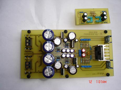

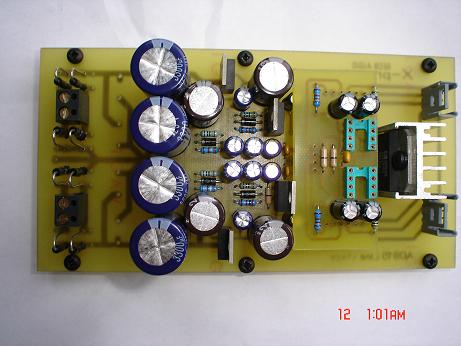

Just order the parts for my new intregrated dual mono block amp. I will use the Walter Jung preamp with four opa541 in the bridge parallel configuration. The opa541 will be set at unity and the preamp will have the total gain of 20x.
I want the use the opa541 because they are sample but will it be better to use four lm3886? All the components will be on a 6.5 x 5.5 inch veroboard,one for each channel or maybe I will put the power opamp on separate board and jump to preamp section.?
Any ideas?
Any ideas?
jaudio said:Just order the parts for my new intregrated dual mono block amp. I will use the Walter Jung preamp with four opa541 in the bridge parallel configuration. The opa541 will be set at unity and the preamp will have the total gain of 20x.
I want the use the opa541 because they are sample but will it be better to use four lm3886? All the components will be on a 6.5 x 5.5 inch veroboard,one for each channel or maybe I will put the power opamp on separate board and jump to preamp section.?![]()
Any ideas?
just need to understand why you want to run anything in bridge or parallel mode. you only do that if you need power. rather up the gain of you poweramp. rather build Carlos's LM3886 or my version of Mauro Penasa's design - X-Calibre.
After I finish the amp,I will give it away and it is better to have more power in that case. I would like to hear the quality of the sound.rudi said:
Because of the OPA541 bandwidth,it best to run at unity at least that what I believe.

the reason i ask is that the anything in parallel or bridged, normally sounds worse. alot less musical
jaudio, what 'power hungry' speakers do you have now?
Btw 20x gain on the AD815 preamp is definitely not a great idea, you are exceeding it's limits, even if you use a +/-18V PSU.
Remember, you have to count that it would have to amplify a 'standard' 2V line signal (from a CDP) and multiply it by 20x.

On Jung's schematics there is a gain of 5 for the ad831 and a gain of two for the AD815. I will incease the gain of the ad831(opa637) to 10,do you think that is a problem.carlosfm said:
