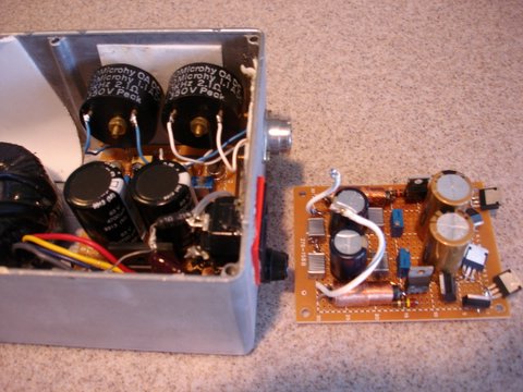

New PS for CFM AD815AY
Was thinking about how much Rudi liked this chip with dual regulated active power supply. Since my raw supply has been left alone for about three years it was time for a little updating.
Used dual 317HVH/337HVH three pin adjustable regs. Raw dc is right at +/- 30 volts dc. First stage dropping it down to 22 volts, then 15.2 volts at the board.
Then out through a pair of 10 mH chokes to the preamp. There is a total of 7K ufd in the preamp to termeinate the chokes.
So things learned in the last few years. No bypass caps per se. Output of last reg has a 47 ufd cap and 0.4 ohm resistor. The 4.7K first stage caps are snubbed with a 0.4 ohm resistor and 1.5 nf cap. There is a 0.1 ohm resistor buffering the ground between the preamp and the active circuitry.
George

Sound,
This shows my old board, single stage of active regulation feeding a two stage LC filter. New one is two stage active fedding a single passive.
The sound is definately better with the new board. Sound is more rounded, less electronic. I never pay attention to imaging, so dynamics, spectral balance, and warmth are the factors judged from.
Could be dual regs are better. My previous experiance with them was not good, but this was using them without a choke on the outpu. Also had bypassed caps inbetween and on output.
May just be better implimentation of the parts. Either way, this is really getting there now. Time to work over my sources again.
Thanks to all who throw out ideas on how to build better audio!
George
