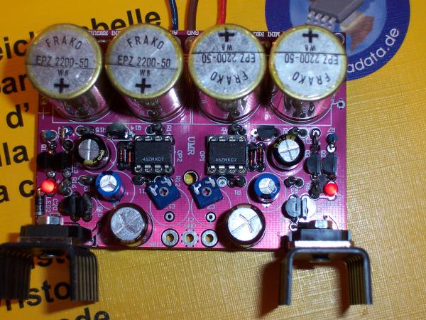

carlosfm said:
Huh... try it.
I'm out of time to test brands of caps on the snubber:clown:
I don't have anything nasty on my parts box, I'm very picky when buying caps.
No need to spend a fortune, Philips/BC 037 does it for me.
No green Lelon caps, please. :devily:
Did you like the Frako Caps ? 😎
Now I am using Frako, Siemens, Philips, Daewoo, Rubycon, G-luxon and JD(cheap).
I also have a pair of Blue Lelon.... didn't tried yet!
Buf if they are like the NA caps.... it's rubbish :dead:
I have some around, I used some of them on a super-reg, but I can't say for sure if they are good or not.
They remind me Roederstein caps (which are IMO very good), and I like their "retro" look & feel. 😎
