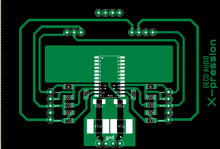

Hello, just wanted to ask just how hot the SMD AD815 is getting for the ones that has build with it?
I've a layout on eagle that is 2x2 inches with the "heatsink" layer on both sides (2 layer board connected with many vias) and the "heatsink" takes up about 75% of that.
Would that be enough you think?
Tobias, the SMD version gets quite warm, but as long as you provide some "heatsinking" (your plan is fine), no problem.
Hey, my pre is working for almost two years, and sometimes it's powered on for days.
The non-SMD chip doesn't even get warm, I suspect that it's metal tab is enough heatsinking. 😀
hi Tobias
I have build a few SMD versions now and the one thing that i have learned from this is that you have to have the heatsink pad 90deg from the heat tabs. if you sart them of at an angle they aren't as effective. it runs 30 % cooler this way.
be warned it does get very hot but after some running in it settles but the heat it generates is far below the max specification of the chip
look at my example. you can make the pad bigger than this. another idea i haven't tried yet, but i am sure it will work. is to solder some think copper to the heat tabs.
hello Carlos and Rudi
okey, i see in your picture Rudi that i have bigger heat-plane so it should work.
It's somethink like this with the psu-pcb ontop of the other and the pins on the elcos after the regs are going straight thru down to the AD815.
http://www.ettnet.se/~tobias/diy/ad815/smd/
Edit: Oh, and yes I got some ideas from your board Rudi 🙂 kinda hard also to do it in another way with this chip.
