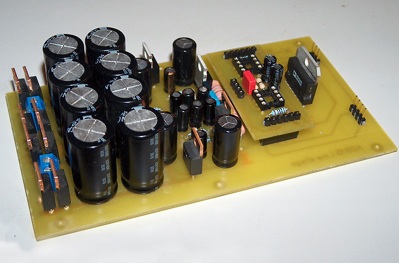

Well it didn't cross my mind (although I generally do it) I like to hear a circuit in its natural form before i tinker with it. It will be very easy with a 3k3 resistor.
I am almost finished with the new board. i just need 2x 100R resistors and then i can test it. (I could have sworn that it was on my shopping list)
here is the picture of the new pre. fingers crossed that i didn't mess it up in the design stage

jaudio said:Hey Rudi
As usual your board looks great.
It is the Walter Jung circuit with no changes?
thanks,
it is the Walt Jung circuit. but you can use my normal DC servo aswell with limited changes. I left out L1. but that i will have on my next board. this board does have a few problems that i picked up once i gone through it again but it can easily be fixed. so hopefully i will have it working tomorrow

Walt Jung Composite line stage circuit
Well I have the pre running and obviously we will have to give it some time to settle.
First the basic configuration.
18-0-18 transformer.
Dual regulation. Voltages being 25v – 21v - 15v
First stage – OPA627 x2
Well the sound is very much down to opamp selection. With the OPA627 one get the impression that you are listening to a 6h30 valve line stage, meaning that it is very sweet in the midrange and tops but in this instance you have AWESOME bass. Obviously you also have the current drive of the valve.
I think it might be the power supply but the preamp is quieter than before and the definition shows a lot of promise (I say this because it really needs lots of burning in) but that said. What I heard is very good.
I will have to build another with the dc servo to do a direct comparison. But I think the AD815 on its own might be a more “edgy” meaning that it has sharper definition/ one thing is for sure. You need a amp with a cap on its input. I am measuring 1mv with nothing connected but I will check it again when all is connected
