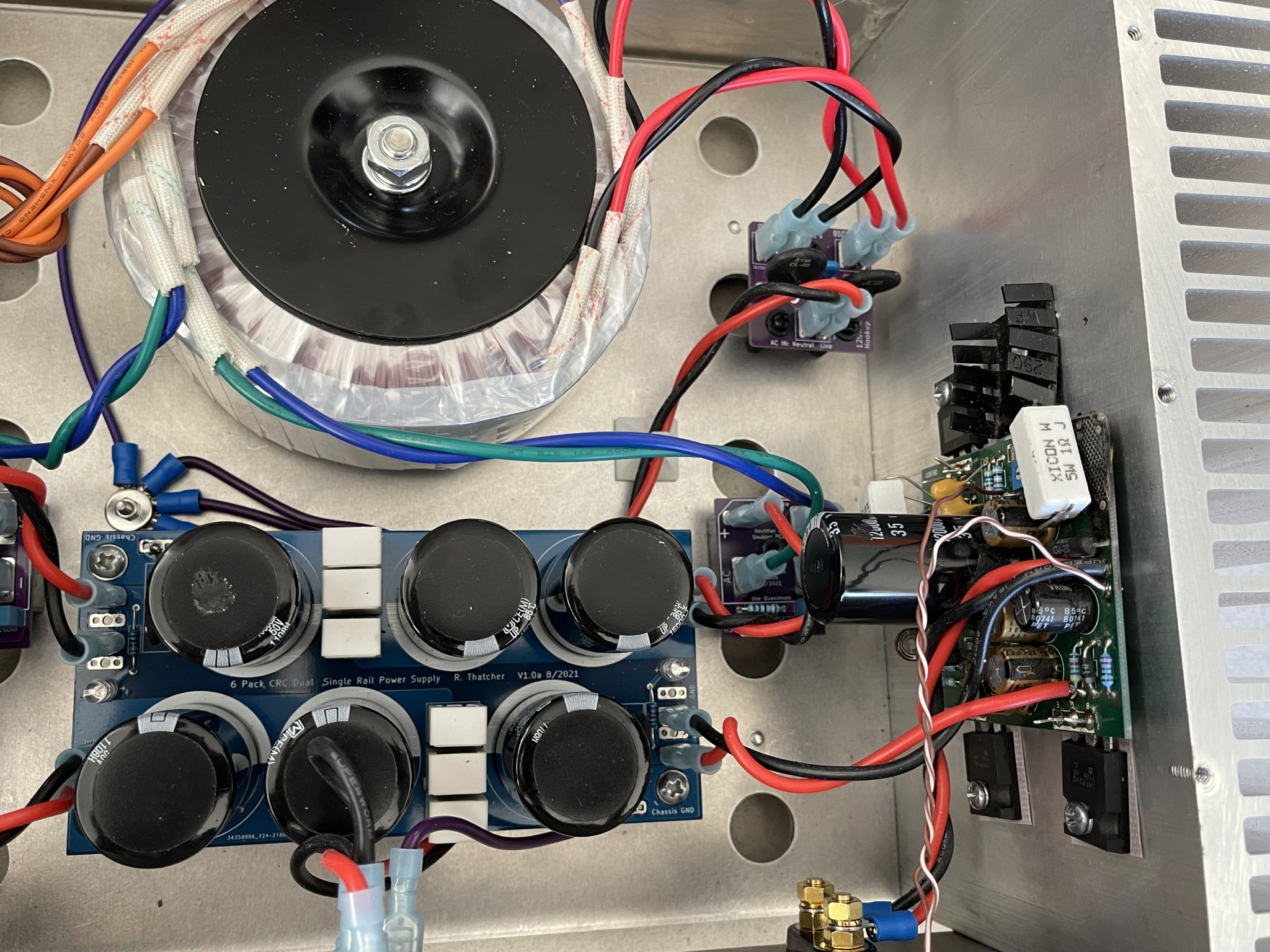

Each one of these are so fascinating and oddly satisfying to see them fixed. What's different on this one is that the RED/BLACK from the PSU are actually V+/- rails and the GND is passing through (lifted) 3R 3W resistors via grey wire. I bet this thing suffered from some pretty bad hum, even worse than what you might be experiencing currently. Just make sure you double and triple check your connections when you replace the PSU board.
I just also noticed the resistor across the input rcas. If these are 'true' aleph boards, see if there is an input- on the board. If there is, it should be jumpered to input GND.
Why do you still have hum? I'm sure the power wiring is contributing to a degree but probably not the only cause. If you get the PSU board out, I'm sure everyone would like to see the bottom. The creator had a habit of scratching together PSUs from self etched copperclad boards.

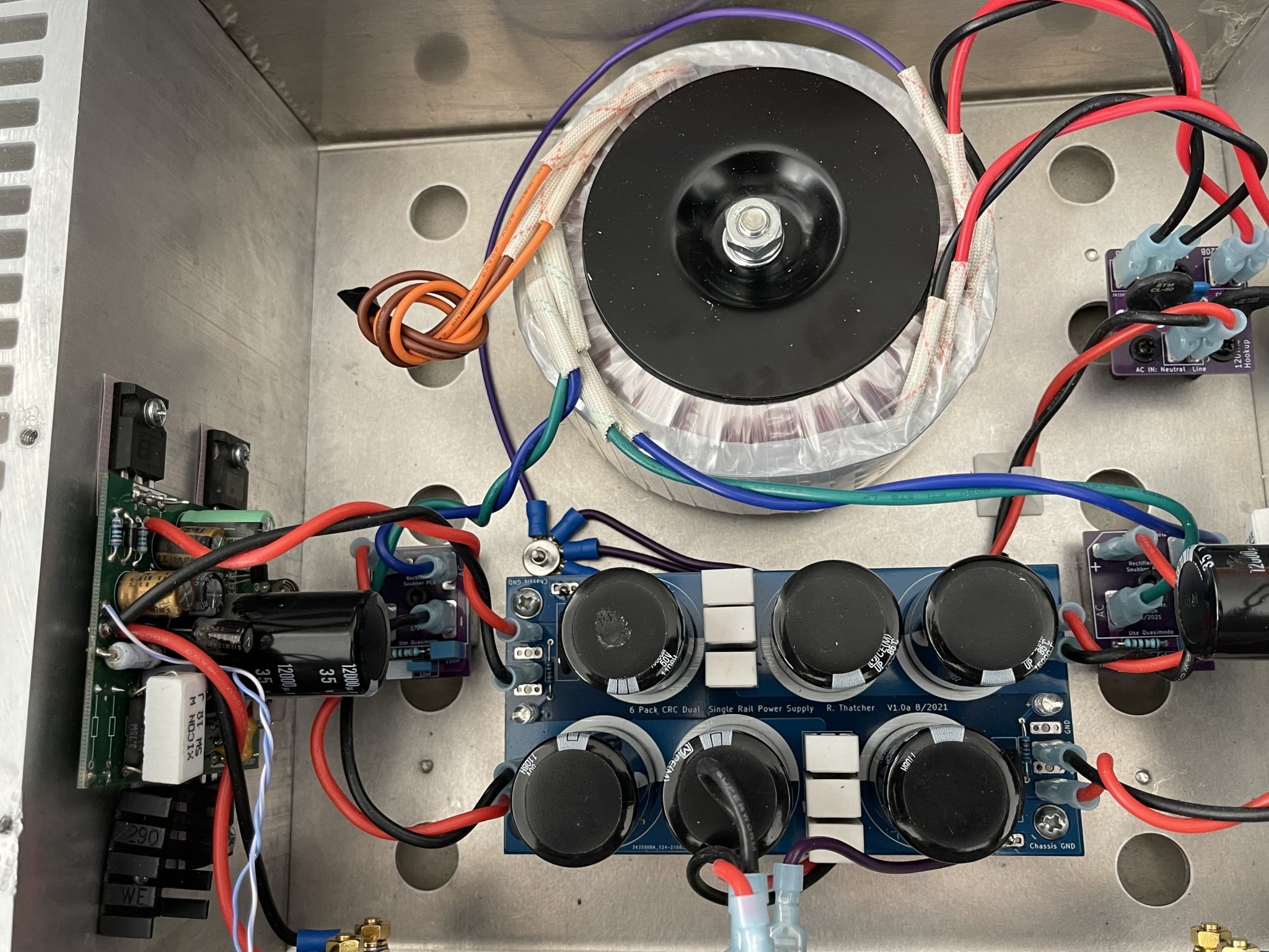

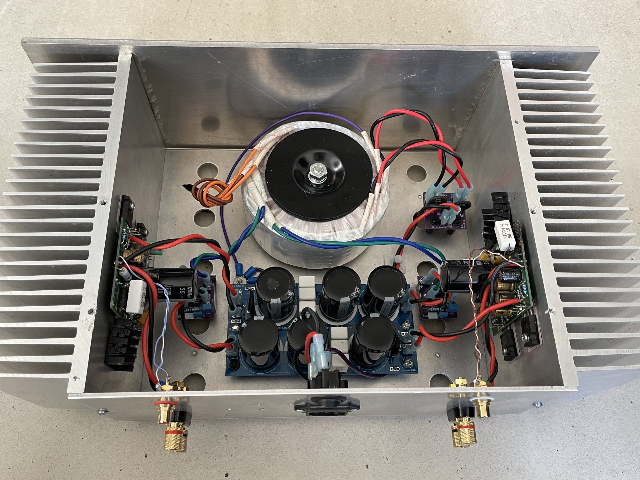

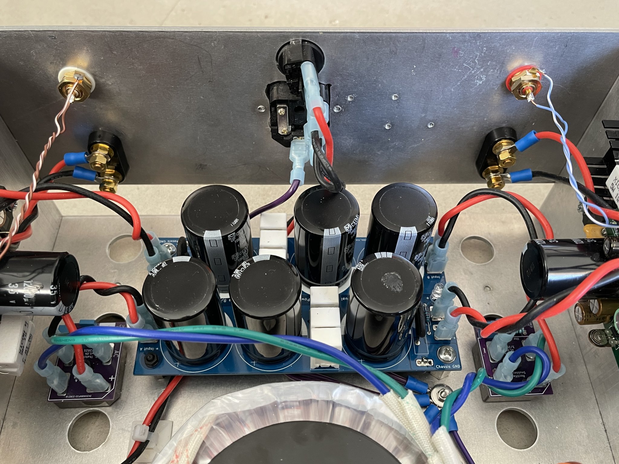

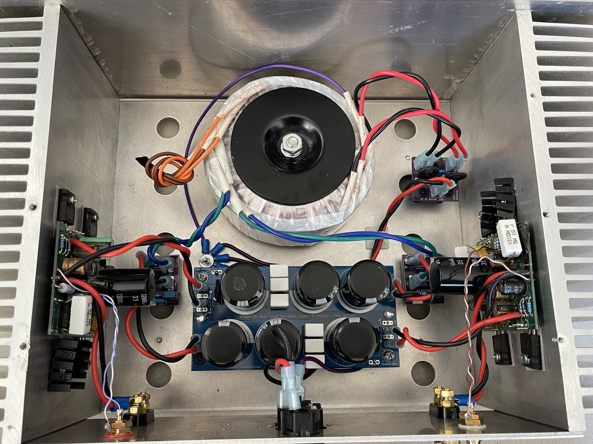

The update took a bit longer than expected but I'm now enjoying Papa's F3. The right channel was fine once I made the updates and resoldered all the connections. The amp gets warm and now runs like a First Watt amplifier as opposed to burning your fingers, if you touched it.Adding another one to the list- an F3.
Notes when opening it up-
-No signal on the right channel.
-No CL-60 but a strange resistor set up to lower input voltage?
-No grounding, of course.
-54v from the power supply seems a bit too high.
The plastic spacers for the right channel RCA jack were either missing or melted and the input shorted. I replaced the jack, mounted it correctly and both channels worked.
I noticed that the back panel holding the resistor bundle got really hot, almost immediately. That bundle is right next to the right RCA jack. Hmm...that does not inspire confidence in playing the amp as it is. It looks like I'm off to the parts bin for a rummage and a call to rthatcher for advice and some new parts.
Next steps:
- Replace the power supply board with a new board, 63V caps, CL-60's and proper grounding.
- Replace the doughnut with an 36V one, giving me 43V at the amplifier boards.
- Remove the resistor bundle on the back panel.
I removed the resistor set up attached to the back panel, which had turned the amp into a toaster.
Bought a new transformer with the correct voltage.
Added a power supply board from Rthatcher, made to fit a small chassis. (The key to making this all work)
Added a star ground.
Replaced the cheesy speaker terminals.
Keratherm pads underneath all the Fets.
And plenty of CL-60s on the small board connecting the 120V in and also on the power supply board.
A big Thank You to Papa and Randy!
