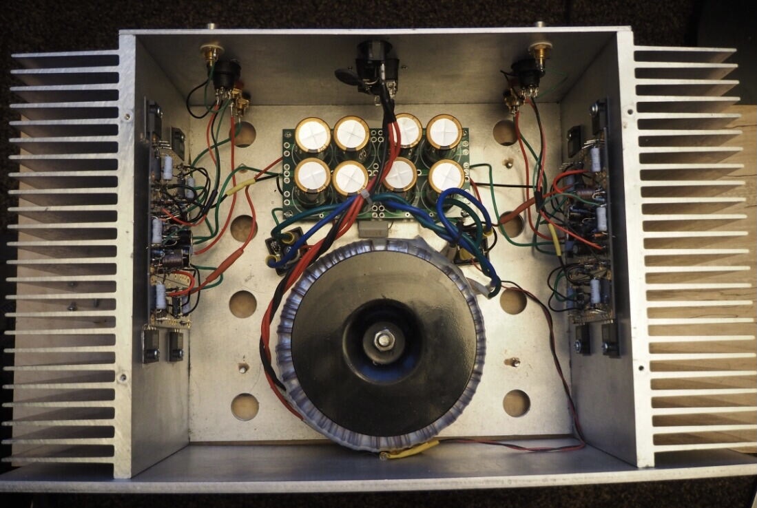

Back on topic. I have been corresponding privately with @Goggle1824 and I want to share some of the key points on that amp.

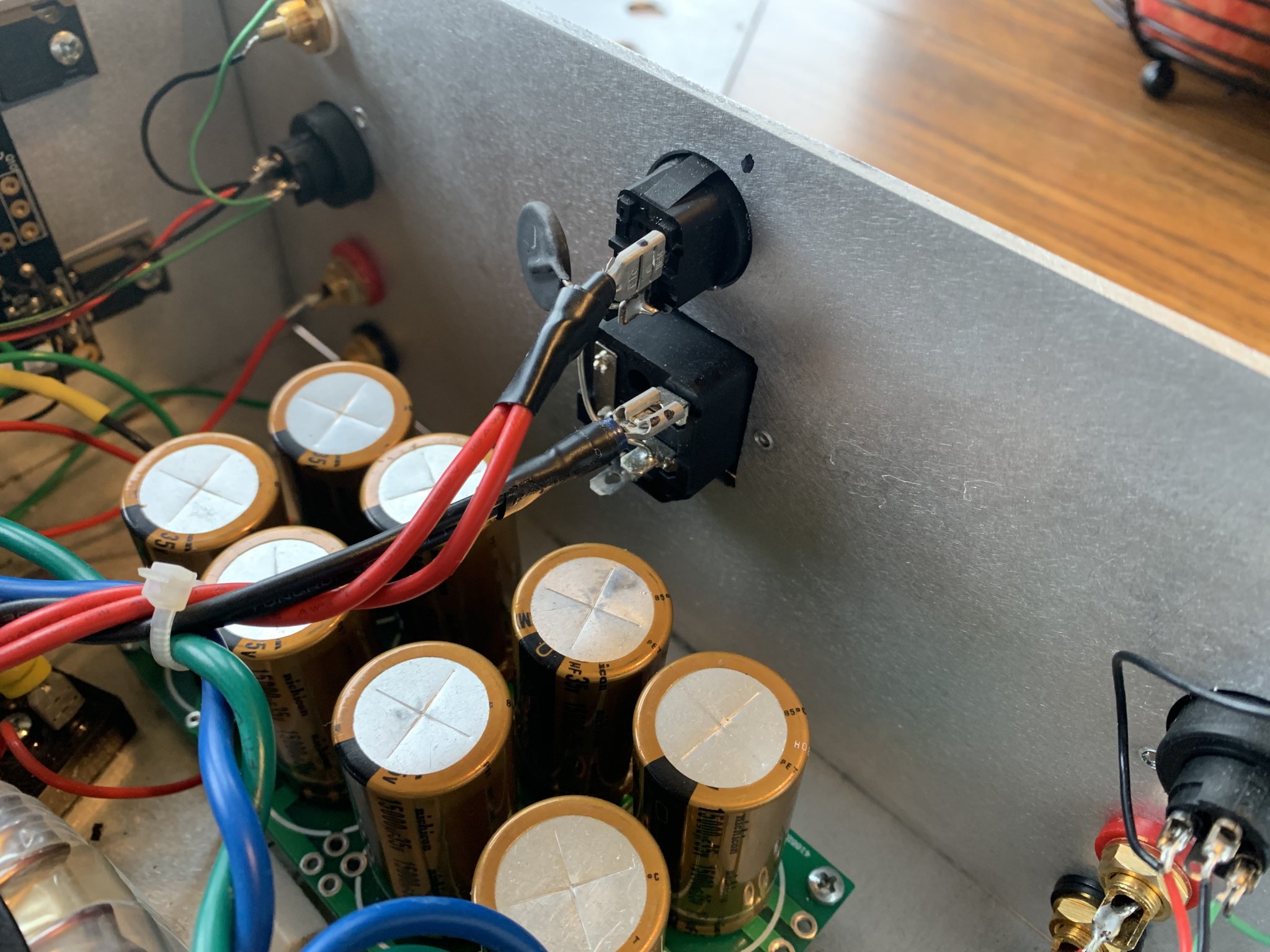

As far as I can tell, I think his amp is the first known case of the ground wire connecting from IEC Earth to chassis!!!
The amp uses DIYAudio store PCB's, dual donuts, and Gianluca's heatsinks. It is perhaps the nicest Rawson build I have seen to date.
The fuse in the unit was a 10A fast blow (default fuse that ships with some of the inexpensive IEC's). He will be installing proper fuses and then powering up.

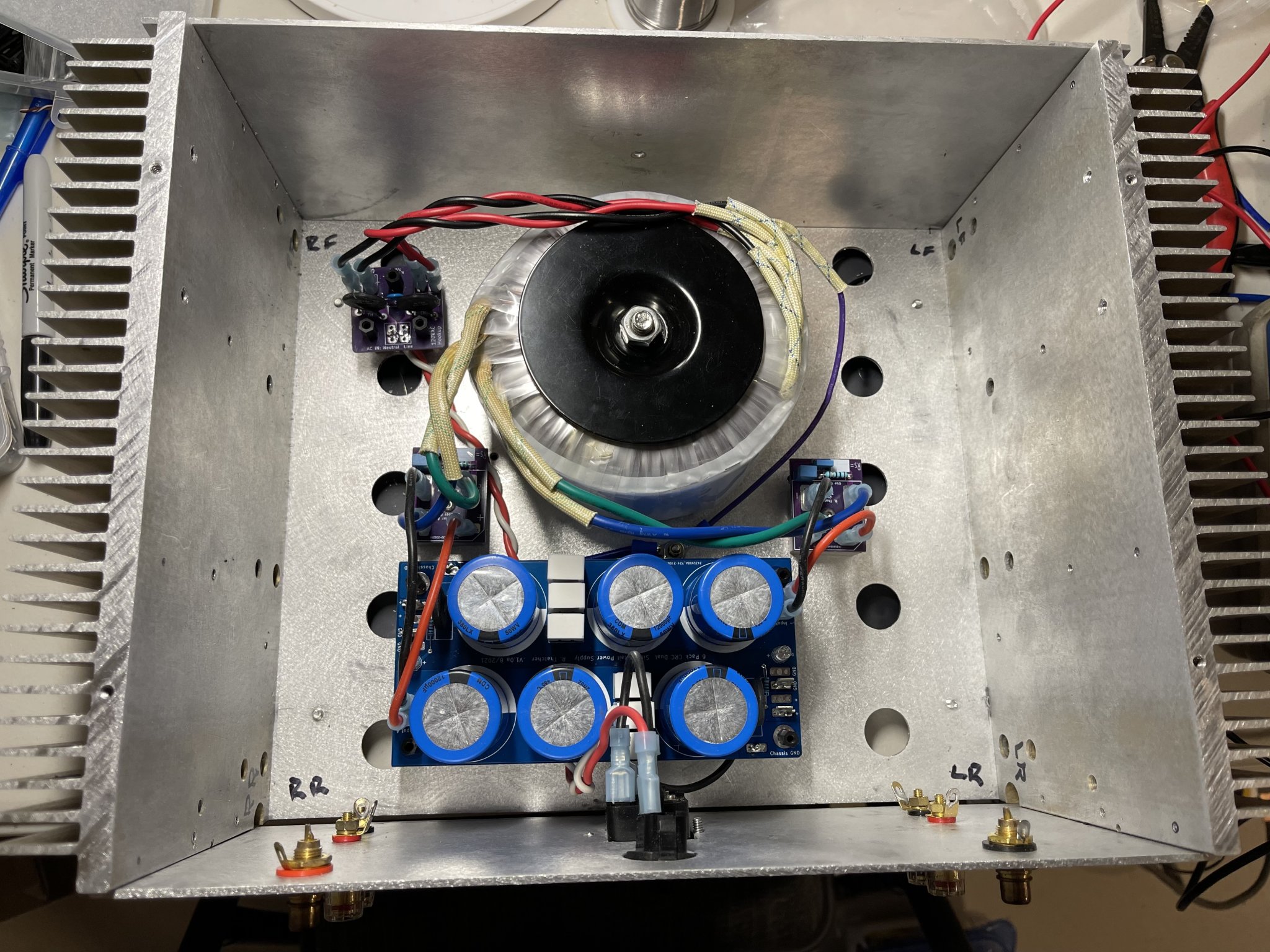

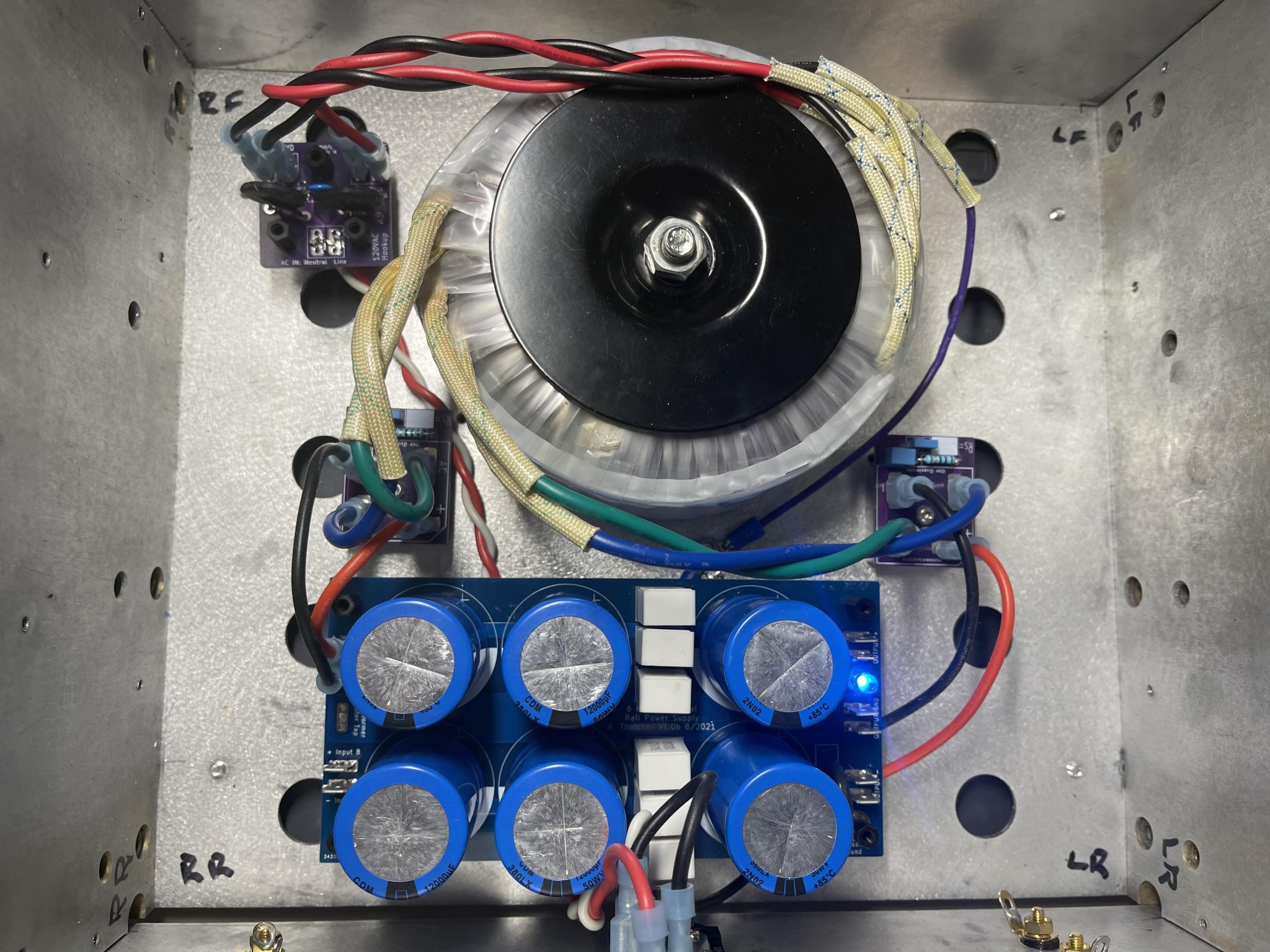

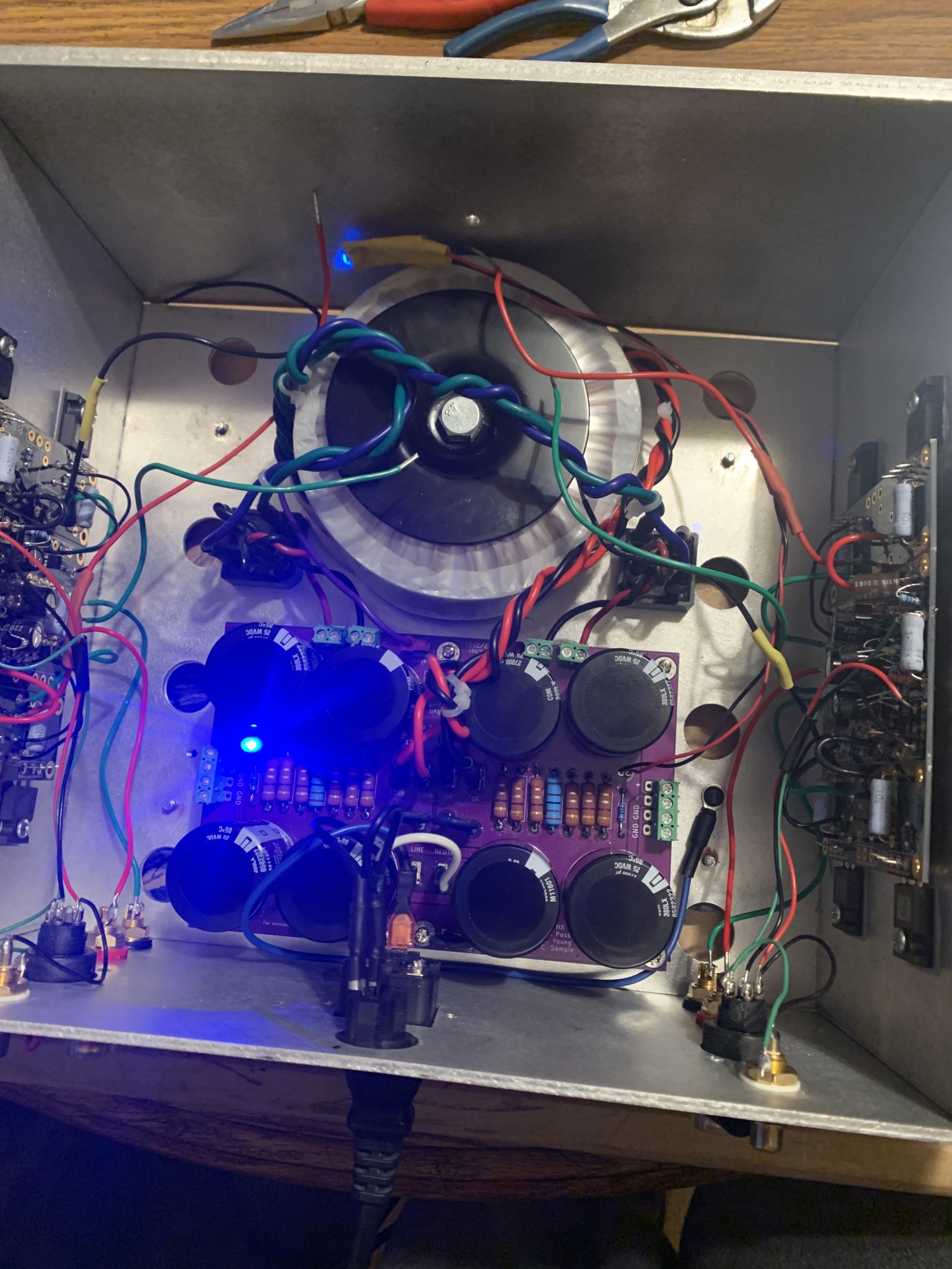

I dug the out chassis that held the non-working F5 from storage. I de-soldered the power supply caps from the home made PCB, checked them, and soldered them to one of Randy's small PS boards. I reinstalled the transformer with new diode bridges. I tried to use as much of the original amp as I could.
Using Randy's power connection PCB with CL-60's and a star ground make setting up the amp much easier and much safer. 24.5V at the PS board.

Will, that looks like the 2x single rail PCB for use in amps like F3. It’s a single rail for each channel. Let me know if you need a dual rail PCB on a similar footprint. CCRC setup with star ground, CL60, and compact footprint for the rawson chassis.

Thank you, Randy. I do have a dual rail board. I'll swap them out. Sharp eyes.

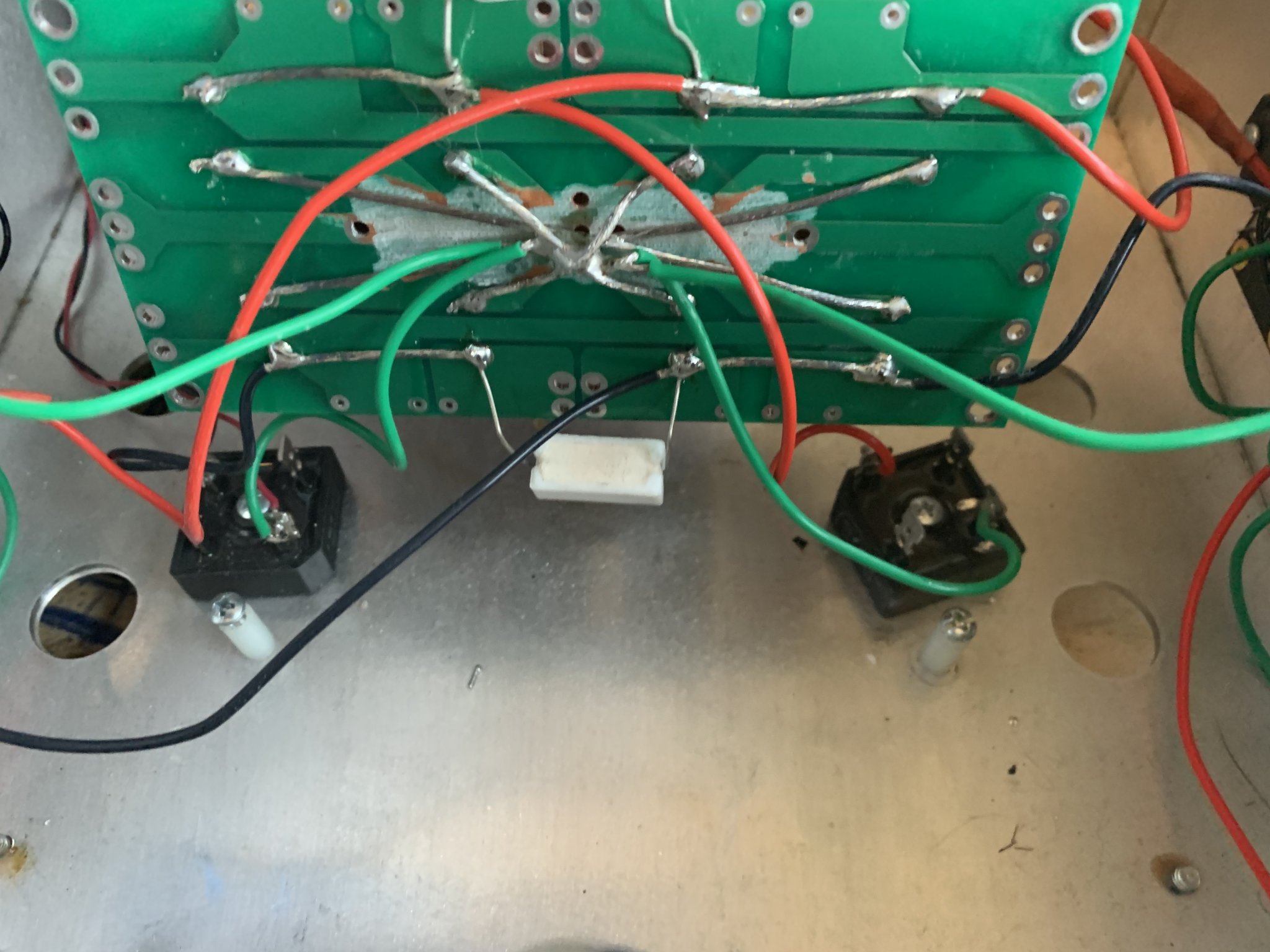

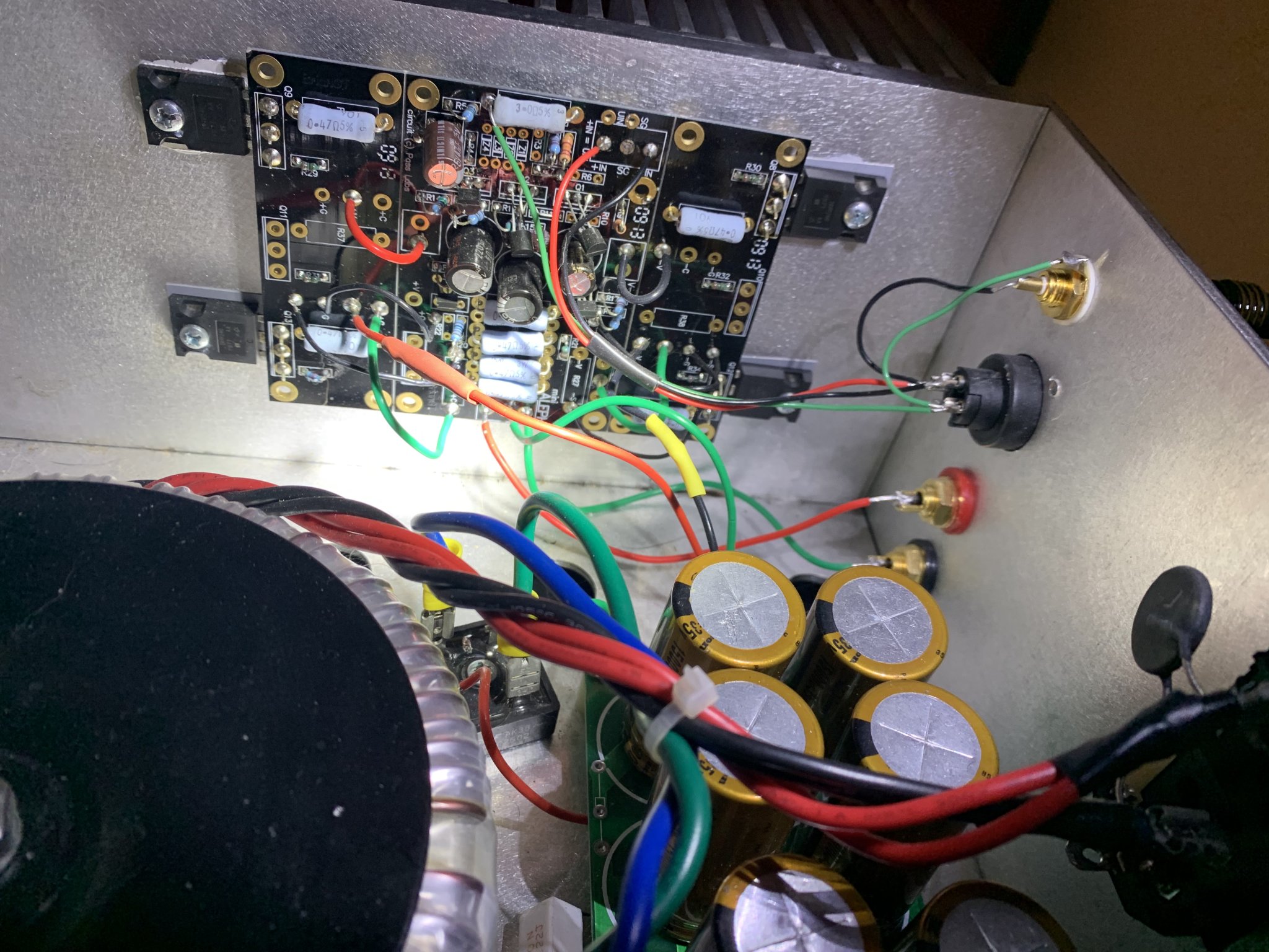

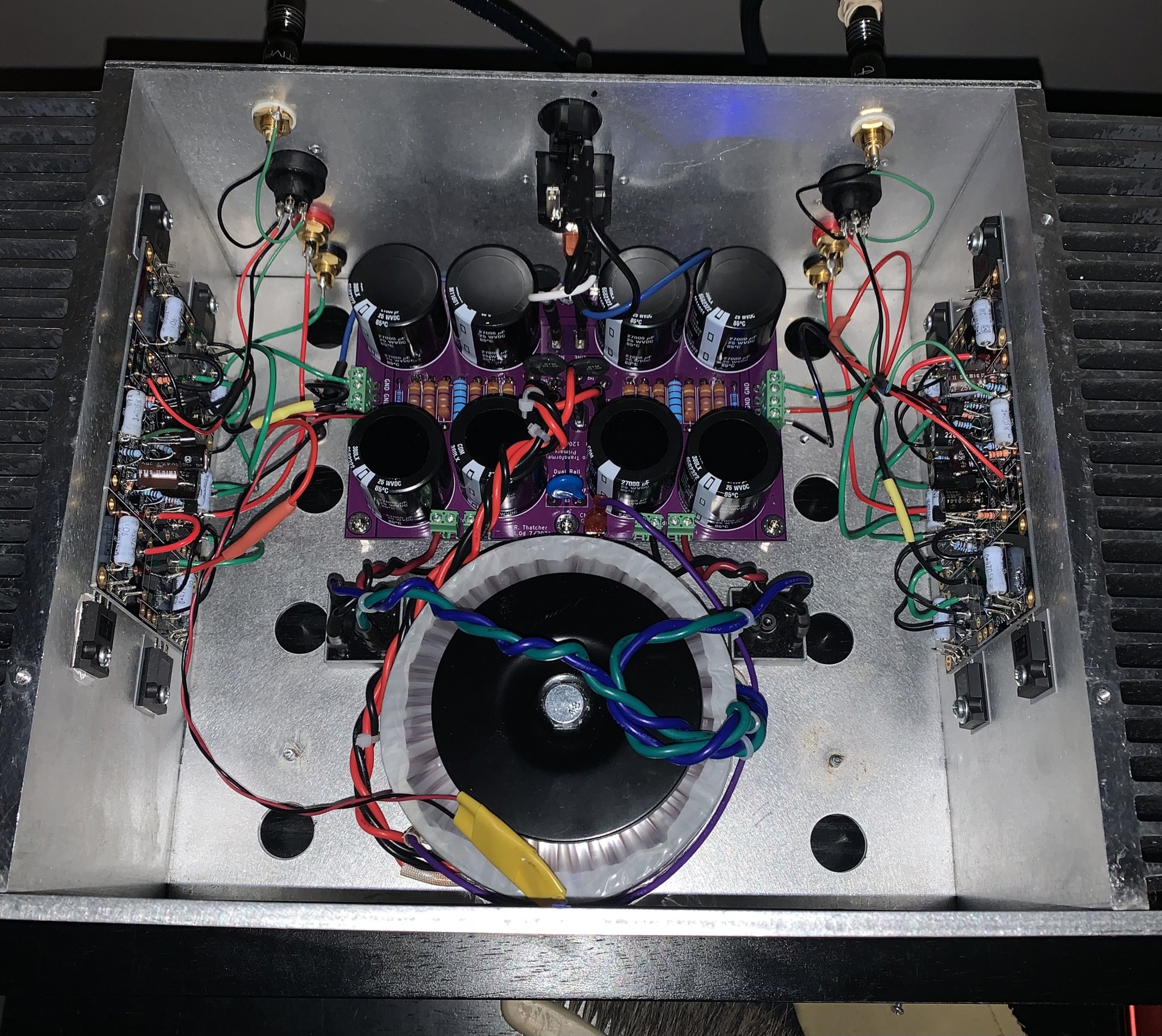

I got this Rawson built Aleph J mini last month for cheap. I put it in my 2 channel system and both channel had a loud hum and noise. Really Loud pop when I turned on and off. Took out of my system and had a look inside.
Took the transformer off it was a 500VA with 20 volt secondaries, then looked at the PS board,
Number one problem is a safety issue. The safety ground at the AC IEC socket does not appear to be connected to the chassis.

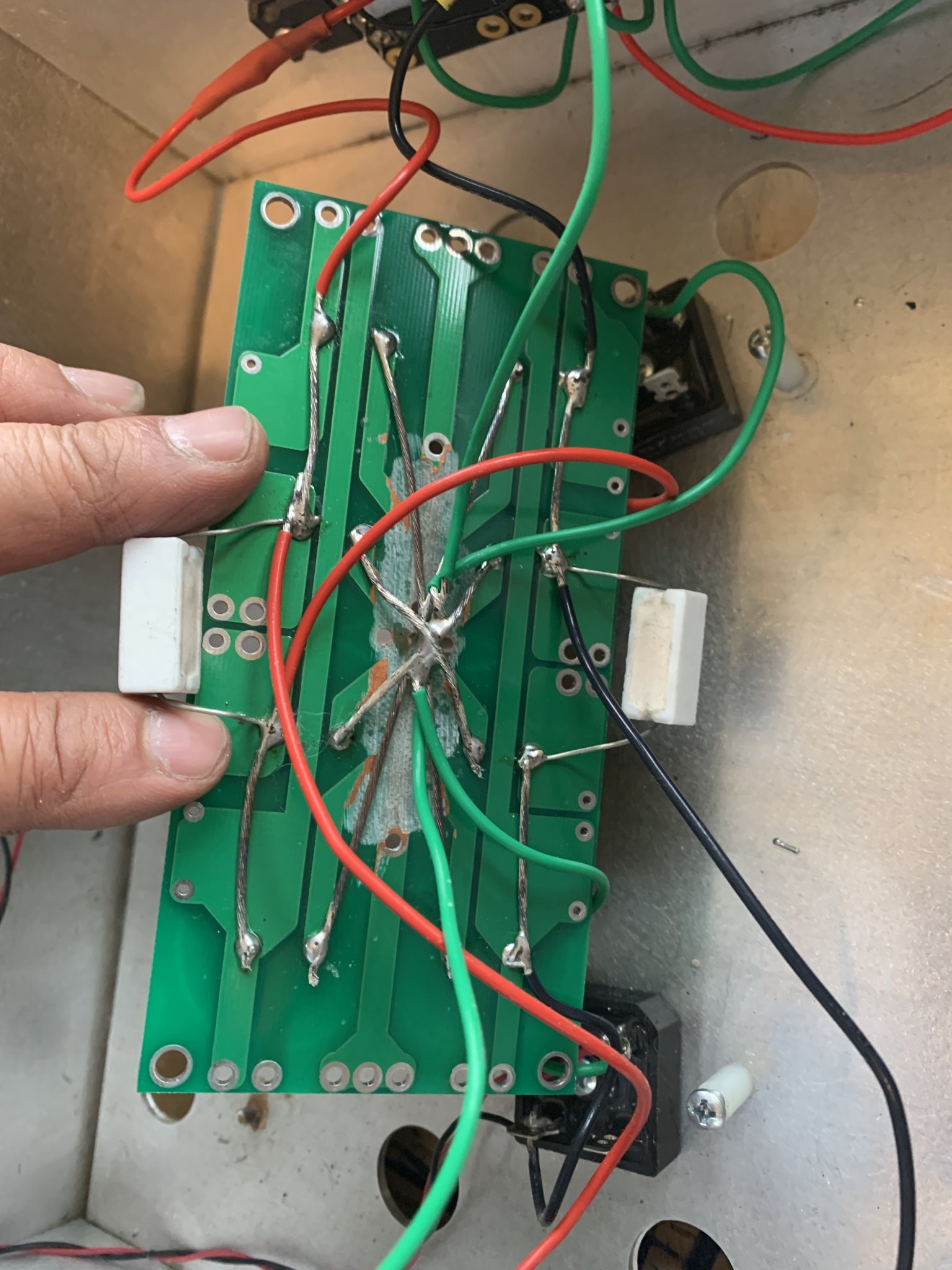

The power supply board has a "star ground". Star grounds are highly misunderstood. It should not be used in the power supply board. The "ground" from the bridge rectifiers should enter the PS board at the same capacitors as the V+ and V- from the bridge rectifiers. The ground conductor should then progressively travel from capacitor to capacitor on the way to the last capacitors. The PS ground connection to amplifier boards should connect to the last capacitors at the end of the PS board, at the PS V+ and V- outputs.
Wires should be twisted. V+ V- Gnd from PS board to each amplifier board should be twisted. V+ and V- from rectifiers to PS board should be twisted. Speaker + and - from amplifier board to speaker out connectors should be twisted. AC wires should be twisted. Input signal + and - should be twisted.

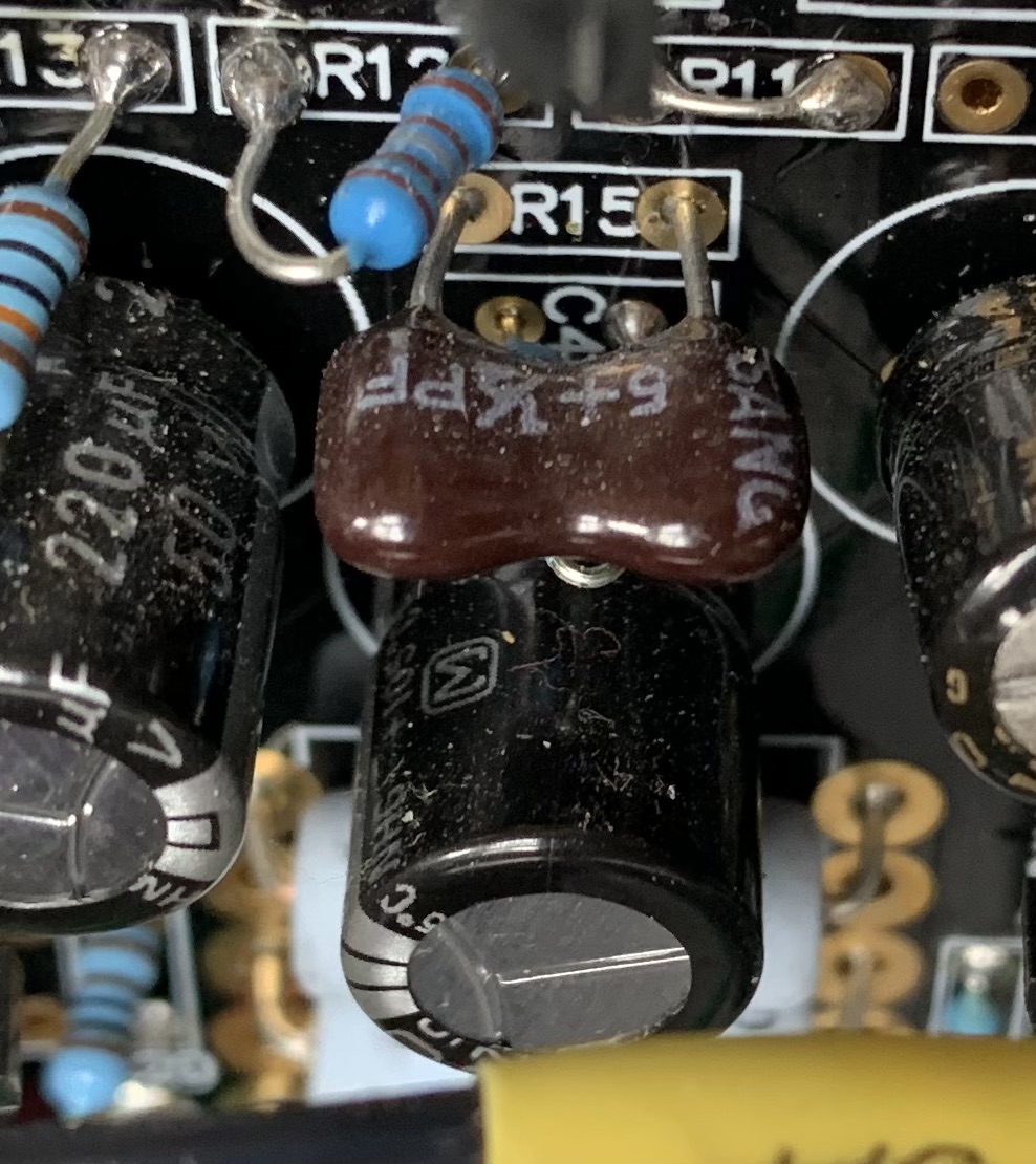

I reached out to Randy and got his PS board and swapped out the donut with a 200VA one with 15 volt secondaries. And replaced the PS. The amp was running really hot and could not leave my hand on it for few seconds. Already had most of the components for the power supply. Randy helped me find a couple of mistake I had in which I blew a couple of fuses and 2 rectifiers. Once I tested the power supply hooked up the amps and the right channel still was humming and had was making static pops sounds. Randy suggested it might be cold solder joint somewhere on the right board and suggest I use a nonconducting rod to push on the wires and components while pug in and using a crappy speaker to find the joint and he was right I found a capcitor that would make noise and pop when I gave it a little push. This is the little bugger on the board. Not a lot of solder on the top.
Also thought it strange that the capacitor is on a resister location. Once I resoldered it, the noise was gone and the amp was making music.

I agree, lots of work to sand off the board and then trying to hold wires in place for soldering the star ground.Seems like it would’ve taken him more work/time to do a crap job like that. Should be easy enough to sort out though.
It looks like the original PS board had traces for a "star ground" already. The wired version was electrically no different than the pcb trace version, and both would have hummed. The "dirty" ground from the rectifier outputs, ripple from the capacitor filtering, and "clean" ground from the "clean" PS output all connected together at one location is not a good thing.

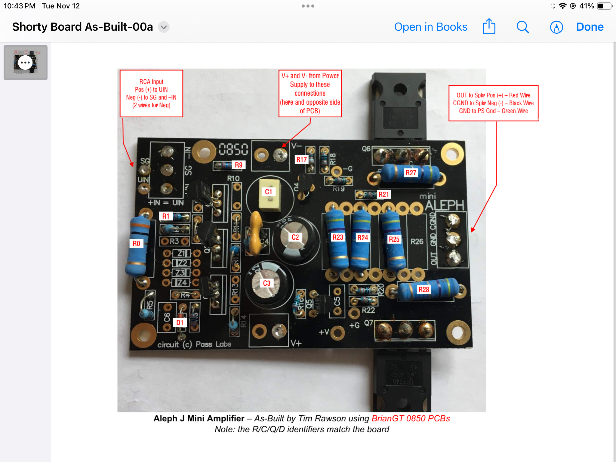

I am not too familiar with this board and it looks like C4 and R15 switch position on my amp board.
Here is a picture of another board with the R15 and C4
