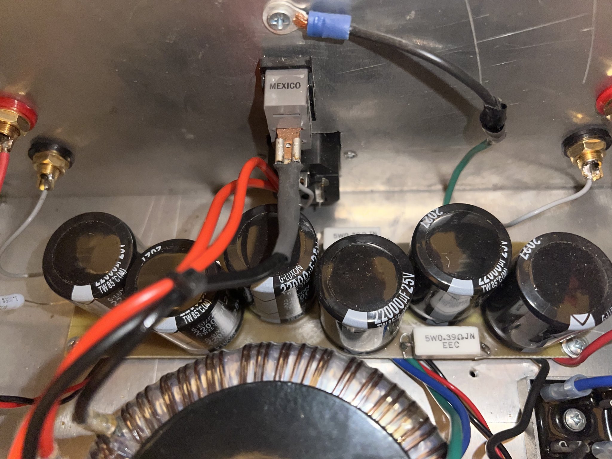

Hi all, I'm looking for some troubleshooting advice. I've got a Rawson build Mini Aleph. It's worked okay in the past, but I just pulled it out after maybe a year of storage and it has big 60 or 120 Hz hum. Where should I start to address this?

I didn't want to presume, but thanks - I'm attaching some photos. And I bought it ignorant of the history of the builder. I set it aside when I got more info about the builds, and have been using my ACA Minis. I'd like to get some info so I can decide either to fix it or get rid of it.
Thanks in advance- for the help and for not burning me at the stake.

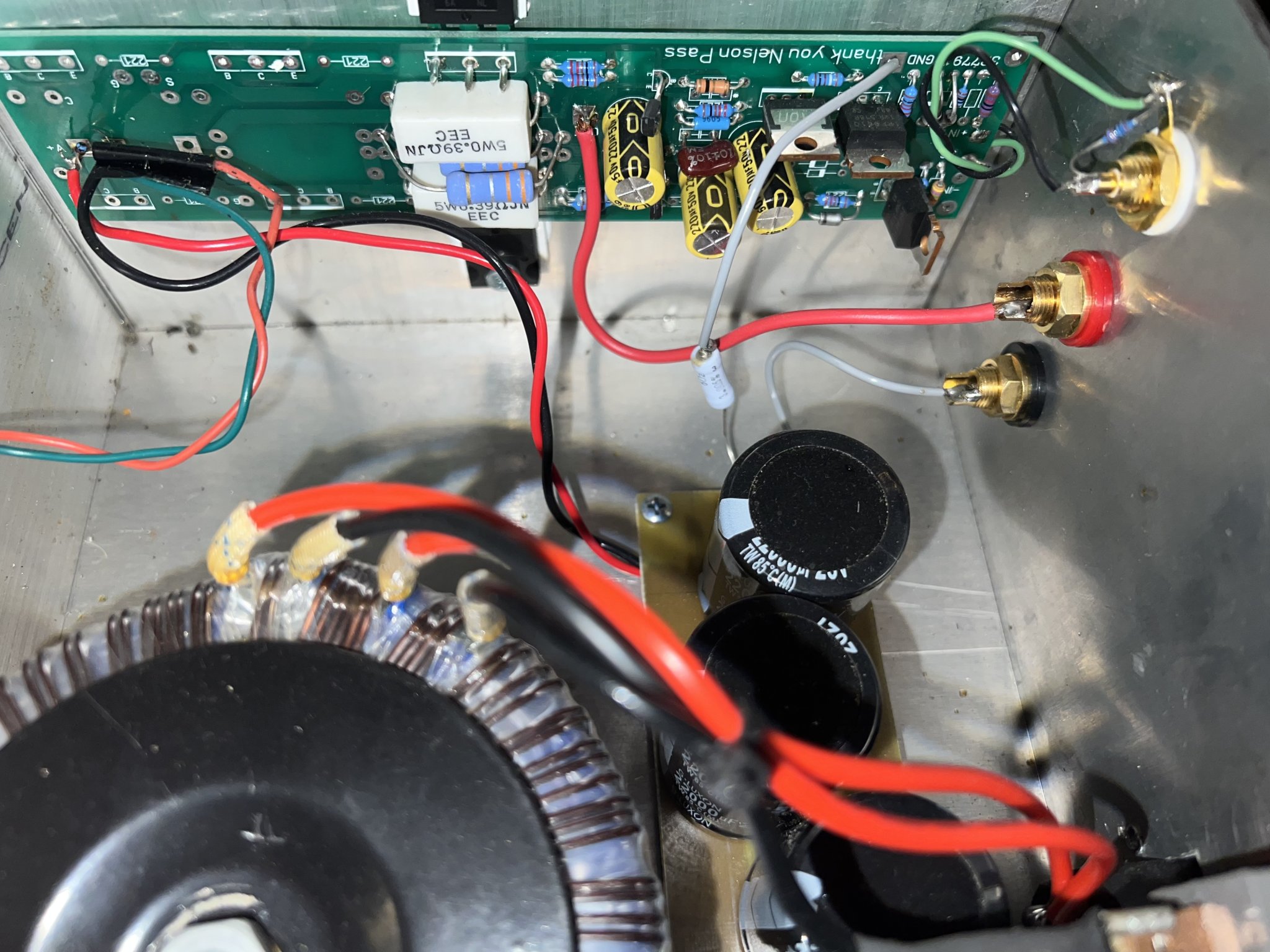

not sure about the hum but I would resolder all of those output mosfets and any other solder joint that looks like it may need it ..dB

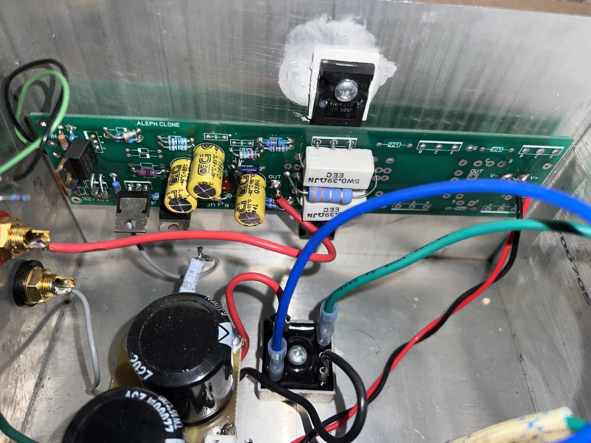

I have a pair of Aleph 5 mono clones on the bench now. They have the usual power supply & grounding issues. One mono had DC offset a bit high, so it’s getting new matched inputs.
I made some “6 pack” CRC power supply boards that are slightly bigger than the existing boards. There’s not much room to work with the big donuts, so why not make some boards. I like working with the 5w vertical resistors - so easy...
The dead bug mounted output MOSFETs are getting replaced with some daughter boards. That should make better use of the entire heat sink, and it will be a bit more tidy.

It appears you have no ground wire from IEC to chassis. That's one to fix up before going further.
How do the power supply caps look? I can't tell in the pix if they're bulging or not.

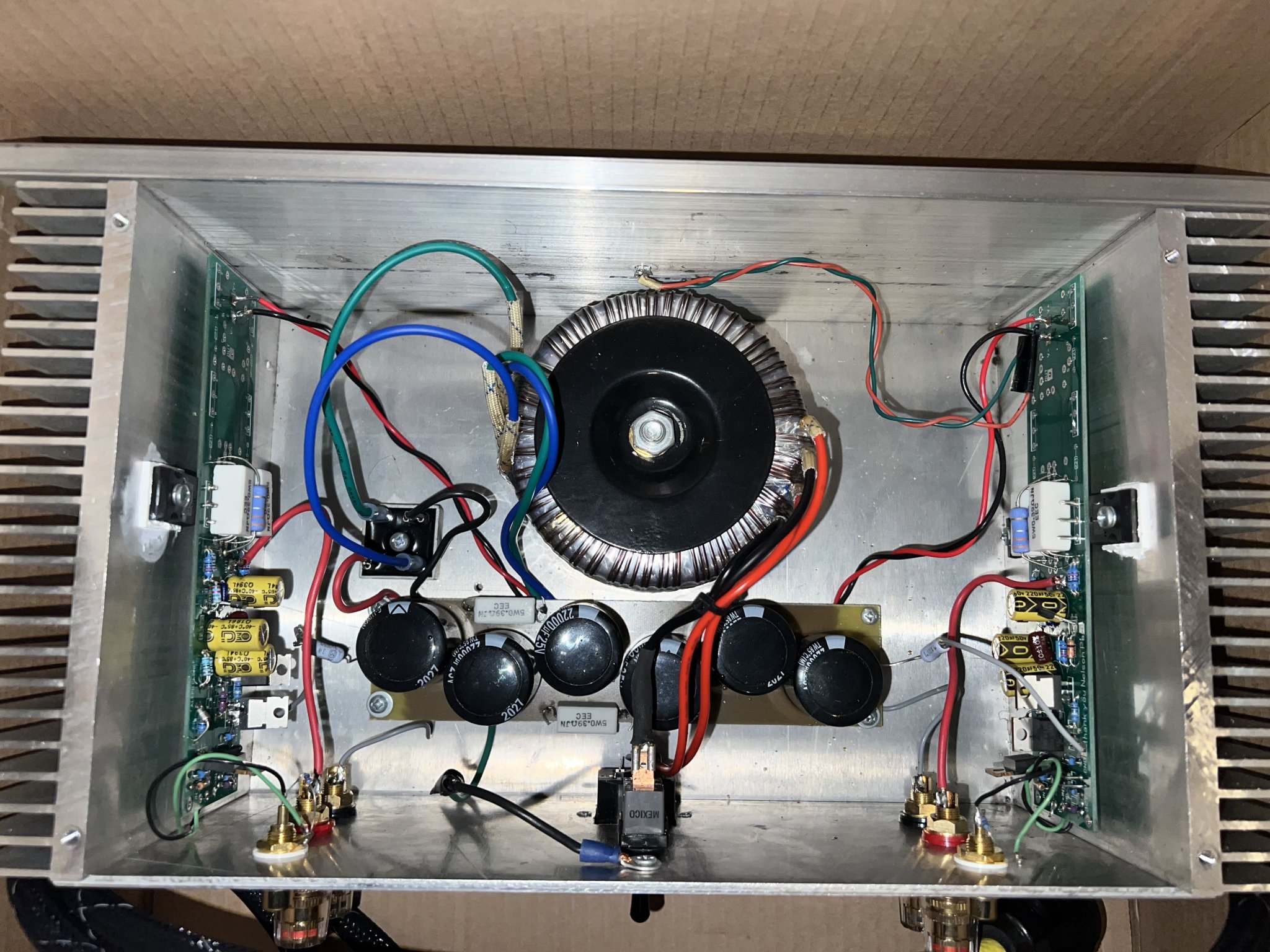

This looks like one of the smaller enclosures. Do you think it's possible to mount the donut on an L bracket and still close the top? If so, you could fit a proper power supply board in with fresh caps. And 2 rectifiers.
If you're up for the fix, I'll mail you a power supply board. I have made a few smaller ones specifically to fit into these boxes. I may even have a pre-drilled L-Bracket I could send you.

Can you please confirm that the IEC AC socket has an integrated fuse holder? It looks big enough that it should and I'd just want to verify that.
If you are able to, I suggest you take up Randy's kind offer and rebuild the power supply completely. But whatever you do, you need to address the the lack of a connection between the chassis to the IEC socket's earth connection.
The transformer looks like an Antek which is fine. Can you see what are the secondary voltages and VA rating? There should be a model label on the transformer giving you this information.

Yes, it's about 15 inches wide, 8 inches deep and 5 inches high, but it seems there's room to remount the donut vertically. The caps look okay to me, not bulged to my eye. If you're still willing, I'd like to take you up on the PS board - I'll be happy to reimburse cost and shipping. And it would be great if you have the L-bracket. It will keep me from having to invent something.
Other notes - yes, the IEC ground is not connected at all - should it just go to a chassis ground, like the one from the power transformer? (As you can see, I'm a kit builder, not a designer!)
dBel84 - yeah, there doesn't seem to be much solder visible on the outputs. I will add some - better safe than sorry.
Mikerodrig27 - adding standoffs to the ends of the boards - would that require drilling the heatsink? Or is there an easier way? It makes sense to address the fact that they're unsupported.
DennisHui - the IEC doesn't have an integrated fuseholder. In fact, there's no fuse at all. I know that needs attention.
The transformer is an Antek - it's hard to see the writing but I think it's 15-0-15v.

No fuse?!?!?!?!?! WOW. Post of picture of that IEC, please.
What transformer is that? I want to confirm the diameter plus VA rating. VA rating for fuse sizing.
If it's a 15+15V Antek I'd expect a part number like
AN-2215 (200VA 15+15)

I tried to squeeze the camera in there to get a photo of the IEC but no luck. But I can see that nothing is connected to the 3nd leg of the iec.
i was able to see that it's the AN-2215 transformer.
If you didn't want to drill holes, there are adhesive standoffs. If the adhesive happened to fail (likely due to heat) the mosfet pins at least keep things indexed. The best solution would be to drill some holes for M3 standoffs.
I would check to make sure the mosfet screws are snug.
