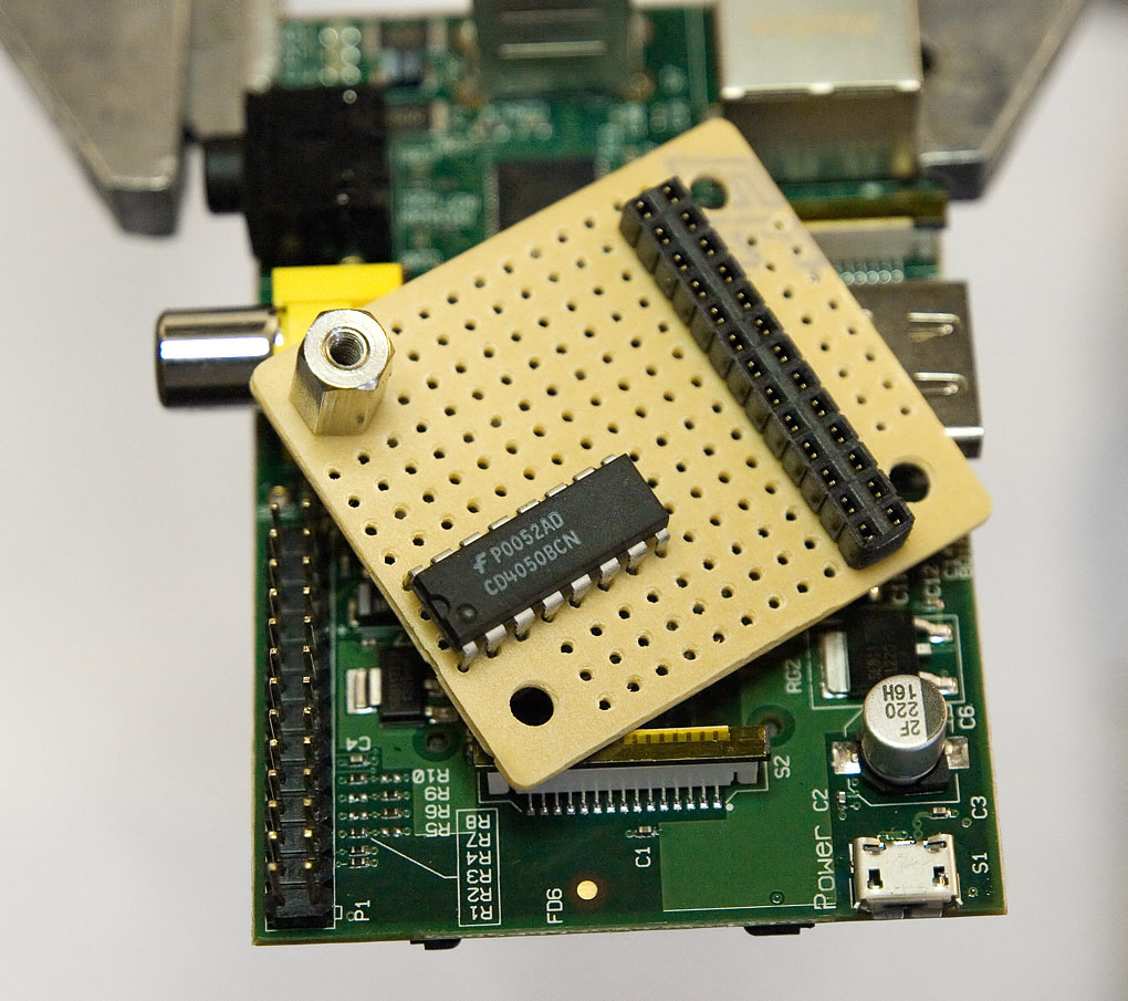

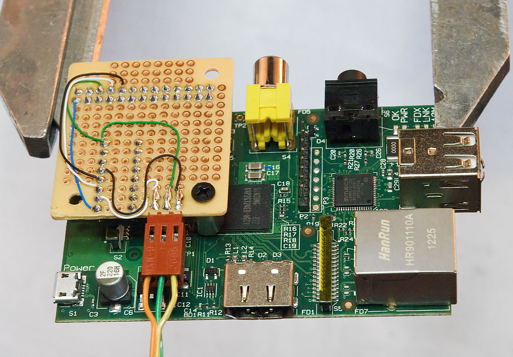

sounds like you want precisely what I want at least for now I can deal with 176.4 for this module, running 352khz audio on the go is one step too far =) so mate i'm waiting in the wings. guess I better start thinking about batteries to cope with the extra load of this thing, maybe just get a couple pouch cells for powering this AND the dac/amp.

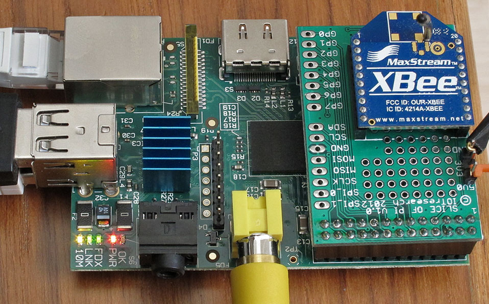

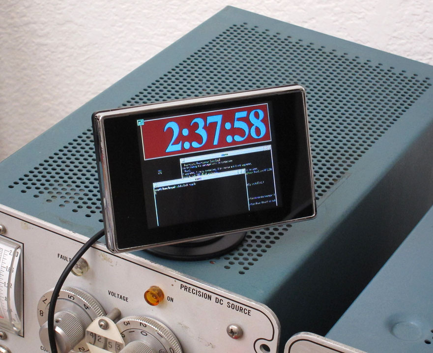

some fun pics from my rpi experiments today.
a small composite display, an xbee 'shield' and an adafruit half-length micro-sd card adapter.
system is now overclocked to 1ghz with the latest update.
