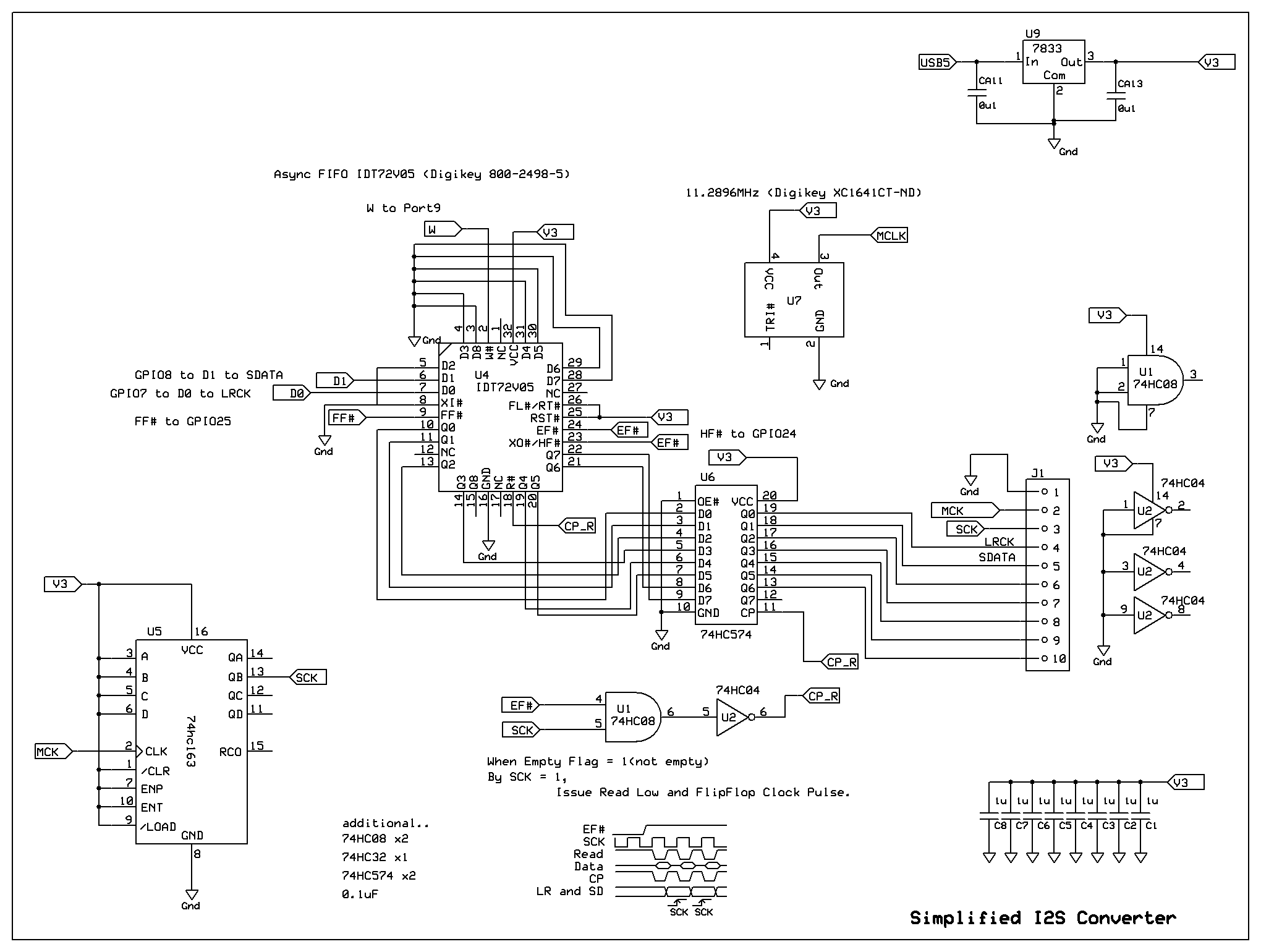

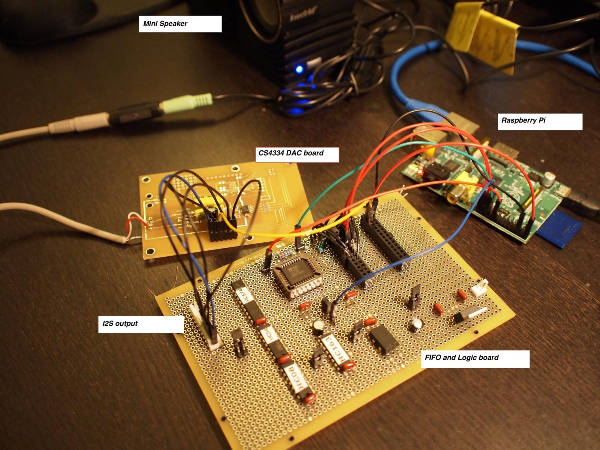

I made simple WAV file player on Raspberry Pi, using GPIO / external FIFO / 11.2896MHz clock / some 74HCs.
I'm not using any PLL or internal clock.
(1) read wav file into memory. (Free memory is around 180MB)
(2) set up GPIO, fill some 0 to FIFO
(3) generate I2S bit stream from PCM signal
(4) FIFO accepts 2 bits, LRCK and SDATA, 72V05 = 8K samples = 23msec. 72V06 is 16K samples.
(5) external 11.2896MHz and 74HCs "pulls" each I2S signal bit.

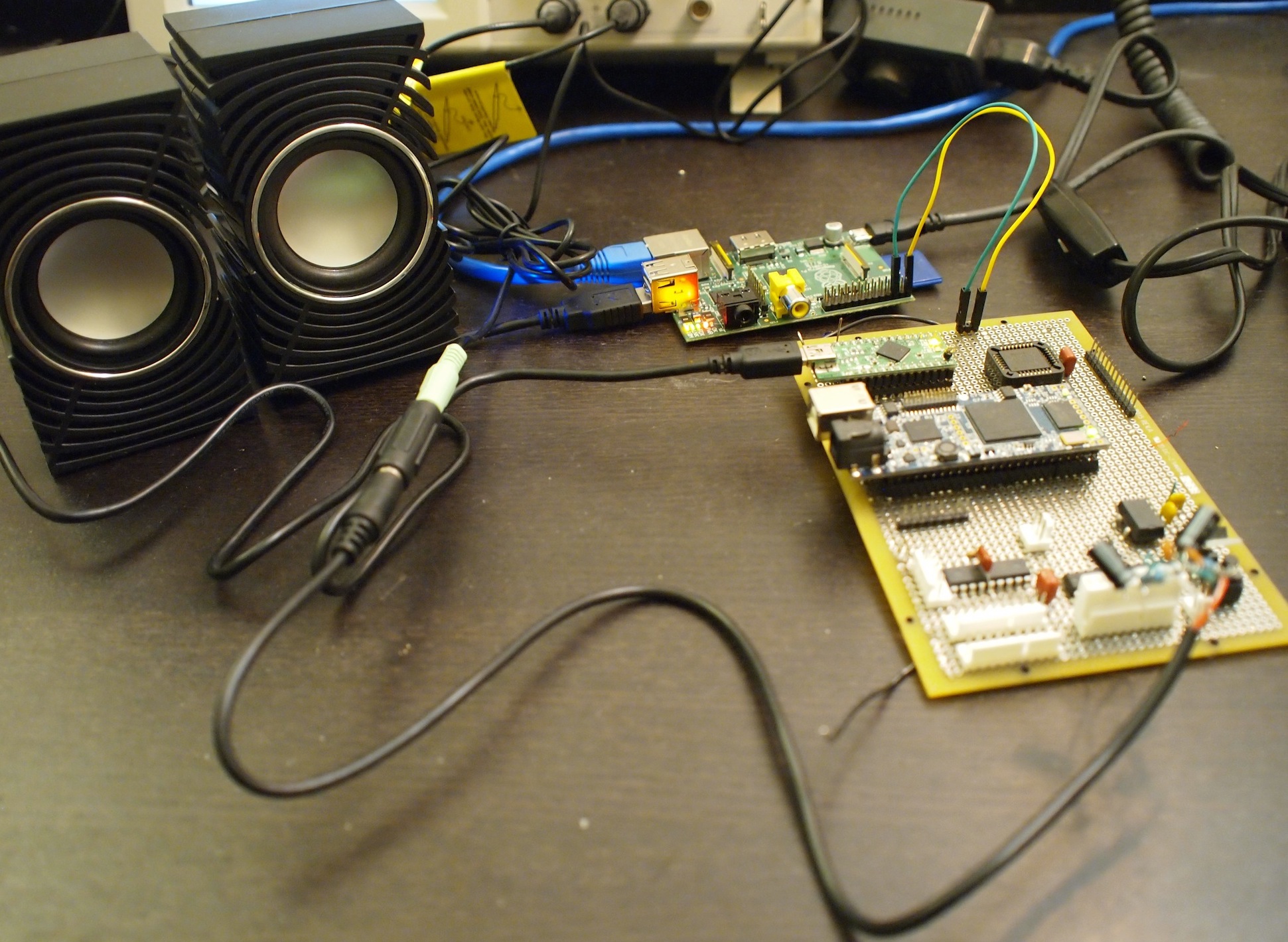

I modified source code to use interrupt. more stable than before.
WriterThread does
(1) make bit stream from PCM
(2) output 1 bit
(3) check full flag. if full, stall until pin 24 rising edge. (more than half empty)
I think no more speed headroom for 88.1 or 96k PCM. when I add dummy GPIO read / wirte, buffer underrun occurs.
Maybe parallel GPIO output (8pins or more) and FPGA parallel - serial conversion can work for High resolution or DSD playback.
Anyway this method is very easy for your DIY, than dsPIC SDHC player.
The problems: Now I'm using CS4334, there are no "MUTE" pin so I can not stop glitch when FIFO is empty.
I'm waiting 'Humble Pi' add on for Raspberry Pi. when I get I will show more organized version.

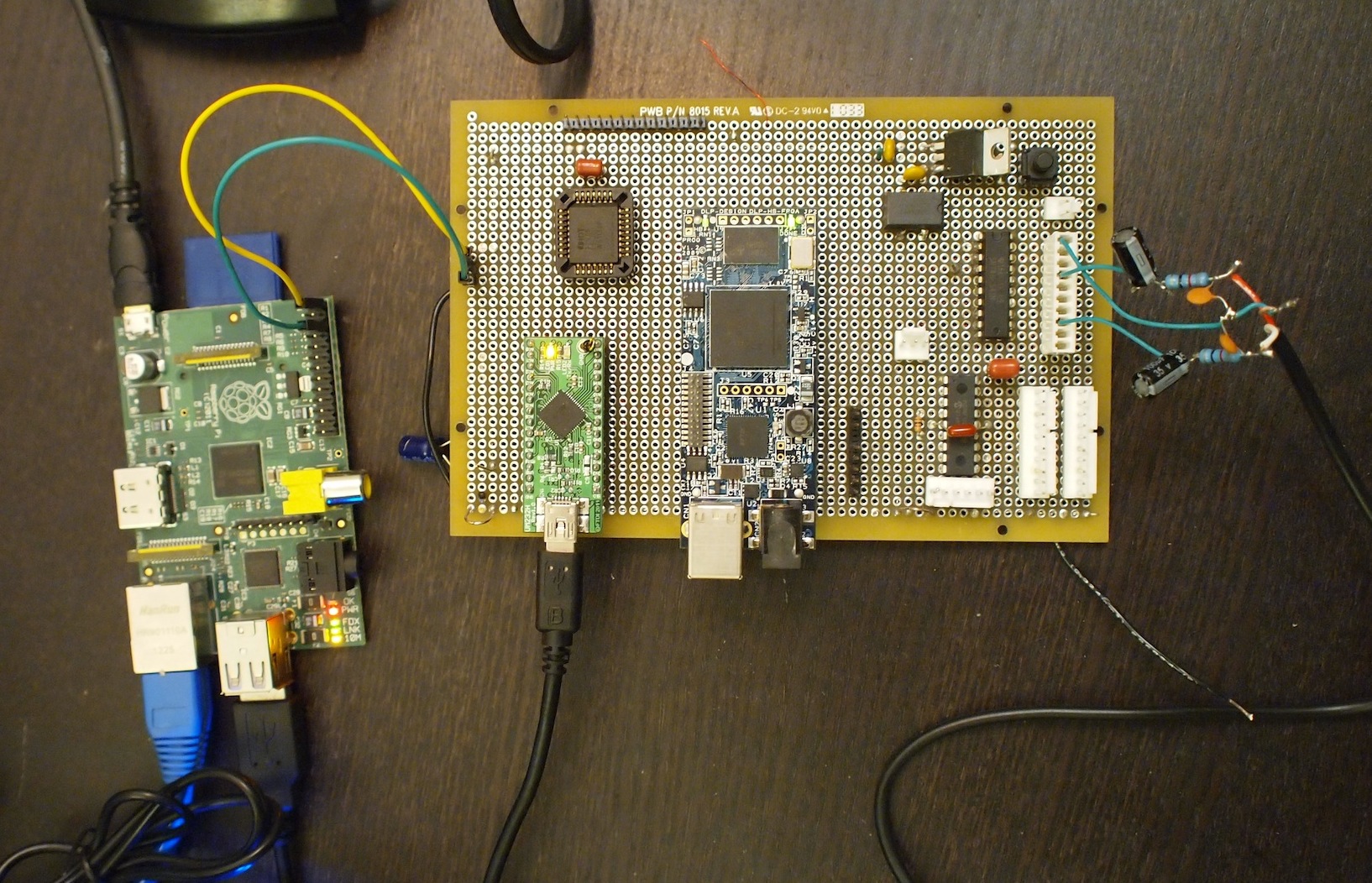

DSD Playback by Raspberry Pi
I used the same board here,
https://sites.google.com/site/koonaudioprojects/dsd-playback-system
Now I try
DSD File Playback by Raspberry Pi -> (FTDI UM232H -> 22.4896MHz + FPGA DLP-HS-FPGA -> HC574) -> LPF -> small active speaker.
(1) Install
libusb-compat-0.1.4.tar.bz2
libftdi-0.20.tar.gz
(2) modify source code for libftdi
attached, read DSF file and make bit stream, then write to FTDI

(3) Hardware
I modified around UM232H for 5V power supply.
and I used CR LPF for DSD output to analog signal, then connected to active speaker.
(4) Playback
sudo ./DSFPlayer01 ../DSF/10.dsf
OK I success, it's easy🙂
limitation: I can not read whole DSF file(over 200MB) into Raspberry Pi's memory(total 188MB), so now I only listen to leading 100MB.
Maybe multi-threading, (a) read and make bitstream (b) write to FTDI, with ping-pong buffering will work.
