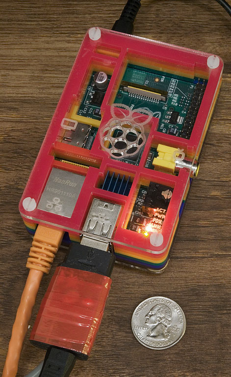

If i plug in a 'turtle beach audio advantage micro 2' adaptor to get a toslink option them Im a step closer? Come on don't make me the one that killed this thread.
that's the exact dongle I have clicked in right now on this photo. the TB dongle is bit perfect (cm102 inside) and works at 44/48k just fine.

the config, as pictured in the 'colorful case' (lol) is fine for a headless audio player. the opto out goes into a DAC and that's where the audio matters (for the most part). at 44.1k rate, it keeps up fine.
now, over wifi its not super reliable. I used the recommended usb dongle and while it does work, wired ethernet is SO much better. if you can, at all, use wired (even powerline ethernet) you are strongly encouraged to do so.
it mounts its music shares across either nfs or samba (or even a mix). that remote disk stack works fine and the tcp/ip stack is, of course, fine.
what is NOT fine is putting audio behind a hub. there was an old linux bug about usb1 audio devices behind usb1 and usb2 style hubs. I think usb1 (old style) hubs are transparent enough but usb2 can 'hide' some of the audio features and the card may be seen but won't work. same with wifi, it can be partially seen but not fully init. putting the usb device ON the REAL 2 usb ports always works. and so, you have 2 usb choices of things to connect and try to avoid hubs if you can. in my config, I have only 1 usb item populated and so I'm trying to make it as easy as I can on poor little pi-usb 😉 (the 2nd usb cord is optional and if it ever gives me problems, I can remove it and its feature).
