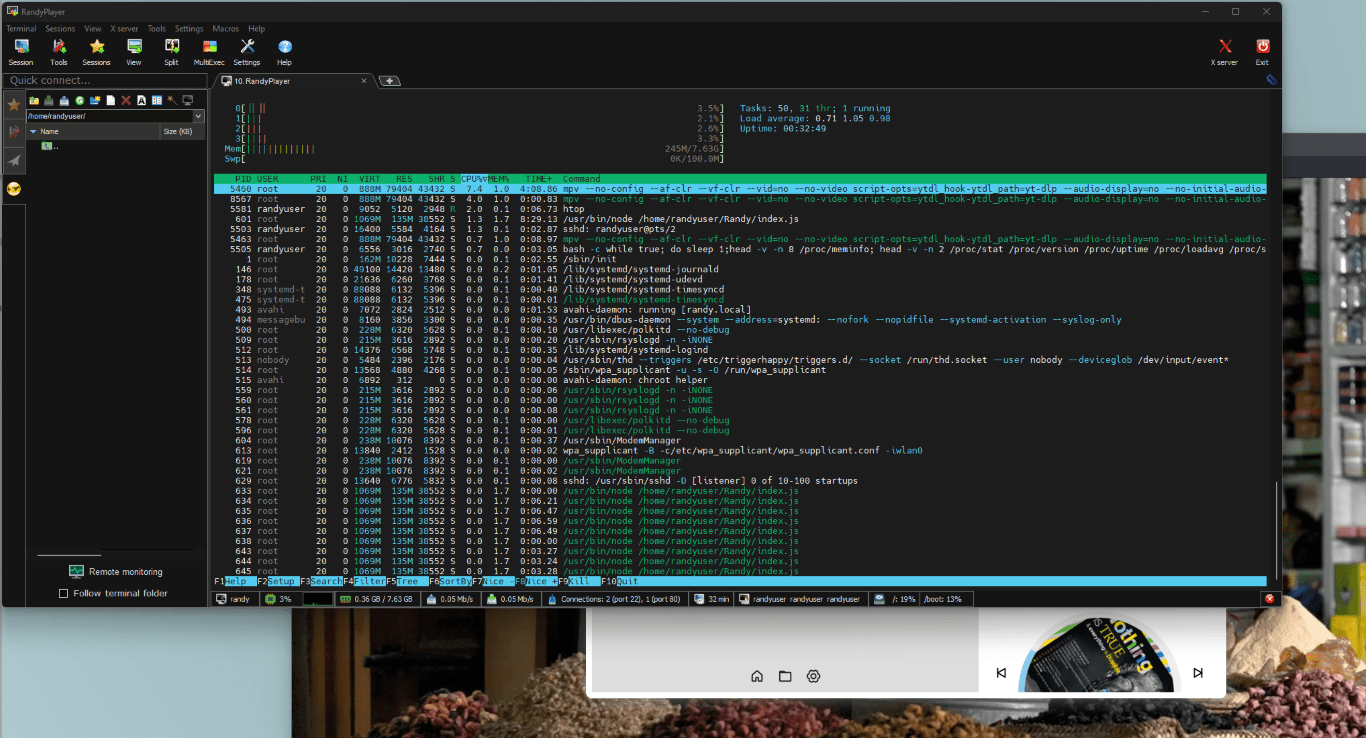

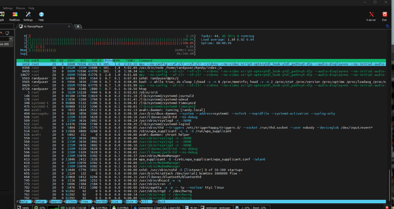

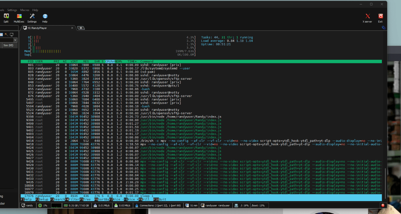

I do want to report some observations for you. I attached a bunch of random screenshots which maybe useful.

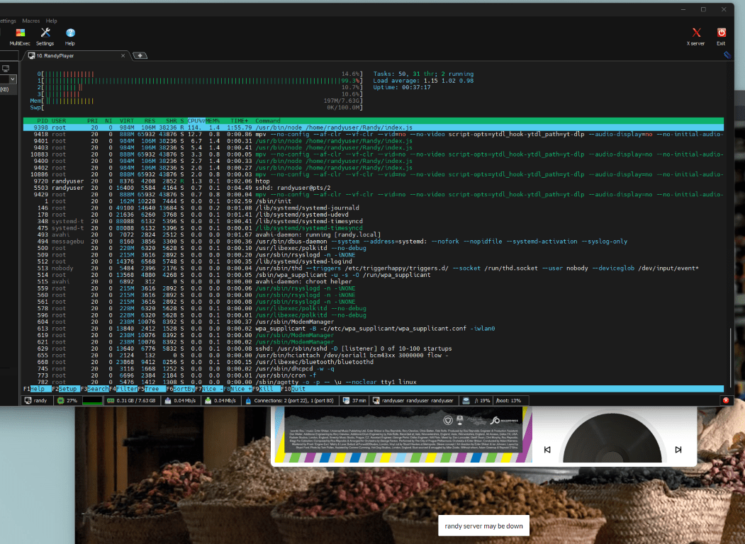

Randy player interface is stalled when moving between panels presumably generating the random album selection and parallel indexing perhaps?
2 CPU's pegged at 100% and reports after maybe 30s server maybe down at bottom of page. You have a timer. 😉
~25s later it displays the random albums set and is functional to select new tracks. Clicking an album works as expected to fill the queue and start playing music. cha cha cha
After I paused, I noticed a bunch of mpv process at the bottom of the process listing. Not sure what's going on, but appears many processes are spanning, dead or forgotten perhaps? Is that expected?
Once getAllSongs completes things should get reasonably snappy.. the screenshots are helpful but if you are able to grab the log (journalctl -f -u randy-node) would be even better then I can see if maybe something gets stuck/timeout somewhere...
btw.. Randy looks for the file metadata on the fly and once it has it, it will cache it for the next time you load it. So for example getting the random albums to show on the main screen can take a bit if they are all fresh, it will look for file tags, existing album covers or use spotify album cover api if it can't find one.. for me it's never been more than 2-3 seconds and usually pretty quick.
Regarding all the multiple mpv instances in htop. this maybe helpful to explain - https://superuser.com/questions/118...processes-listed-under-the-same-title-in-htop , I am not 100% sure how mpv manages the different threads..After I paused, I noticed a bunch of mpv process at the bottom of the process listing. Not sure what's going on, but appears many processes are spanning, dead or forgotten perhaps? Is that expected?
but on Randy side I have a function that kills all instances of mpv if there's a socket timeout or something else goes wrong before it re-spawns it again.

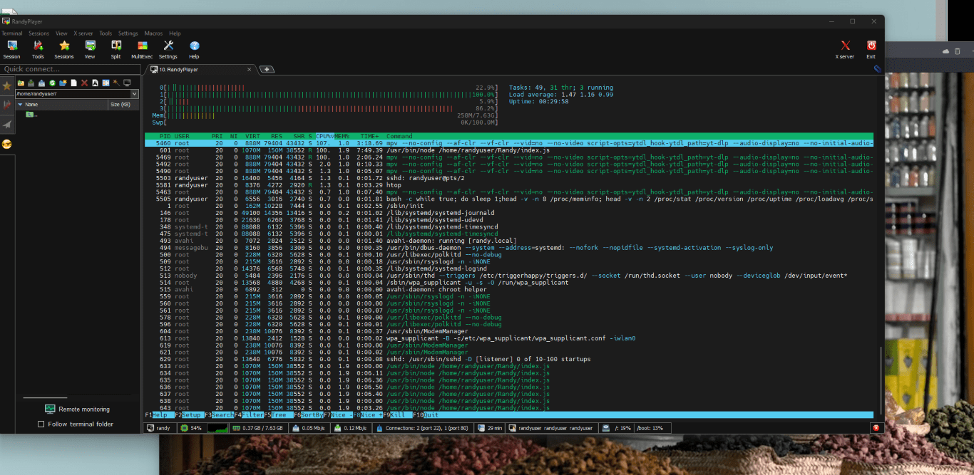

When I started the system this morning, CPU pegged at 100% Randy/index.js and it is not able to generate a webpage display. 45mins so I restarted.
FYI total file count in library mount.
randyuser@randy:~ $ find /mnt/Music -type f |wc -l
129748
I have PM a log report which shows a couple of things.
The file missing which isn't
Restart after not getting a webpage for Randy
Couple of stalled panel changes
Edit:
Is there an Exclusion function possible? Because I mount to the root folder on the NAS, it is picking up the Recycle bin folders and the content of these.

@Sumaco - thanks so much for sending the log!
It seems like similar to the earlier situations you reported when Randy can't reach a specific file goes all nuts with CPU.
I still can't reproduce it, last time I tried to reproduce it by pulling off my HD in the middle of playing a playlist and I even added some things to mitigate some edge situations, but your situation seems a bit different. I am going to send you over some things to try soon 🙂

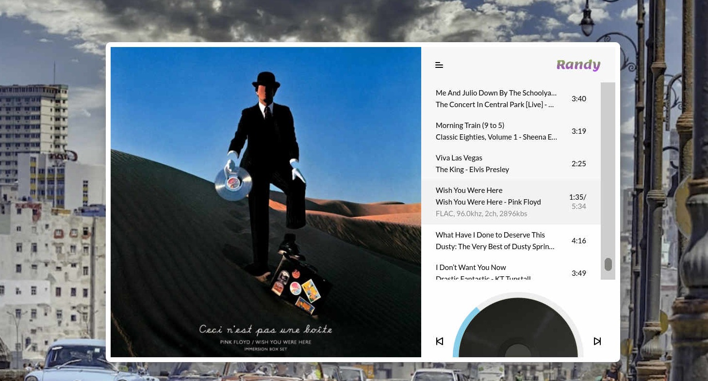

Works !
Noticed a much quicker access to files and selected item to play.!
Almost instant switching from selection to selection.
Code:
cat /proc/asound/card1/pcm0p/sub0/hw_params
access: RW_INTERLEAVED
format: S32_LE
subformat: STD
channels: 2
rate: 96000 (96000/1)
period_size: 2400
buffer_size: 9600

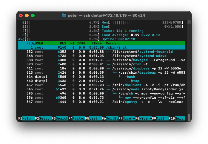

Last weekend I received the Orange Pi R1 Plus LTS, it is a great device in a nice aluminium case.
I’m running DietPi on it, created via the script https://dietpi.com/docs/hardware/#make-your-own-distribution.
Gideon sent me a message with a way to update mpv to a more current version, it seems this fixed the memory/resource leaks.
After a few experiments I changed some of the command line arguments:
and
