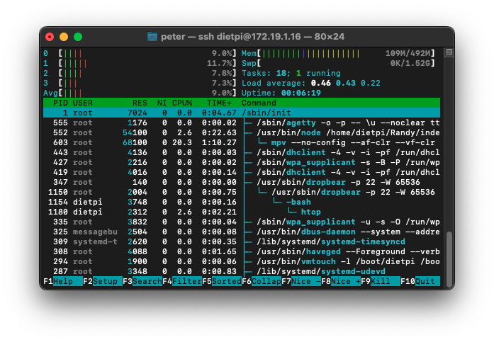

Last week my dietpi image for my Orange Pi (OPz) failed to start and I used the latest Dietpi image for the RPi ZeroW (on my RPi ZeroW).This look like a fun project to try. I have an Orange Pi Zero and an USB DAC/HPA.
If it works I will order an Orange Pi R1 Plus LTS in a simple/nice metal housing.
The install.sh downloads a number of packages, is there anything I should install on my old (November 2021), blank OPI Z DietPI image, before running your install script?
With some manual changes and support from Gideon, I got it to work.
Today, I burned the OPz image to another SD and tried again with the OPz. Dietpi upgraded itself to the most recent version.
I enabled Audio via the dietpi-config configurator.
Connected via ssh fom my mac, the OPz returns an empty value for 'logname', I don't know exactly why.
(Gideon tested it and for him logname always returns a value.)
I downloaded the install script and replaced the call to logname by whoami.
Then I executed the script and it ran flawless.
After a reboot, I can listen to internetradio, although not all the stations -I listen to- play and I miss a volume control (or perhaps the expensive DAC I used doesn't have one...)

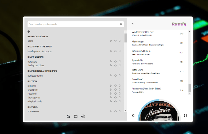

Randy Library view:
Subset of current mount point view:

Randy Library view:

You don’t need big hardware to listen radio streams. Playing 320k FluxFM Kompensator stream On my Orange Pi Zero (running DietPI):
