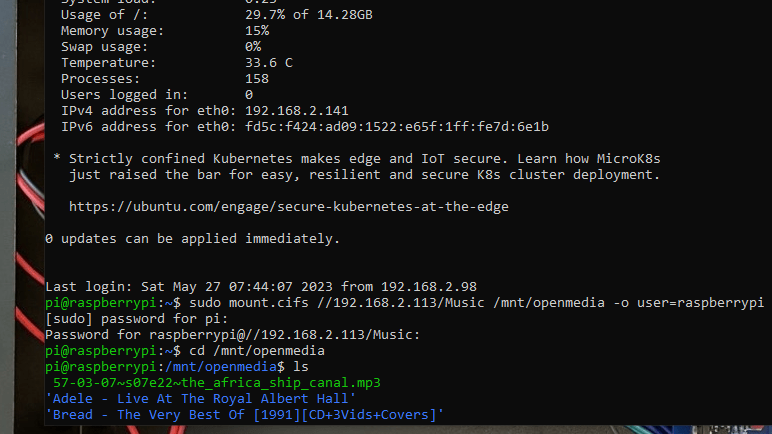

Thanks Gideon and everyone for a great Player i am trying out Ubuntu Server on Pi4 pretty nice !
I too struggle with NAS mounts i have a pi3 with OMV too .
Raspberrypi documentation has great documentation that helped me search cifs that should give you direction
also i think i had too install cifs utils with ubuntu server and basically mkdir /mnt/openmedia or whatever you want too
mount your server too..also my omv password is default "guest"..then hit path too NAS button in randy (/mnt/openmedia) in my case.
No more oops something went wrong your openmedia folder should populate.I have too do this after every reboot now too figure out a
permanent mounting solution i think thats /etc/fstab ?. Im getting close but no cigar yet!
I hope this helps in someway ..and again thanks Gideon this is great the search bar for music is a great idea!

@Sumaco
Hoping you can help with NAS access.
I have an Open media Vault NAS that is found by other players without problem. (MoOde, Volumio, rPlayer) but not by Randy.
I have configured for guest access with no joy, specified client as Randy IP with no joy, setup smb on Randy for the NAS mount with no joy.
Not sure what I am doing wrong or without but if you could outline the steps you made to configure/access your NAS it would be most appreciated.
(currently all that Randy reports is that "Something went wrong" lol ...must have borrowed that phrase from Redmond !)
Sure, I can give it a try... Ya, nice error descriptor...!
Never did anything special for this configuration then for other rpi OS. I should mention that I do not use the guest accounts anywhere. The account used is an authenticated account with RO privileges on the target NAS share.
Reference variables:
Local Randy mount is /mnt/Music
Library sourced //ajaxnas02/Musid_Dev
Here is my routine:
Software:
sudo apt-get install samba-common smbclient samba-common-bin smbclient cifs-utils
Test:
sudo mount -t cifs //ajaxnas02/Music_Dev /mnt/Music -o user=username,pass=SomeSecretPassword
Check:
username@randy:~ $ df -h |grep Music
//ajaxnas02/Music_Dev 14T 9.8T 3.6T 74% /mnt/Music

Thank you @Sumaco and @picman84. Great information and I now have NAS access. I was close but your posts gave the final fixes.
I turned off the Guest access and went back to the User...and realised there was an illegal character in the password. Other players must have the patch that converts these included so rather than modifying the users password and having to reconfigure every other player instances I simply made a new user with a 'legal' password.
The check for mount worked so went ahead and tested. Yet to configure auto-mount and finish but enjoying listening now.

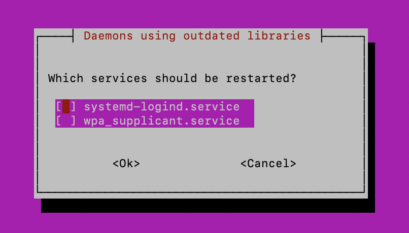

Tried the x86-64 version today.
HP T-520 Thin client. (Dual core, 4GB ram, 16GD flash storage.)
Installed Ubuntu 22.04 server and ran the install as per your post.
Went well (apart from about a zillion 'what services do you want to restart' messages from the ubuntu server....just tabbed down to the default O.K each time and continued to the final reboot 🙂 )
Followed @Sumaco How-to for NAS access and perfect !!
Excellent work all !! and many thanks for the guidance and code !!

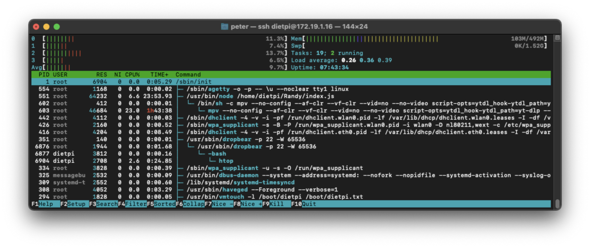

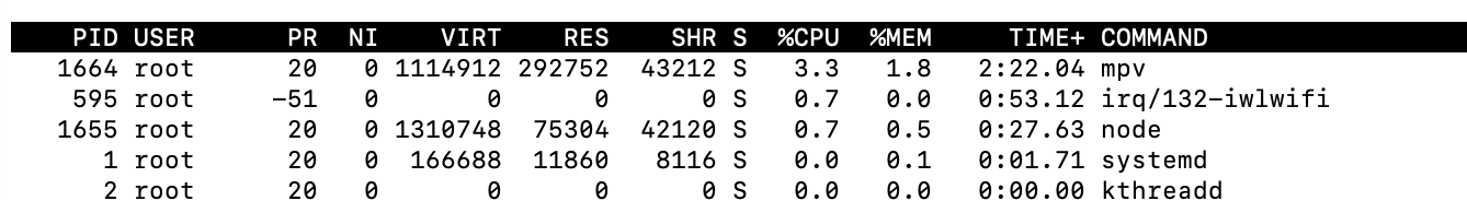

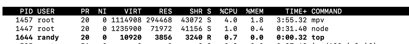

Hi all,
Today I had some issues with higher bitrate streams (320k and flac).
Over time memory consumption increased, eventually causing mpv to start to ‘stutter’ and terminate.
It would do so continuously, perhaps respawning every 15 minutes, because Randy would spawn a new instance.
I’m not sure about the cause for this resource leak, but it seems that spawning the process with option shell: true fixes it.
For now it is playing Radio Paradise flac stream for almost 2 hours without memory growth.
Another (unrelated) thing I see is that in the command line for mpv, script-opts isn’t prefixed with --
That seems related to youtube stuff (I don’t use that) so I have no idea about the impact of that.
Man, I am wondering if I can stop this as well! Ubuntu seems to trigger it every time theres some updated packages, I guessing people using ubuntu in docker images have probably figured it out.
In any case for others trying the same - for now you can just accept these when they come up and move on with the installation script.
@PjVervoorn -
Another great find, when you are running things on such low powered devices it forces you to find optimisations. I actually played around with different spawn options when I worked on this part a few years ago but didn't test the shell: true option. I need to look into it a bit more to make sure there's no artefacts and publish an update if it's all good.
script opts for mpv part - yes this is the option that sets yt-dlp as default instead of youtube-dl which seems to be dormant for the past couple of years. The syntax should be correct, even though not best practice.
I know you are a radio guy (me too), but I use this a lot to play 1-2 hours shows off of mixcloud - https://www.mixcloud.com/discover/fluxfm/ , you can also try links from youtube, soundcloud etc..

It’s good I wrote ‘it seems', because today it wasn’t stable at all.
Even with 192k streams mpv’s memory usage kept growing.
Basically I have no idea what to do to pinpoint the problem, let alone come up with a solution.
