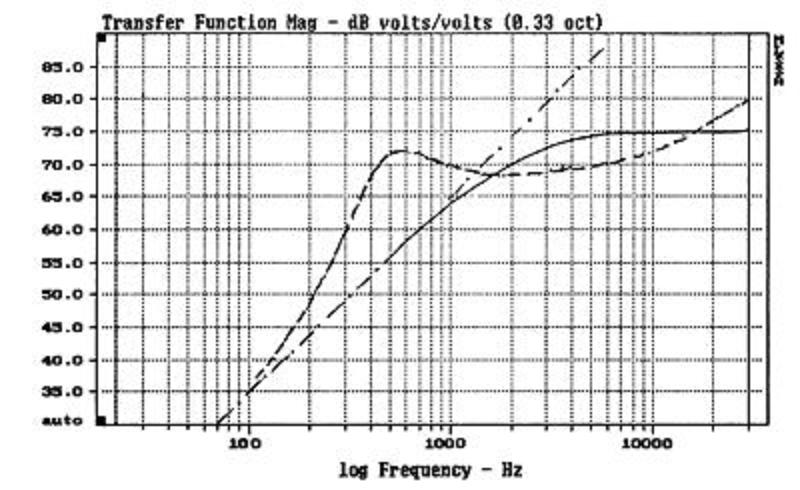

A factor that must be considered is the passive network loss from frequency shaping. We had an early bi-amped monitor system at KEF the BBC LS5 1ac, that used a fairly mediocre 50 watt amplifier. In the end the output capibilities where quite high and it was due to the strongly climbing raw response of the 12" woofer. That was free midrange efficiency that would have to be thrown away in flattening the response with a passive network.
Based on this I developed a broadcast monitor, the P60, that had a passive network with driver blending but no response shaping. This allowed 3-4 dB greater mid frequency sensitivity. EQ in the amp flattened the response. This predated the KEF Kube EQ and bass extension boxes.
The ideal case would be if the basic sensitivity curve of the system could follow the peak spectral contour of music, and active EQ would then flatten the system with no efficiency loss.
