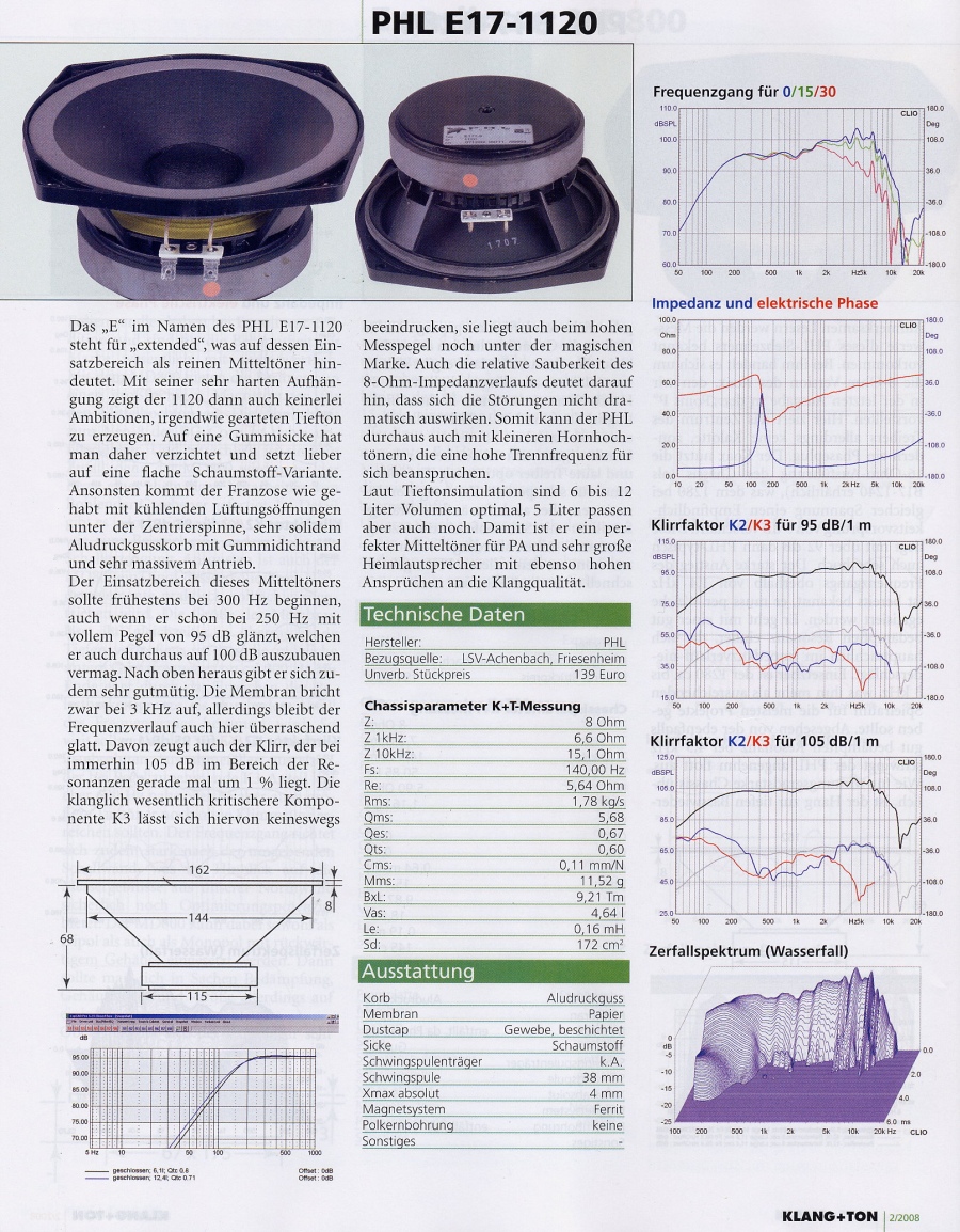

I did today a THD measurement with first a PSE tube amplifier without feedback and second with a hypex class-d amp. It has higher second harmonic but the third harmonic shows almost similar level as the class-d amp!
The picture shows the response of a two way mid-high section using a high quality mid off PHL-audio and a super tweeter horn.

Hi Helmuth,
Interesting curves but a bit confusing to me as you are showing a increase in second harmonic where my curves showed an increase in third. I believe I was showing the distortion inherent in a ferrite magnet structure. Is yours perhaps the 2nd harmonic of a single ended output circuit? (but why then not a smooth function?)
Any ideas?
David
Ps, how did you maintain the same response and what was the tube amp output impedance?

What you see in my graphic is the distortion of speaker and amplifier at 2.9V. The amplifiers have both low distortion at 2,8V although I never measured the distortion of the tube amplifier. The distortion of the UCD180 at 2,9V is 0,0035% in the spec. The distortion of the tube amplifier is not compensated in the measurement.
The tube amp had some variation I use my oscilloscope to set on 2,9V but with tube amp I did see 2,7V and also 3V due the impedance variation of the speaker. The horn tweeter has a near flat impedance due the attenuation.
But it is the real measurement fist on the PSE tube amp and second measurement on the class-D amplifier.
I did not measure the output impedance of my tube amplifier will be some where between 5-8 Ohm.
Conclusion of this measurement is that the tube amp has the high second harmonic or the poor damping factor of the tube amp increases the second harmonic.
I was hoping to see a decrease of the third due the poor damping/ higher output impedance of de PSE tube amp.
Curves of the used mid measured by Klang und Ton Germany. The amount of third harmonic is the -60dB(400hz) at 95dB 1mtr and at 105dB 1mtr.
