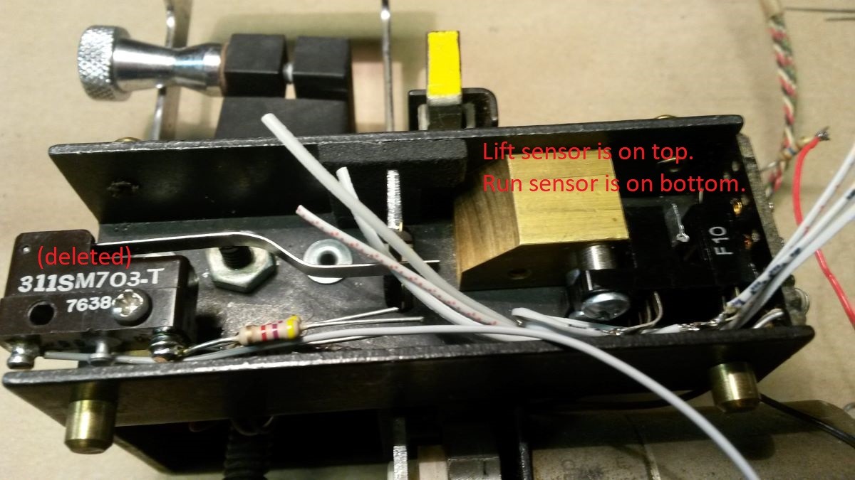

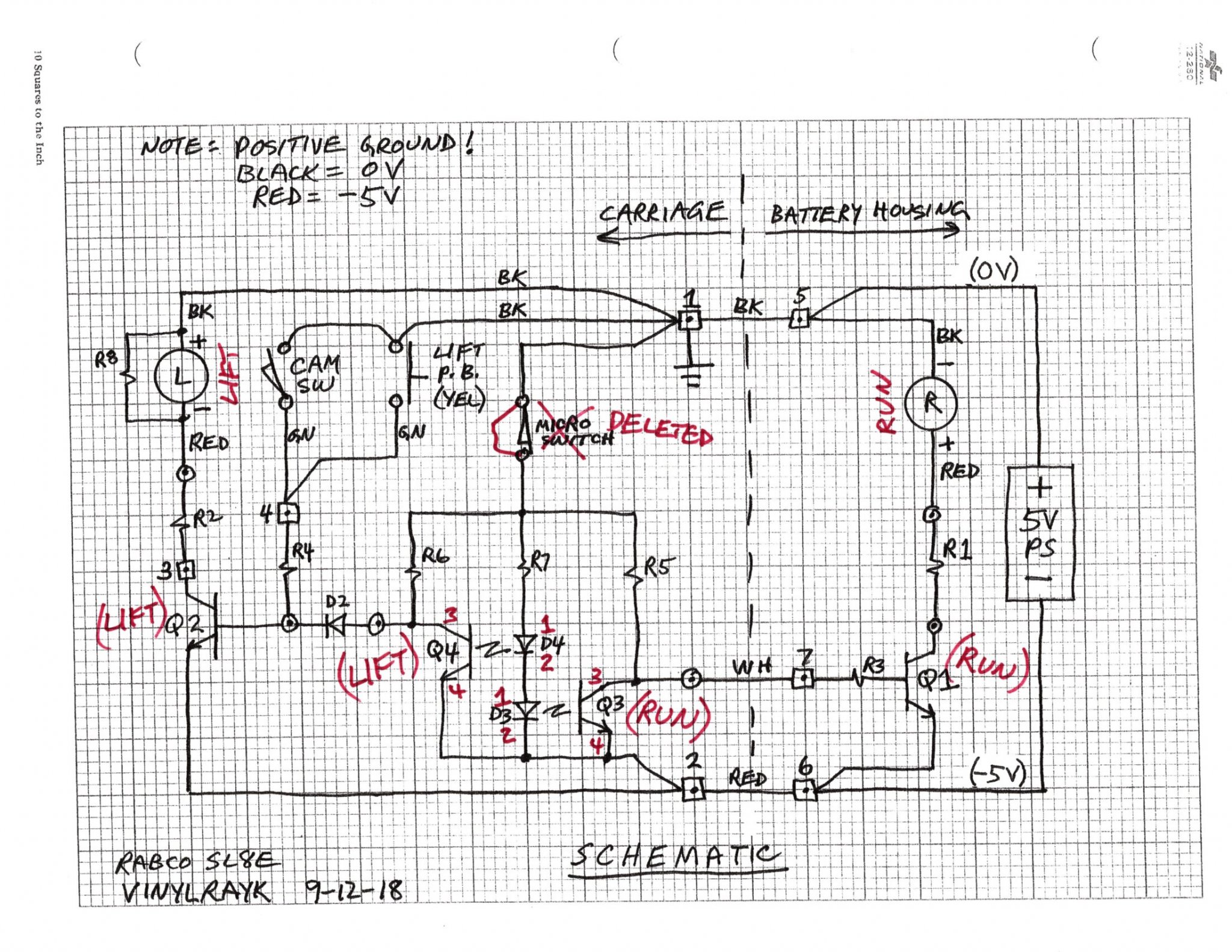

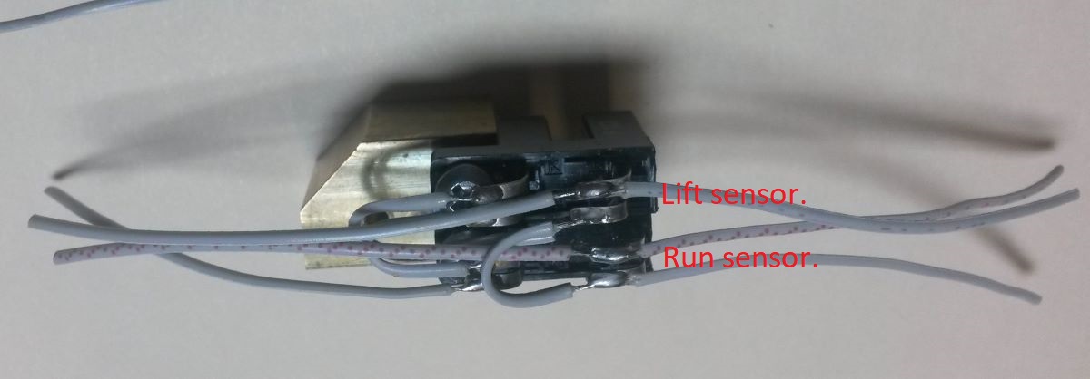

Thanks for your continued support with this mod. I am attempting this as a relative novice so, I have some questions to make sure that I am reading things correctly. I am on mounting the sensors. In the notes to photo#8 the spacers are specified for the run and lift sensors. These are not labeled as such in the diagrams and drawings so, I want to check that I have it right. On the drawings, the run sensor is Q3? This would then correspond to the bottom sensor in photo #7?
Here are photos B, C, 7, and 8 with added clarification notes as requested.
Ray K
Photo B:
Photo C:
Photo 7:
Photo 8:

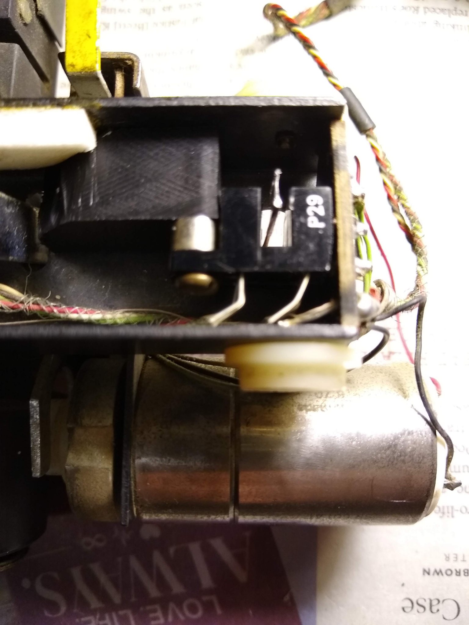

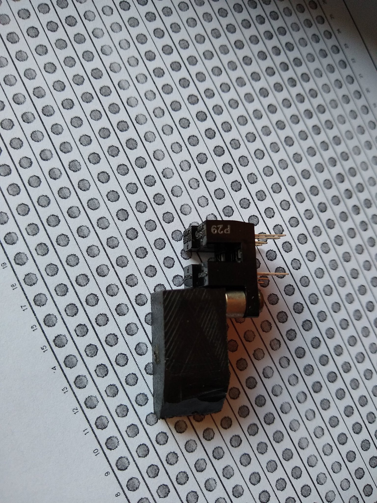

Perfect. More than I could have wished for. Thank you. So, I have assembled and test fitted the sensor block. I must say, that was painstaking work. I am pleased art the result so far. The flag is well centered in the sensor and the offset is 1.1mm on one side and 1.3mm on the other. (Apparently not totally square to the mount.) Close enough?

I have now wired/soldered the photsensor block and have a very basic question. Do you insulate the connections? It seems to me they would risk making contact with the carriage chassis which also acts as ground, right? Thanks for your patience with the naive question.
Looking at your photo, I'd recommend bending the tabs farther down to give yourself more clearance to the back of the carriage. Compare to my photo #22. In any case, it never hurts to add insulation. Sticking a single layer of electrical tape between the tabs and the backside of the carriage should do the job.
