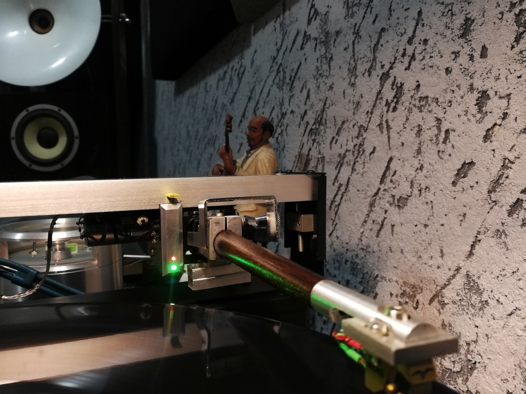

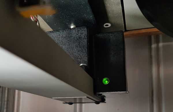

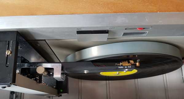

I have just modified my very old Rabco SL8 with your help on this site. Everything works fine with the optical reading, it's absolutely great!
Thank you very much for posting this step by step manual.
I even spent a green led for transportmotor, so i can see when he's in action.
Greetings from Switzerland, nero52
Modified Rabco SL8
Two images, work is done!

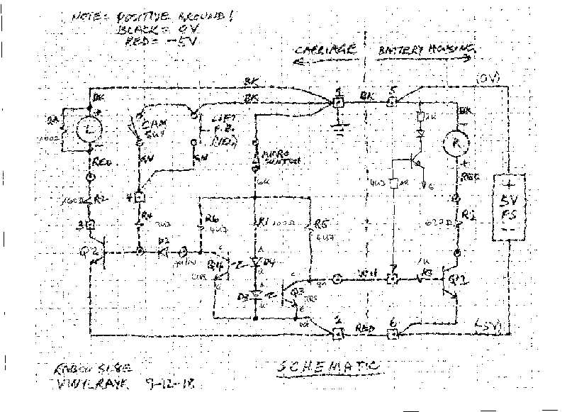

Glad to see another happy user of this mod. Do you have any more photos of your construction details? I like to think that the green led indicator was necessary because the motor was now running too quiet to hear, or is that vanity on my part? 🙄
Ray K

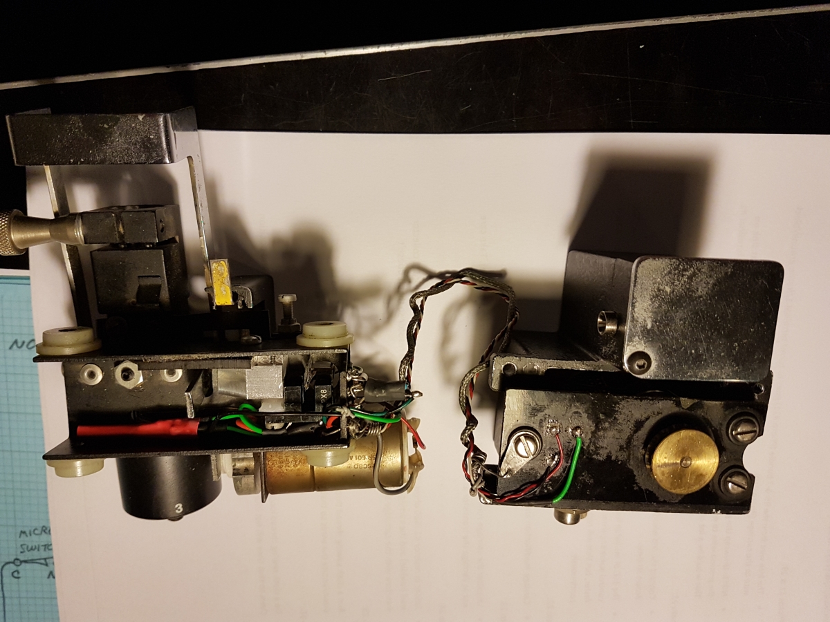

Hi diyrayk
there are only two more photos. The green led indicator is just for my fun, to see that the motor is working. i have never heard the motor, but i spent hours in front of my rabco - hoping it works.
i couldn't adjust the two contactwires anymore and instead of them i took two small pieces of guitar strings. that worked for two month...
now i'm very happy after the photosensor upgrade, but i spent some hours to make it. every minute is worth it!!!

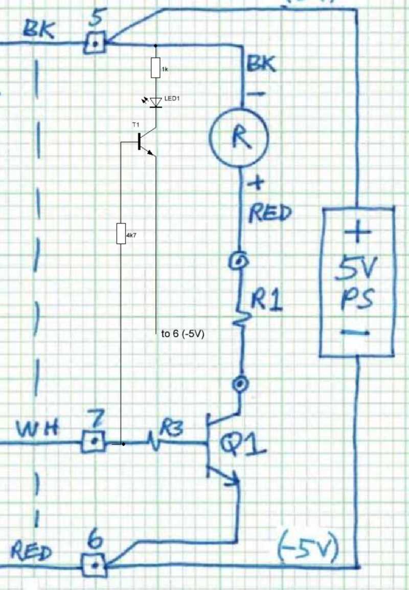

Hi Ray thank you for your great posting, I had modified my Rabco SL8E working very good. Motor run very quietly, visually not possible see the carriage moment. I am very happy, this arm will work another 50 years trouble free. I would like add led for carriage motor moment like Nero52. I had try to add led before R1 resistor (Q1 collector), working but I feel motor get too slow! Pls advice where I can connect led. Tks Rajkumar

i took the 5V (Power Supply) direct from my Thorens TD 125 with a step down Module. Make sure, that the Voltage is correct after modifying with the Led, otherwise the transportmotor is too slow.

The LED circuit itself is probably working correctly. The ideal is for the motor to operate continuously, and speed up or slow down as the groove pitch varies. You can verify this most easily by monitoring motor voltage directly with an analog voltmeter. With a theoretically constant groove pitch, the motor voltage will also be constant. Groove pitch in the real world is not constant and records are also off-center to some extent, so motor voltage isn't constant but varies up and down with each revolution. LED's like to be either on or off. My guess is that the LED circuit is biased somewhere in the middle of the motor's actual operating voltage range and is turning on and off as the motor swings within that zone. The LED turn-on point could be manipulated by selecting the gain of the added transistor and the value of the added 4K7 resistor.

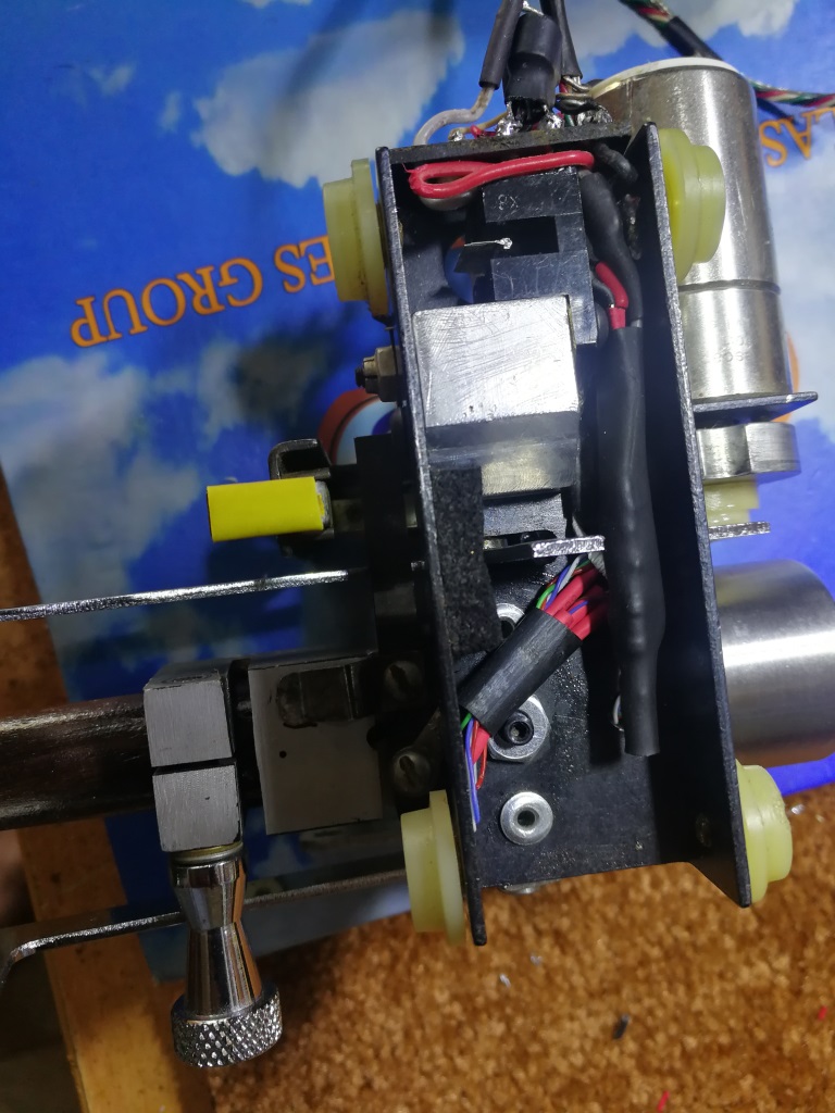

Rayk absolutely you correct, I have check many LP's many of then off center this is the reason led light (motor) turn on/off, one of the my LP I found correct center than led turn on continuously. Now I have cleared my doubt. I have installed 2 led red & green. Green for carriage and red for lifting. Everything working perfectly. I have post some pictures. Tks lot Rajkumar.

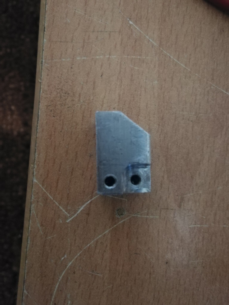

What a treasure trove of information! I am about to do this retrofit on a set up inherited from my father. I have reviewed the step by step and I am eager to replace the brass mounting block with something that is easier to fabricate. I am thinking delrin/acetal bar. It is eminently machinable (by hand). Also, it will not corrode or conduct current. Anything I am missing on the brass that should make me stick with it? Also, what is the purpose of the particular profile of the mounting block vs. a cube? Thanks for all that you are doing to keep these alive.
Hi Regarding profile of 1st image, there are 2 photo sensor will mounted those hole, on the top (profile) 1st sensor for carriage moving and 2nd sensor without profile for end record for lifting. Both sensor should not same inline, this is the reason have profile for 1st start earlier for carriage moving, 1nd sensor later for end record lifting. I hope you understand. This profile depth based on actual requirement.
The block does not have to be brass. It can be anything that can be drilled and tapped for the mounting hardware used. I only used brass because it is easy to machine and I had a conveniently sized piece in my ‘junk’ box. The profile is unimportant other than to hold the sensors in position and be clear of the drive chain. I put a bevel on it only because I didn’t want to trim or cut away any of the foam gripper pad.
