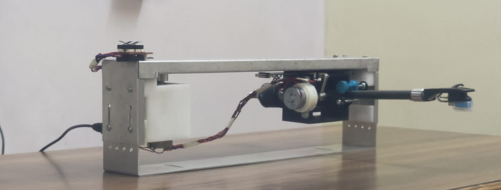

A close friend's 100% diy effort . Has successfully completed all trials. Shall share more after some final touches are completed.
Awesome!
More pictures please.
What kind of motors did you use and where did you get them?
