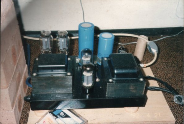

hello folks
how do you like my QS8417? It was made in 1982 and I bought it as 2nd hand in 1988. Rplace the caps with Sprague (the old Rubycon was leaking) and RelCap and resistors with Halco, plug with WBT, get 2 pairs of new 8417 from QS. But the good old sweet slow warm sound is then gone, come the more tight transparent new sound...
The GV378 was bought from Triode Electronics in 1989...the price was reasonable then so I bought 4 pairs...you can see that the first bypass cap value was increased, and it caused some firework inside the poor old 5AR4, so far so good with the GV378
A few years later when the 8417 need to be replaced...maybe mod it for KT88...or how about EL34?

LOOKS GOOD TO ME.
The 8417 is long gone now and you may have to consider the alternate roads :KT88,KT90 or EL34.
All will reduce the power output a bit but I doubt you'll notice it.
The fat bulb EL34/6CA7 really sounds great with this amp.
Your rectifiers are actually GZ37s AKA CV378 (British military designator).
Why people insist on putting such high capacitance behind these rectifiers is beyond me...according to my datasheets the GZ34/5AR4 take 100 microF per tube and the GZ37 4 microF.
Something must be asking for trouble....🙄
It wouldn't be missed by me but "de gustibus et coloribus non discutandum est".

Mr Sanders said increasing the capacitance would degrade the sound, I didn't understand...I was young then...now I appreciate the softer bass

Hi Joe,
I think it's best that Mike Sanders does the upgrade for you, then you can choose your poison as Frank indicated, E34l's, 6550, KT's.
I suggest you rhetorically describe exactly what is under the hood, and we put it back or as close to -- stock as possible.
Mike has told me of several BAST***ized amps that he refused to work on and sent them back. Fret not , as yours is not there *YET*!
As for toooo much uf - yes it will make the bass loose and sloppy
I've tried many combo's and now have one 750 +47 feeding both rails. I believe Mike is also now using just one supply cap.
The results of too much uf--- Kinda like a HUGE HOLLEY on a small 4cylinder!
I wish I had tried the original twin 300's in parallel feeding both rails. 1/2 the ESR which makes a huge difference.
BTW lots have gotten excellent results from swapping the lytic for a.UNLYTIC.
