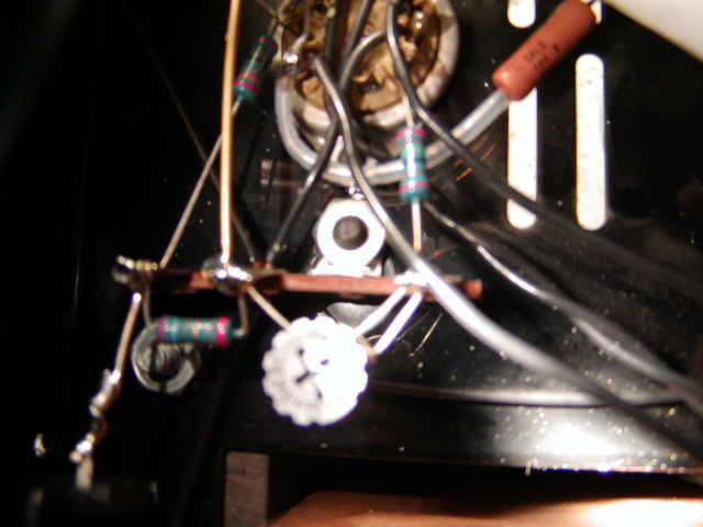

The part is air hung(floating) one side of the two leads is attached to the 8ohm output terminal and the other lead goes thru a resistor to ground, at the point where it hits the resistor it also goes thru a resistor to the cathode (pin 3) of the input tube.
Scratching my head and reaching for a bottle of JD.
Joe
Frank
Enclosed is picture showing lead of caddock resistor, pot, and so forth.
The rather blurred image shows one lead(left of screw)as caddock resistor lead. The gold lead is a hidden 18K resistor going to the cathode of tube #2. The resistor (horizontal ) measures as a 25ohm in circuit. The other lead at the junction of the 18K and the 25ohm resistor is a 233ohm going to pin3 of this tube.
Going for another drink.
Joe

Hi Joe,
It's a wild guess...this caddock resistor is connected to a split cathode resistor at the input tubes' cathode,sharing a fixed resistor (the coloured one,and then the little pot).
Now that pot would serve to set the input sensitivity of the input stage.(grid bias.)
It's just a guess,I may be off.
Mike Sanders is going to hate me for all that guesswork...

Joe,
How are the input tubes heated?AC?DC? And if DC how is it done?
Cheers,😉

Quicksilver Mods
They are heated from the Tap of the PSU tranny. 6.3VAC. The days of rectifying for the heaters are gone for the most part. Too many issues. Diodes into the tubes So, yes they are AC heated.
The heater pin has a green wire going back to the PSU tranny.
