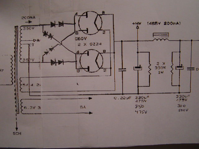

Thats what is in there now to my surprise. Note the size of the caps in the supply.
I think I'll pull the diodes out of the circuit. What would you do?
I did listen to it with the diodes in circuit. I haven't heard it in stock form yet.
Joe
Joe

Hi Joe,
No,the mod is O.K.
Best of both worlds really.
I'd leave it at that,it's a clever little trick.
Cheers,😉
Hi Joe,
No,the mod is O.K.
Cheers,😉
Joe,
IMO the fact that there is a tube rectifier in series with the silicon diodes, will nullify any alleged nasties they might produce.
I also think the tube rectifiers will have a short life with those cap values.

Not to worry,the GZ34s won't suffer.
In the original unmodified circuits the pair of GZ34s had to carry a load of 330 microF.
A single GZ34 for is rated to sustain 100microF at the cathode.
Very high for a tube rect. already.
So what could you do?
Simple,rewire the whole thing and hook up the two 330 microF caps in series after the self.
Ah,but then the whole scheme was altered from CLC to LC.
Not so bright.
Alternatively you could replace the GZ34 with a set of GZ37s,great but expensivissimo.
As it is now,the GZ34s don't care what they see anymore at their end of the PSU.
They conduct fully all the time.
Cleverly they even absorb the diodes peaks.
I can live with that,😉

Are you thinking that it would sound smooth and close to stock sound? The amps aren't hurting for low end as a matter of fact they hit harder than my SAE X-25A with 250watts per channel.
Joe

Joe,
Your modded unit would give a stock unit a run for its' money in the bass department.
Let's put it this way:I couldn't have come up with a better sollution on any account.
Wallow in the bass Joe,I know it must be a killer,😉
