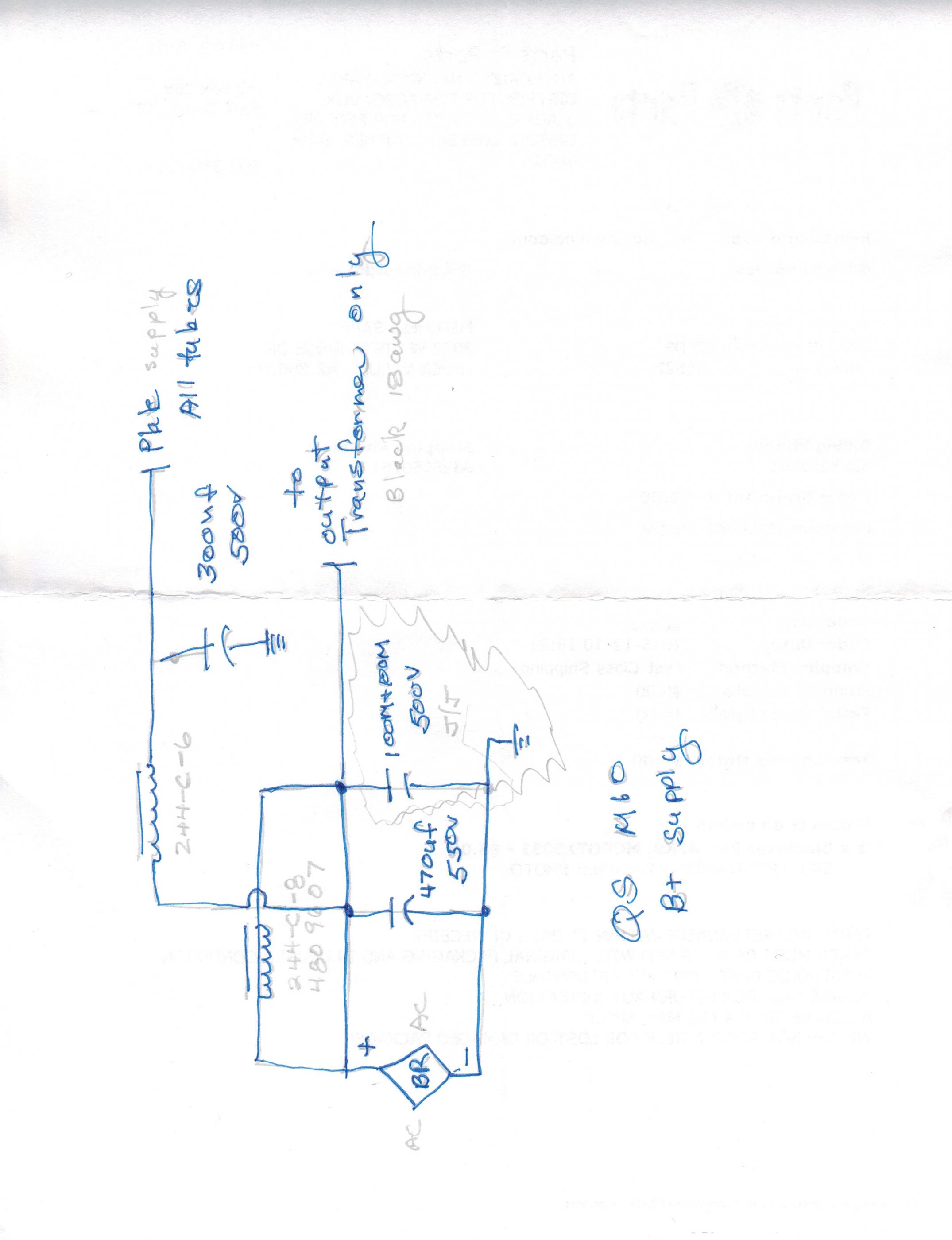

My M60 is blowing the 2a slo-blo fuse. This PS uses a bridge rectifier coupled to 470uf cap. It also appears that a previous owner added another 250uf in parallel. Anyway this goes to a choke marked 244-C-8 which supplies B+ to output EL34s. This choke is showing less than 1 ohm resistance. Does anyone have specs for this choke? The amps have a second choke marked 244-C-6 which is showing 200 ohms and appears to supply the driver stage B+.

After further review, I have made a sketch of the power supply. The 100M+100M cap appears to be a modification using a guitar amp cap. I would like to verify this and confirm the original design of the power supply so I can remove the cap. Thanks

Dude… the "...–8" inductor is shorted out (dysfunctional) in the diagram. You could just use a PAIR of bridge rectifiers you know, and build one B+ supply for the final, and another one for the other plates (to decouple them from the final). Bridges are cheap, cheap, cheap, you know, and the simplicity of doing it that way makes cute little errors like this … really improbable.
Or if you're looking for the purity of not having some of the components in parallel, why not just use a pair of series diodes connected to the + terminal of the bridge, to guide power to a pair of B+ caps, one for the finals, one for the others, EACH thru an inductor, etc.? The diodes nominally will drop voltage only 1.5 to 2 volts (i.e. “nothing to worry about”), yet they do a stellar job protecting the cap-draining-audio-pulses on the finals from impacting the other supply chain. And vice versa.

Thanks. I knew the choke was bypassed (shorted). This looked to be a non-oem mod. I am not the original owner and was not sure how the amp was designed.
Anyway per Quicksilver I have removed the bypass around the choke and will give this a try. Meanwhile I will digest the rest of your response. I am a solid state guy and this is my first dive into tubes. The power supply as now, is the same as solid state other than the choke and fairly low capacitance.

It's actually a pretty massive amount of capacitance considering the voltages.
