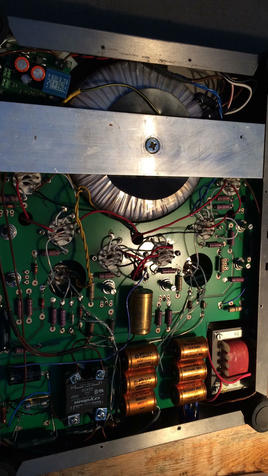

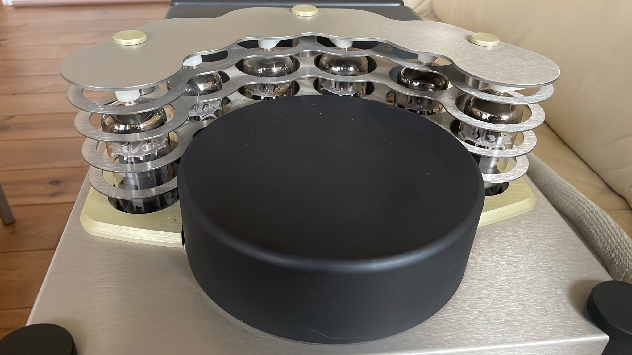

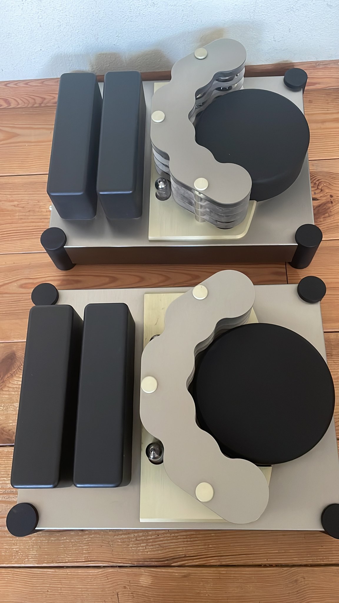

Zotl for me is the elegant replacement. You can argue about the name and technology used (solid state devices plus transformers etc.) but once heard it is obvious an OTL by audio signature. It has all the holographics and air that we all love about the OTL. It is complex by nature so maybe not a diy’rs dream (more of a nightmare). But it is rewarding if you have a working prototype. Standard OTL look easy but are far from it especially when dealing with oscillations and high current loops etc.
