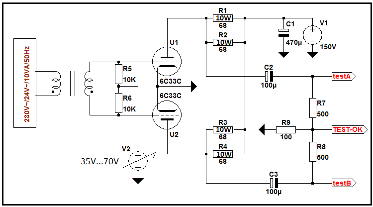

I also intend to buid a dynamic matching tester as attached schematics. Do you think it shall be useful?
It depends how much time and money you want to spend on matching the tubes, think about how many tubes you need to go through to have a matched pair... It might be easier to just purchase matched sets, or modify the bias network, so you can at least adjust the idling bias for each tube and rely on NFB to correct the mis-match in gm.

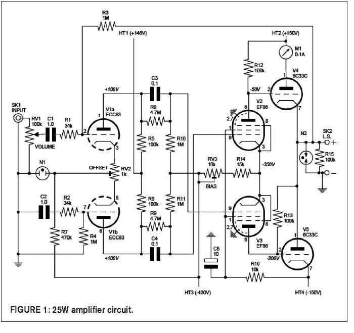

Could you please post the schematic? I think there are several versions of the Mellow’s OTL out there.

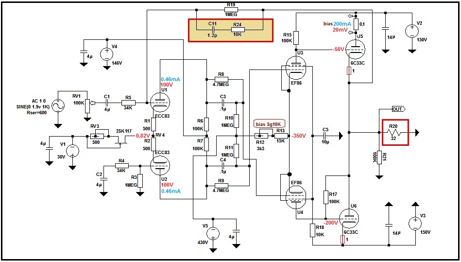

Here you are the original Tim schematics as well as what I have changed (separated PSU, CCS first stage, 32 ohms out for my ESL6with 23 ohms imput trafo modified)Could you please post the schematic? I think there are several versions of the Mellow’s OTL out there.

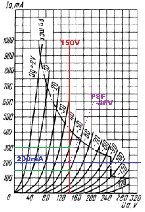

I arranged the model around the PSF where the amplifier works (Ua = 150V, Ia = 200mA, Ug results -46V)
In this area centered on 150V, I can not get gm> 15mA / V
In fact, on the test bench I got at 140V (as I have a smaller transformer and does not carry) with Ug = -46V and Ug = -50V the worst gm was 6mA / v and the best 12mA / V. most values ranged from 8.7 to 11.2 mA/V
I think you should be able to adjust the idle current of the output tubes using the Bias and the Offset pots (as shown in Mellow's schematic).

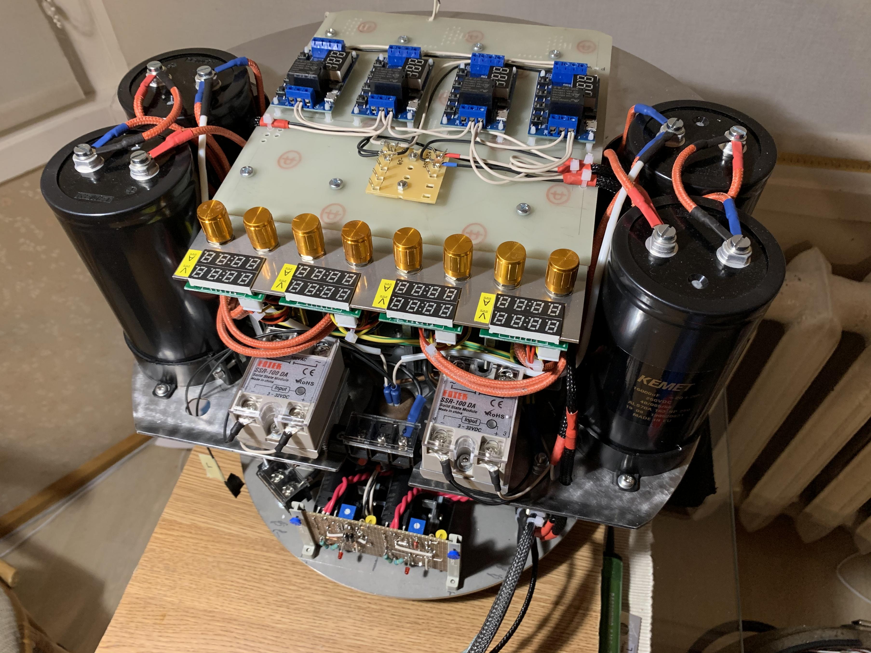

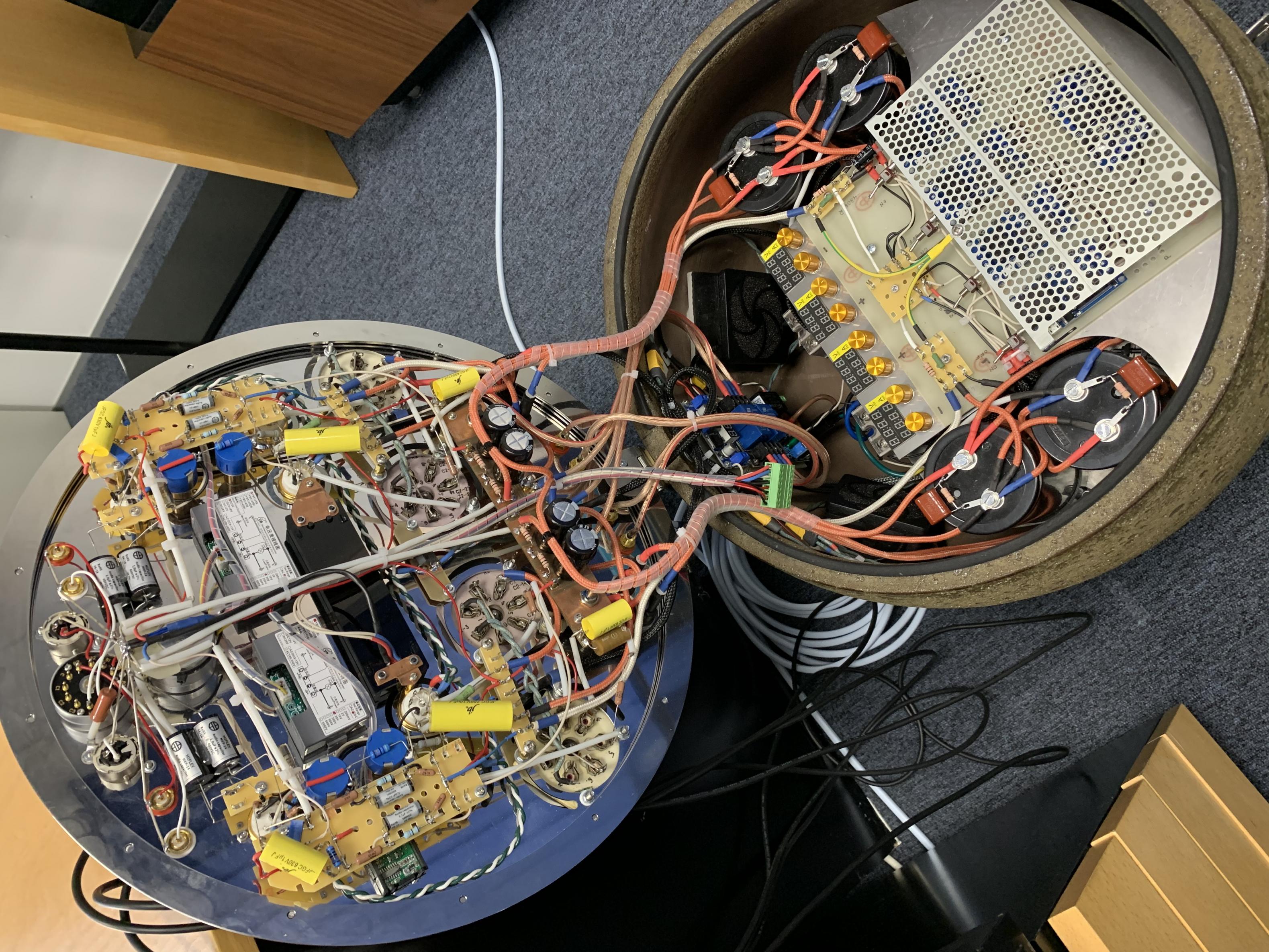

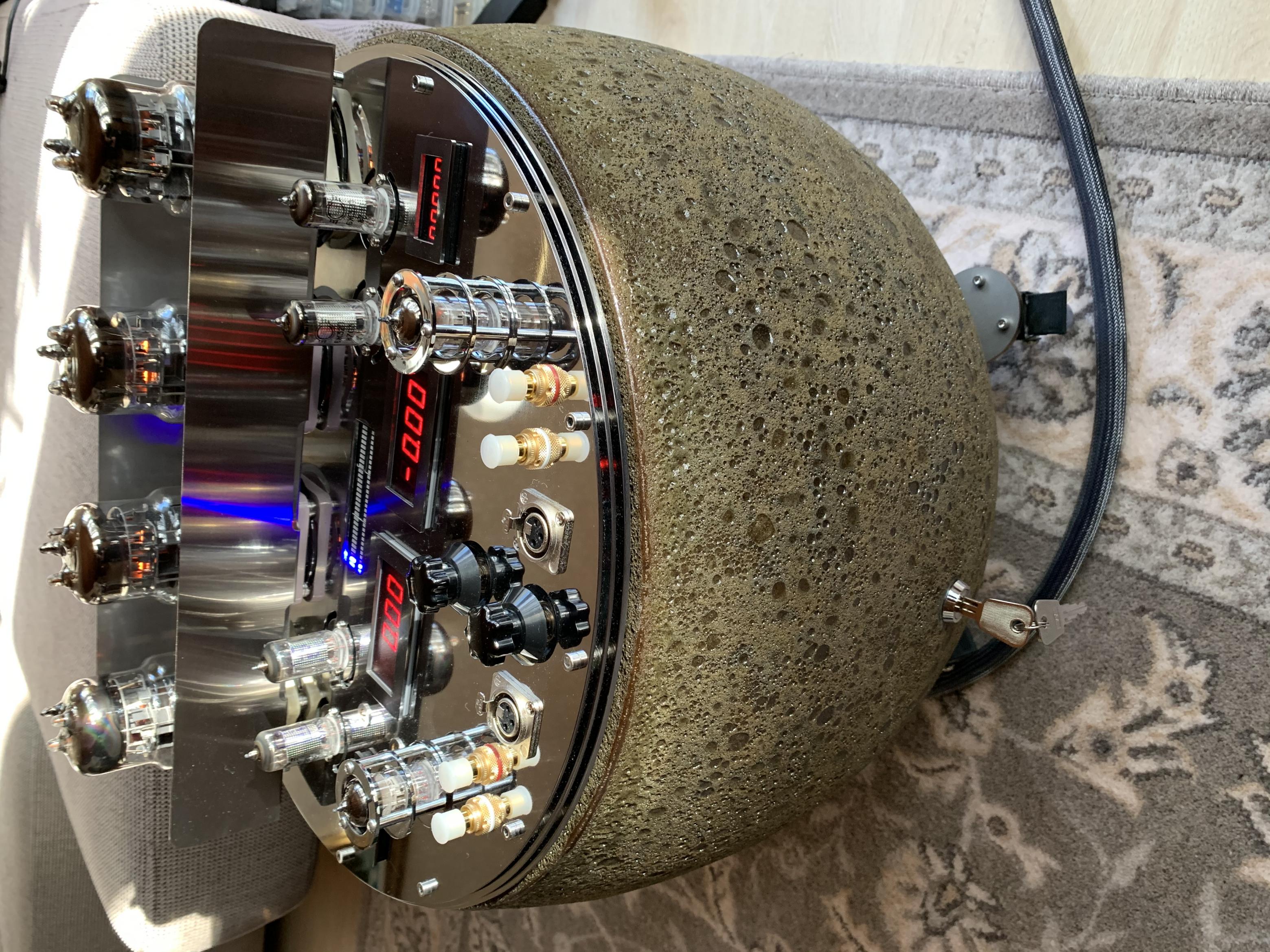

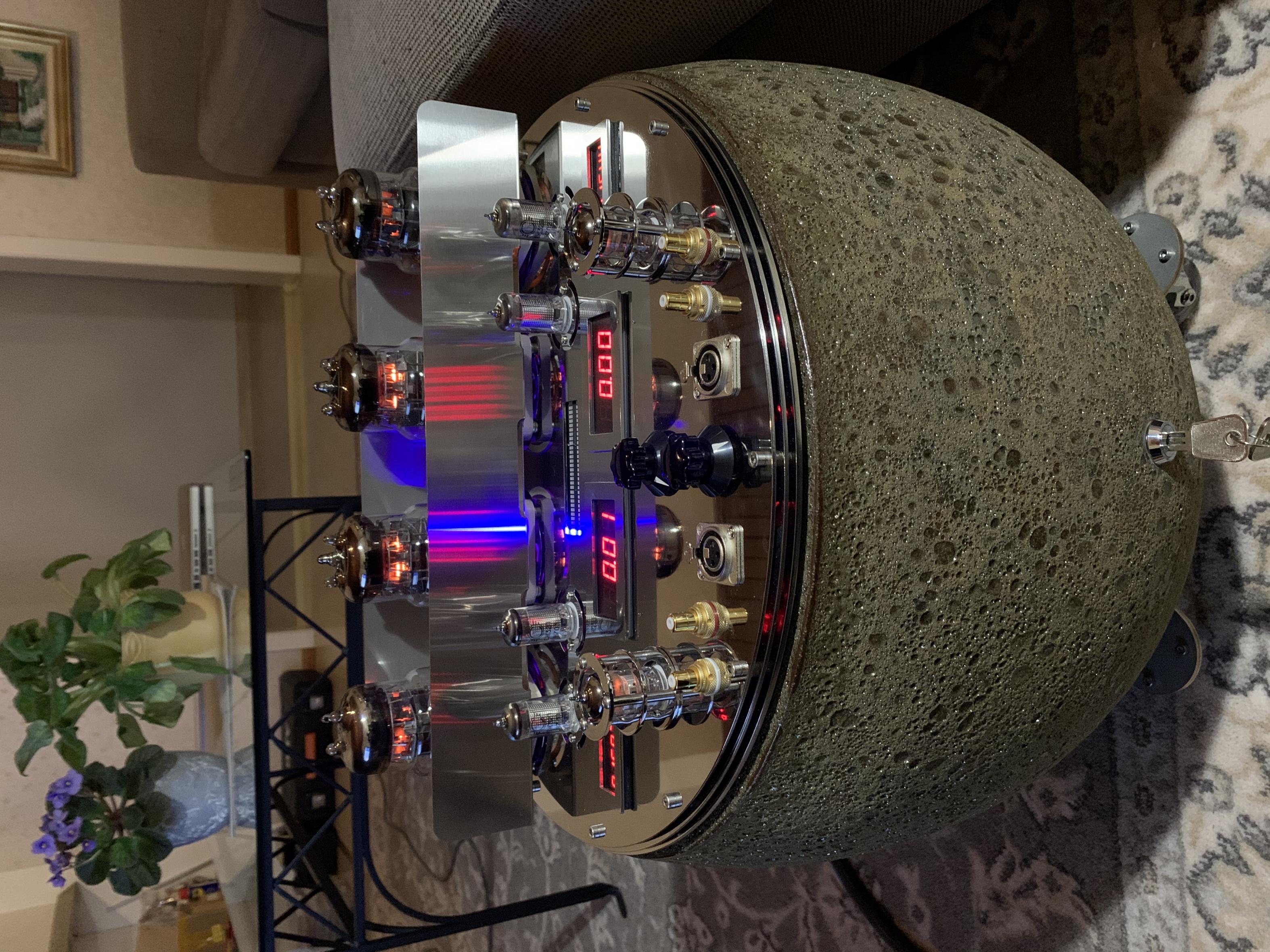

I finished mine just before year end when the heating session starts 🙂
I used 1:1 amp solution from Mellow schematics but power plant is totally different. +/-150 rails are coming from four (two per channel) SMPS (adjustable from 0 to 160V/3A - from Aliexpress), 2x16000mkF per channel,
one common 6,3V SMPS for pre stages heating. One 24V SMPS for general use (timers a.s.o). 2x280V linear regulated supply for BIASing - extending -150V rail - both channels separated and 4x5V linear regulated and separated supplies for indicators (VU and DC0 and 2xIA). Switching ON will happen in four steps with timers. Oops - forgot - output stages heated 24Vac i.e. both tubes in one channel in series, channels in parallel - one 210VA toroidal tranny can handle the business.
Result: extremely satisfying. Amp is dead quiet with huge headroom and
dynamics. FR - from... to... You don´t need more...
Tubes: 6C33C, 6J32P and 6N2P
Tried also ECC83 but it sounds a bit "crispy" for me as well as 6N2P-EV´s...
Just for fun couple of pics also!
