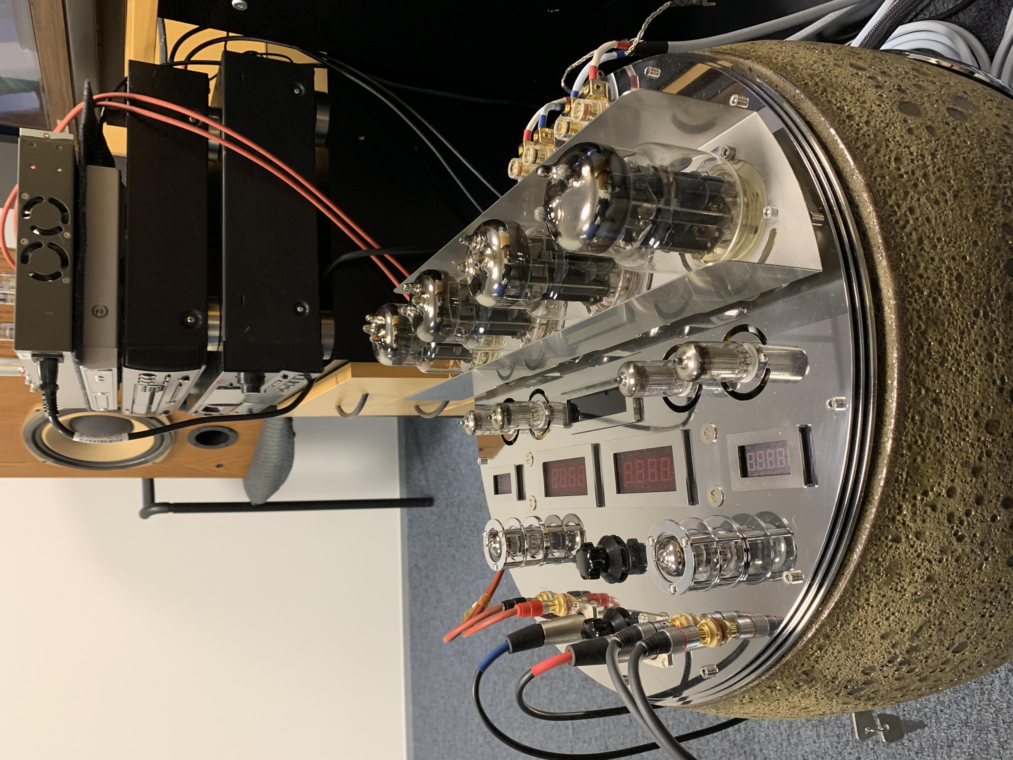

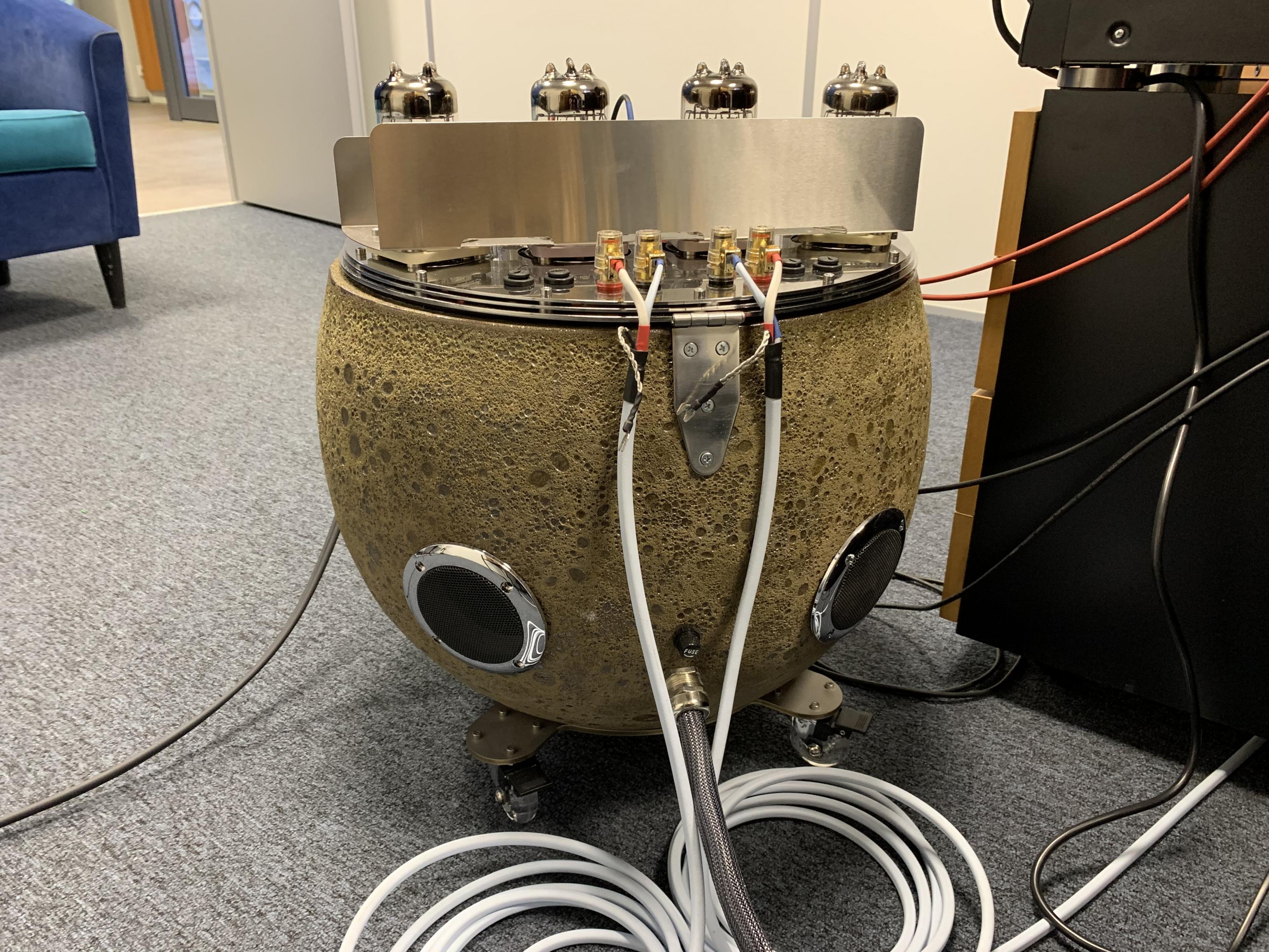

Is there any reason you put kind of a screening between the small signal tubes and the big ones ? Do the 6C33C-B-s emit some kind of "radiation" the smaller tubes would otherwise hear ?

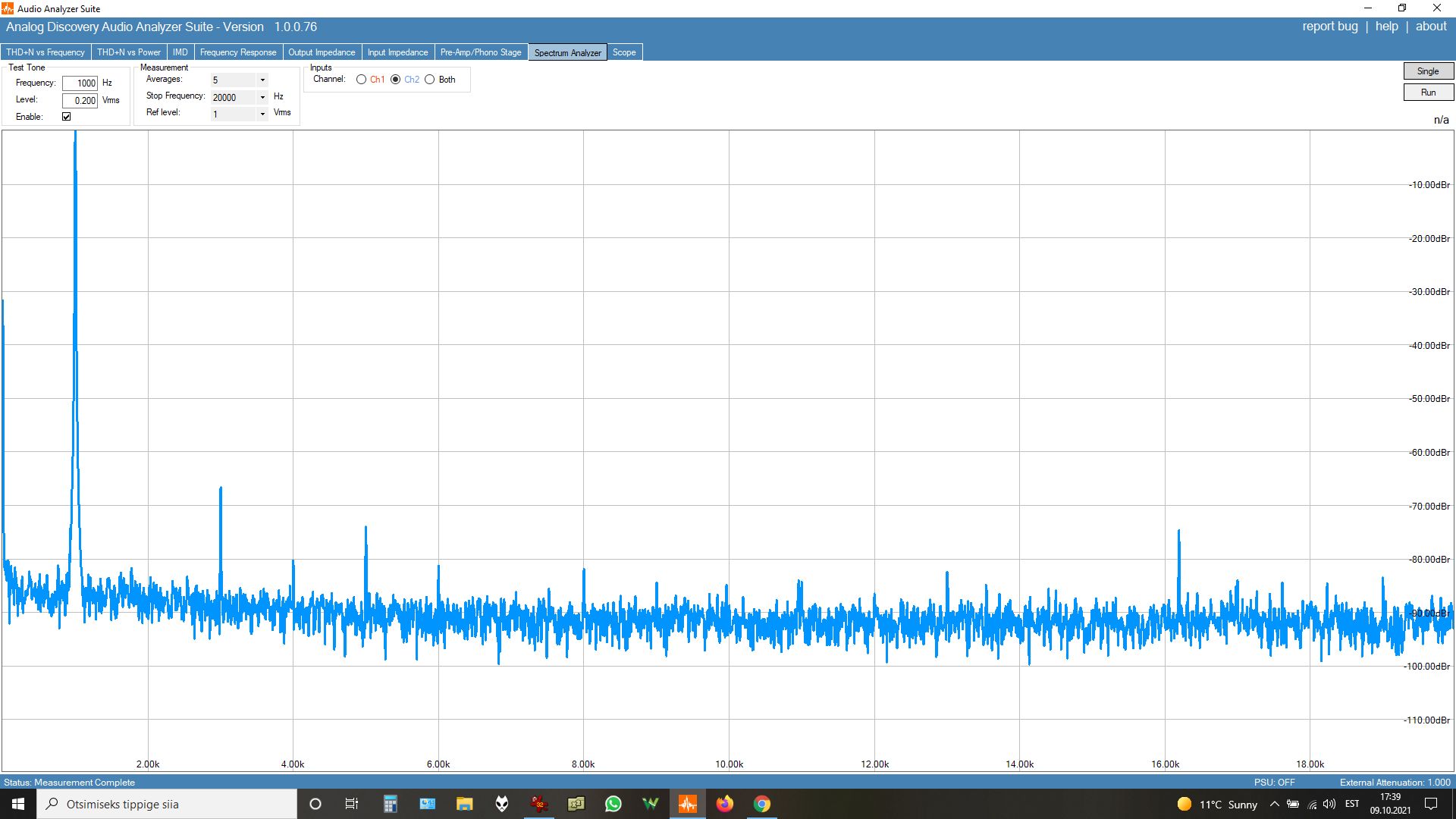

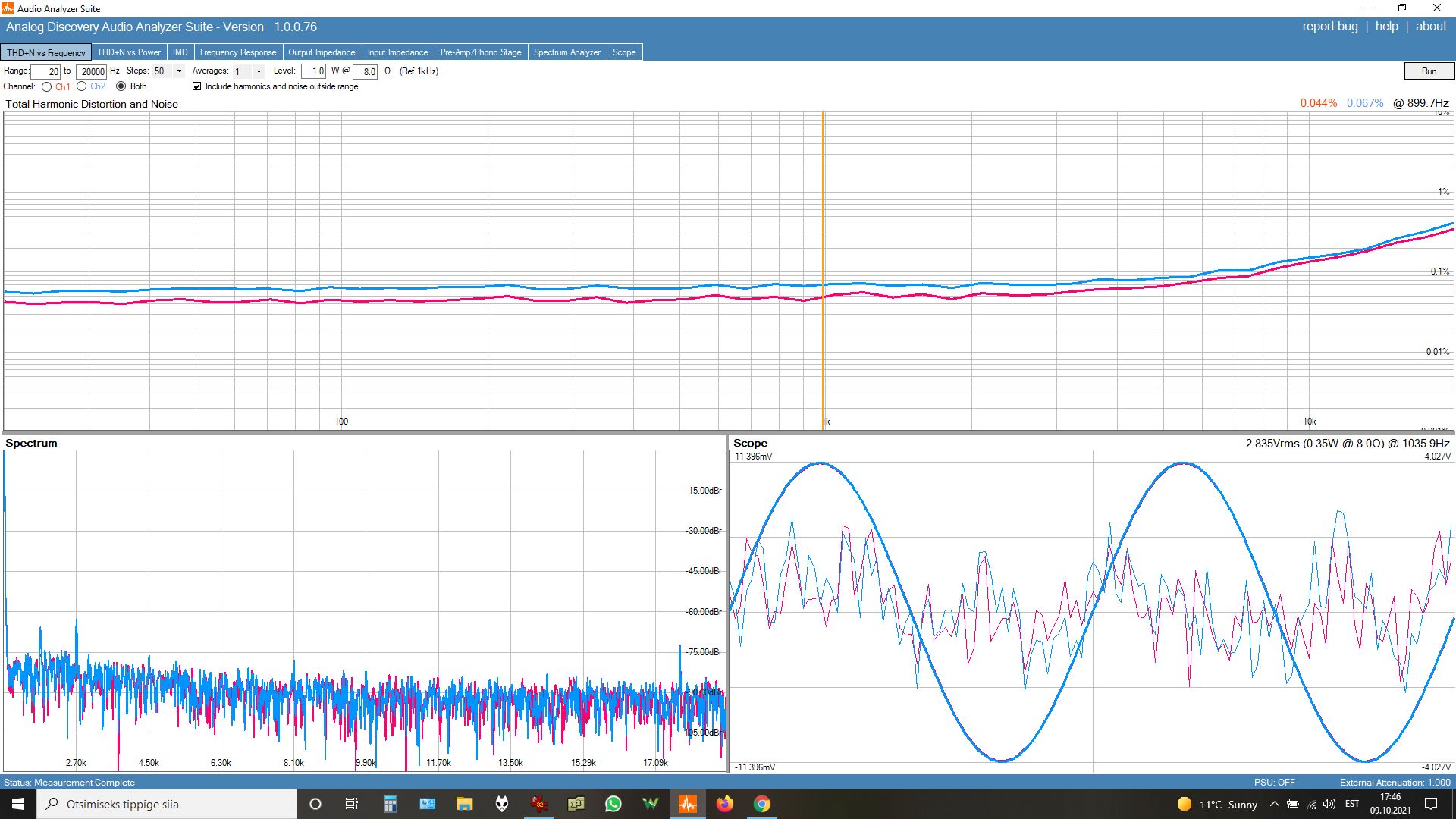

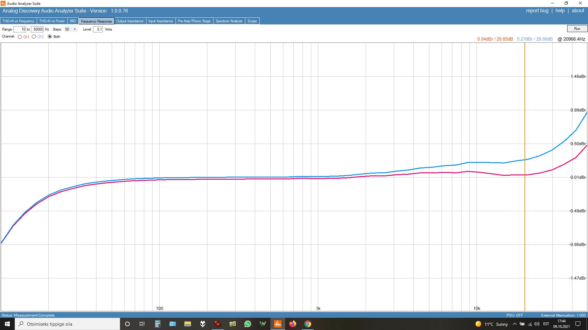

Given ripple is 100mV which is good enough for this voltage.
The reason of the screen was just to protect the upper surface of the amp from excessive heat generated by 6C33 because the heat released is passing away mostly through the thermal radiation (50-60W per tube!). I was scared a bit not to install this screen too close to the tubes because it will cause a thermal mirror and possible "thermal runaway" for 6C33´s. Fortunately I left enough distance between tubes and screen and no problem occured even with full power. But definitely keep at least 5cm in between tubes, otherwise You can face trouble with overheating and thermal unstability. I have also installed two fans (look at back side) 24Vdc running at 13Vdc to lower the noise created. This will grant the air exchange for the power plant. Temperature inside the "Rolling Stone" in normal working condition is 35-38 degC. Some pics with closer look as well.
