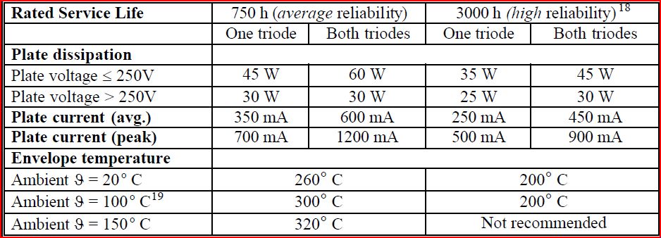

There is something puzzeling me (happens from time to time 😀 ) Tim Mellow states, The obvious choice of output tube was the Russian designed 6C33C triode, because a single pair can deliver 2.5A into an 8Ω load from a moderate 150V rail. This enables the amplifier to deliver 25W into an 8Ω load or 40W into a 16Ω load But the data say otherwise

I don't think it quite hits the 25W mark. In my SPICE simulations, the waveform starts being visibly clipped at about 10.7Vpk output.
Tim Mellow's figures are pretty accurate; the data sheet understates the peak current capabilities of the 6C33C. And although obviously one would not want to be "pushing the envelope" to such an extent for long periods, there are a couple of things that help to mitigate the "abuse" of the tube:
Firstly, even if one were running a continuous sine wave signal at 25W into an 8 ohm load, each tube is only called upon to pass that sort of heavy current for one half of the sinwewave cycle; one tube is conducting during the upper half of each cycle and non-conducting during the lower half, and vice versa for the other tube. What really counts is what the power dissipation in a given tube averages out to over the course of a *complete* cycle, and that complete cycle includes a half cycle with essentially no power dissipation at all. So although outputting 25W into 8 ohms would certainly exceed the stated maximum power dissipation of the 6C33C by a significant factor, it is not grotesquely more. And the 6C33C is a pretty rugged tube. Of course it is not advisable to run 25W into an 8 ohm load for more than a rather brief period of time.
The other point is that in practice one's listening does not consist of extended periods of listeming to a sinewave at 25W. In normal usage lsitening to music, the power output will only very intermittently be reaching the 25W regime, and so this will mean the time-averaged power dissipation will be much less than that for a continuous 25W sinewave.
I have made measurements on my amplifier and found I could reach almost exactly 25W rms into an 8 ohm dummy load, just at the point where clipping began. (I think Spice simulations are not very trustworthy when "pushing the envelope," since they would be critically dependent on the details of the modelling of the tube characteristics in the high-current regime where no very good data are published.) I only kept the level at 25W for the few seconds necessary for making the measurements.

In fact you would need 20V peak for 25W into 8 ohms. As per my previous posting, I suspect your Spice simulation is considerably underestimating the capabilities of the 6C33C, because the modelling of its characteristics at high plate current is not good. My actual measurements on my amplifier were almost exactly in line with 25W at clipping.
I tracked down a calculation I had presented on another forum a while ago, for the power dissipation in each 6C33C when running at 25W into 8 ohms. It's a bit of a crude estimate, but I think it is in the right ballpark:
"Here is an estimate of the average power dissipation in each 6C33C output tube when the OTL amplifier is delivering 25W into an 8 ohm load. In this calculation, I assume the supply rails are +/- 150V. Let us consider the upper 6C33C tube, whose anode voltage is therefore +150V. It will be conducting and dissipating power during the upper half of the sinewave, and essentially non-conducting during the negative half. The discussion for the lower tube will be analogous.
For a sinewave at angular frequency w, the current will be I = (5/2) Sin(w t) during the positive half, i.e. 0 < t < Pi/w, and the voltage on the cathode will be 20 Sin(w t), since 25W into 8 ohms means a peak voltage of 20V. Therefore the anode to cathode voltage is V = (150 - 20 Sin(w t)) and so the instantaneous power dissipation is
P = I V = (5/2) Sin(w t)(150 - 20 Sin(wt)).
Integrating this over the positive half of the cycle (0 < t < Pi/w), and adding zero for the negative half cycle, gives the total dissipative energy in the upper tube per cycle. Dividing by the period (2 Pi/w) then gives the average power dissipation in the tube; it comes out to be 25(30-Pi)/(2Pi) which is about 107W. This is indeed considerably more than the rated maximum dissipation of 60W, but it is not astronomically more. Tubes, unlike transistors, don't typically fail catastrophically if pushed a bit beyond their limits. And in practice, when used for listening to music rather than running continuously at 25W sinewave into 8 ohms, so that the amplifier is only intermittently being called upon to output the full 25W, the tubes seem to last pretty well, for a good few years."
