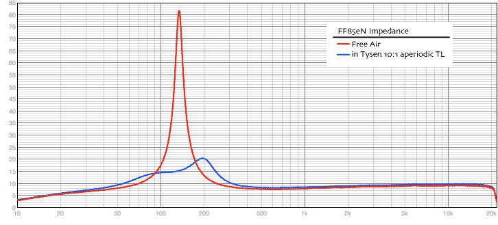

Series resistance does that, so while you might increase the amount of bass, you are messing up the transient response.
Series R increases the Q of the loudspeaker. If the speaker starts out with an overdamped Q you want to increase it to optimal.
This is often how a high efficiency FR is designed. With a high R amp (typified by SE 2A3/300B), and horn loaded speakers, one can get decent LF at high efficencies with excellent transient response.
Every FR driver I have ever heard does need help from a tweeter, or a "super tweeter"
Then you have not heard a wide enuff range of FRs.
But there are quite a few that are missing an octave or 2 at the top — FE208e∑ for instance. But it is designed for highish output impedance amplifiers and works just fine with the tweeters (>5kHz) desiged to be used with them.
Usually the biggest deficit is as the bottom, and with some FRs one has to live with limited bass, add multiple (sub)woofers as advocated by Geddes and Toole (amounst others), go to elaborate horns or other biggish enclosures. But it is possible to get good response from 25-20k out of some of them.
Better top usually comes with the smaller FRs (3/4”) but limited cone size leads one to a system such as Geddes/Toole above or a WAW (Woofer Assisted Widerange). XOs are usually line level and at a freuency low enuff to avoid many of the “evils” of XOs. One can use a lowR amp to drive the woofers and their box, and given the FR is used where the impedance is flat, one can take advantage of what a highR amp brings. Furthe one can load the midTweeter in a box that works to eliminate any time smear from stuff coming back thru the cone and at the same time flatten the impedance bump at the bottom.

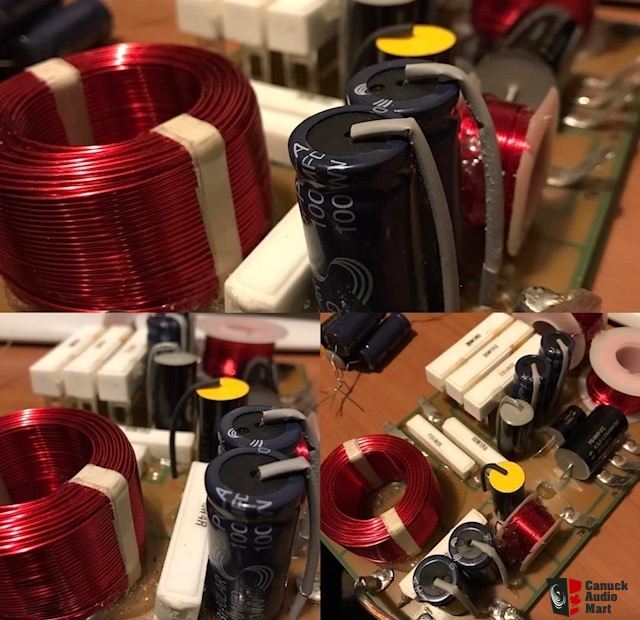

PSB Stratus Gold speakers
Those are the ones i was thinking of, these ones?
2 set sof measurements findable.
PSB Stratus Gold loudspeaker 1991 Measurements | Stereophile.com
PSB Stratus Gold loudspeaker 1997 Measurements | Stereophile.com
Neither have a well behaved impedance so would require a low impedance amplifier. And given the nasty phase angles able to deliver a lot of current.
I found an XO map here: PSB Stratus gold X-over help
A singlre series inductor with a Zobel across the woofer. PSB says 250 hz XO. Text book would be about 2.5 mH.
Madisound has 19 g (0.95Ω), 16 g (0.59Ω) or a Solen (.36 Ω). From the only picture i found of the XO the Solen looks to be the closer match.
