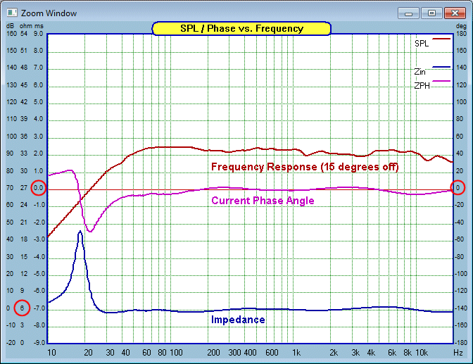

I only need a counterexample to show that is wrong. Here the impedance of a 2-way speaker in a BR enclosure)
attachment.php
But i do not think that is the case here. What i think is that depending on the speakers end up being, that some amount of extra R or higher output on the amp can complement the speaker impedance and improve the range. It uses regulat woofers and tweeter.
