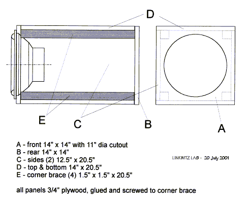

you can see that he is not real big on building cabinets with stiff walls.

Nah, the resonance frequency of Balic Birch panels that size would be WAY above 20 Hz.Second, there is a real possibility that the higher distortion seen in SL's measurement could be the results of the woofer box walls flexing.
Wall flexing at those frequencies doesn't necessarily mean that they are resonating at those frequencies.Nah, the resonance frequency of Balic Birch panels that size would be WAY above 20 Hz.

Here is a figure showing some additional simulations.
In all cases the excursion is the same. Air compliance is correctly modeled. Suspension compliance is a model with function that is symmetric and nominally constant for smaller excursions but then decreases at the specified Xmax is approached or exceeded. For the parameters used we see that air introduced both odd and even order distortion. The suspension can only introduce odd order distortion since it is symmetric. Note the interesting effect that when both the air spring and the suspension compliance are included 2nd order distortion is reduced compare to air spring alone, but all other distortion components increase. BL nonlinearity in not include.
The box size and excursion were intentionally chosen so that the air spring would exhibit significant distortion. Other parameter choices can yield very different results. I don't think it is possible to make a general statement when dealing with small boxes and high excursion woofer.
Aside from the additional effect of BL nonlinearity, dlr indicated what I meant by wall flexing. The walls need no be resonating but simply flexing under the pressure forces. Under static conditions the flexing may result in a linear stress/strain relationship, but under dynamic and/or oscillatory conditions the relationship could well be nonlinear.

Thanks John,Here is a figure showing some additional simulations.
