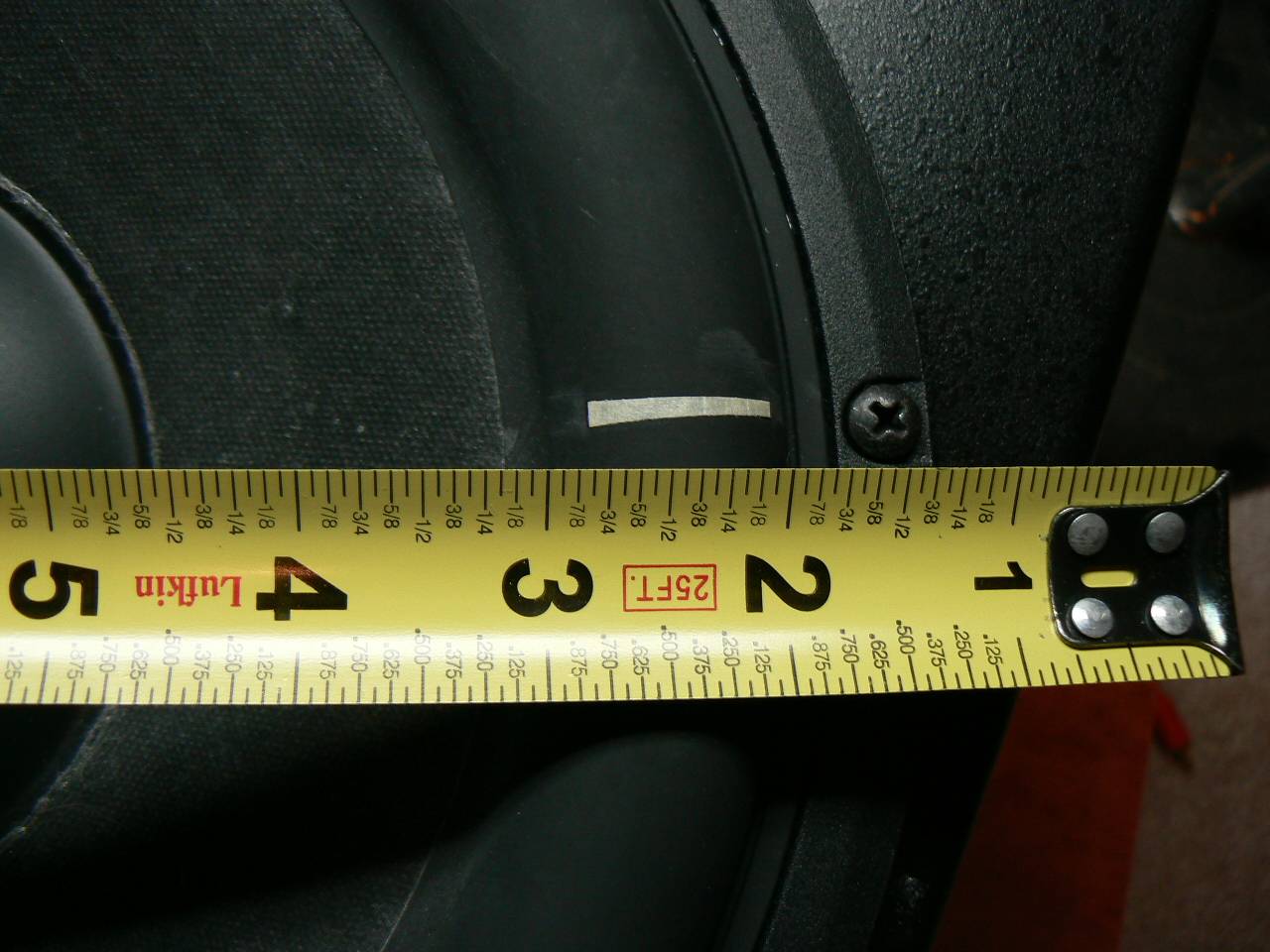

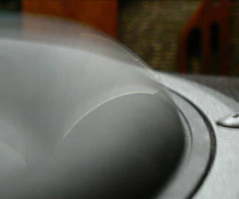

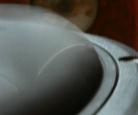

I repeated the linkwitz distortion measurements on my Peerless XLS 12" driver. With a 1" stroke @ 20Hz I saw essentially the same behavior:
When put in a smallish sealed box, the 2nd order distortion doubled, 3rd order tripled.
In car audio, large woofers are often put in very small boxes and then driven at high power. If the surrounds and cones aren't stiff enough, bad sounding things happen. In some cases I have even seen (with the help of a strobe-light) the surround invert on a cycle by cycle basis; cone goes up-surround gets sucked down, cone goes down-surround gets blown up. You can also often see(with strobe-light) the edges of the paper and thin plastic cones flexing away from the direction of cone motion.
I got the idea that perhaps a large portion of the distortion increase with the 12" XLS woofer can be attributed to this type of behavior.
That is, the majority of the distortion increase is coming from the internal box pressure flexing the edge of the cone and distorting the rather large surround. As you can see in the first image, the surround is 1" wide. The cone diameter inside the surround is 9". So, the area of the surround is nearly 50% of the area of the cone. Any nonlinear movements of the surround caused by internal pressure does have considerable radiating area. The cone is a rather soft pulp and not particularly stiff at the edges where it attaches to the surround.
Using a strobe-light I was able to see minor flexing of the cone edge at the peaks of the 1" stroke. It was also evident that the shape of the surround was different depending on whether the woofer was stroking in free air or in an a closed box. In particular, at the peak of the outward motion, the outer third of the surround was flattened, if not slightly concave as the internal pressure is acting to suck it inward. Also, at the peak of the downward motion, the inner third of the surround is noticeably puffed out when in the box while in free air it is pulled basically straight down to the cone edge.
I had no luck getting pics or video of the strobe-light motion. But, I did attach a thin piece of masking tape to the surround to try and highlight the differences I was seeing. The pics aren't the best, but you can get any idea of what I was seeing.
The 1st pic shows the dimensions of the surround and the masking tape stripe.
The 2nd pic is the woofer stroking 1" peak-to-peak in free air
The 3rd pic is the woofer stroking 1" peak-to-peak in sealed box.
Soooo...what to you guys think?
Is this a likely explanation for a major contributor to the rather large rise in distortion when the 12" woofer is placed in a smallish sealed box?

Yes, it is easy to see that when you quickly push the driver in 1/2" and hold it, the surround puffs out slightly just like in the pic, and then slowly relaxes and changes shape over the next 5 seconds or so. I know the internal pressure is causing the surround to distort, I'm not trying to confirm that. You are right though....there may also be some type of resonant behavior.
What I'm wondering about, is how to quantify the resulting amount of 2nd and 3rd acoustic distortion. Is this the major cause of the doubling and tripling of distortion? or just a minor contributor.
