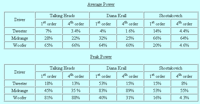

Art Ludwig analyzed 3 music clips in Matlab and simulated crossovers at 300 and 3K, either 1st order or 4th order. There was little peak power going to the tweeter with either Shostakovich or Talking Heads. Diana Krall had a higher percentage but that's not the kind of music you listen to really loud. The numbers assume equal-efficiency drivers and he explains why they don't all add up to 100%.It makes sense to consider the actual power delivered to the driver

Someone smarter than me would need to define a way to derive the amount of dynamic compression from that data.
I think someone already has. It's available on some of the JBL system spec sheets we have over at Lansing Hertage. On some of the newer systems they have a less than .5db power compression spec. @ 100dB. I am assuming that's at 1 meter. It's the only place I have ever seen a power compression limit even mentioned on commercial speakers. I have seen it published on the Pro stuff and the non powered monitors.

Thanks. Given the high crossover point of 3 kHz as opposed to 1 kHz, those number all look reasonable. And by no means is the tweeter sheltered from the power input given the fact that it is far more sensitive than the other two drivers. Its going to be the tweeter that has problems and this is waht all my measurements said. For two-way with a typical 1" tweeter the modulation at 10 kHz was almost 10 dB, but this was far more steady state stuff so that number is high for the more dynamic short term situation.
