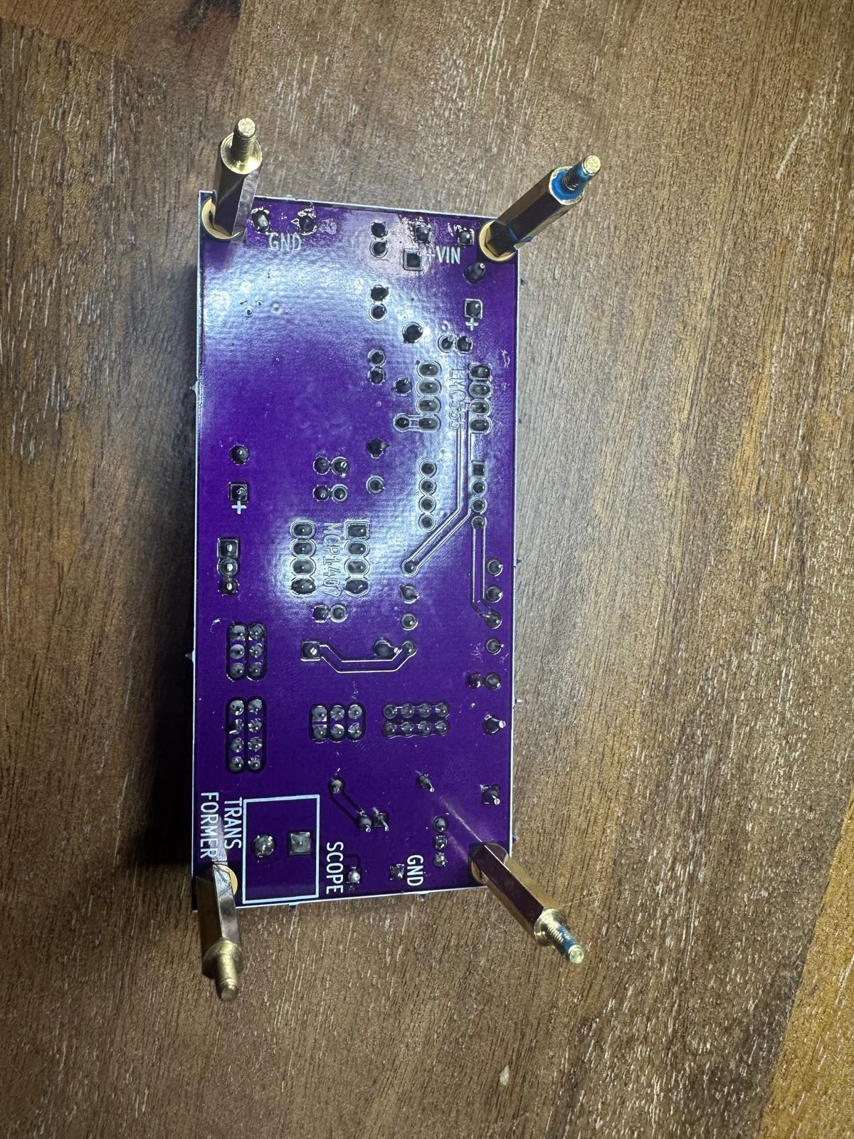

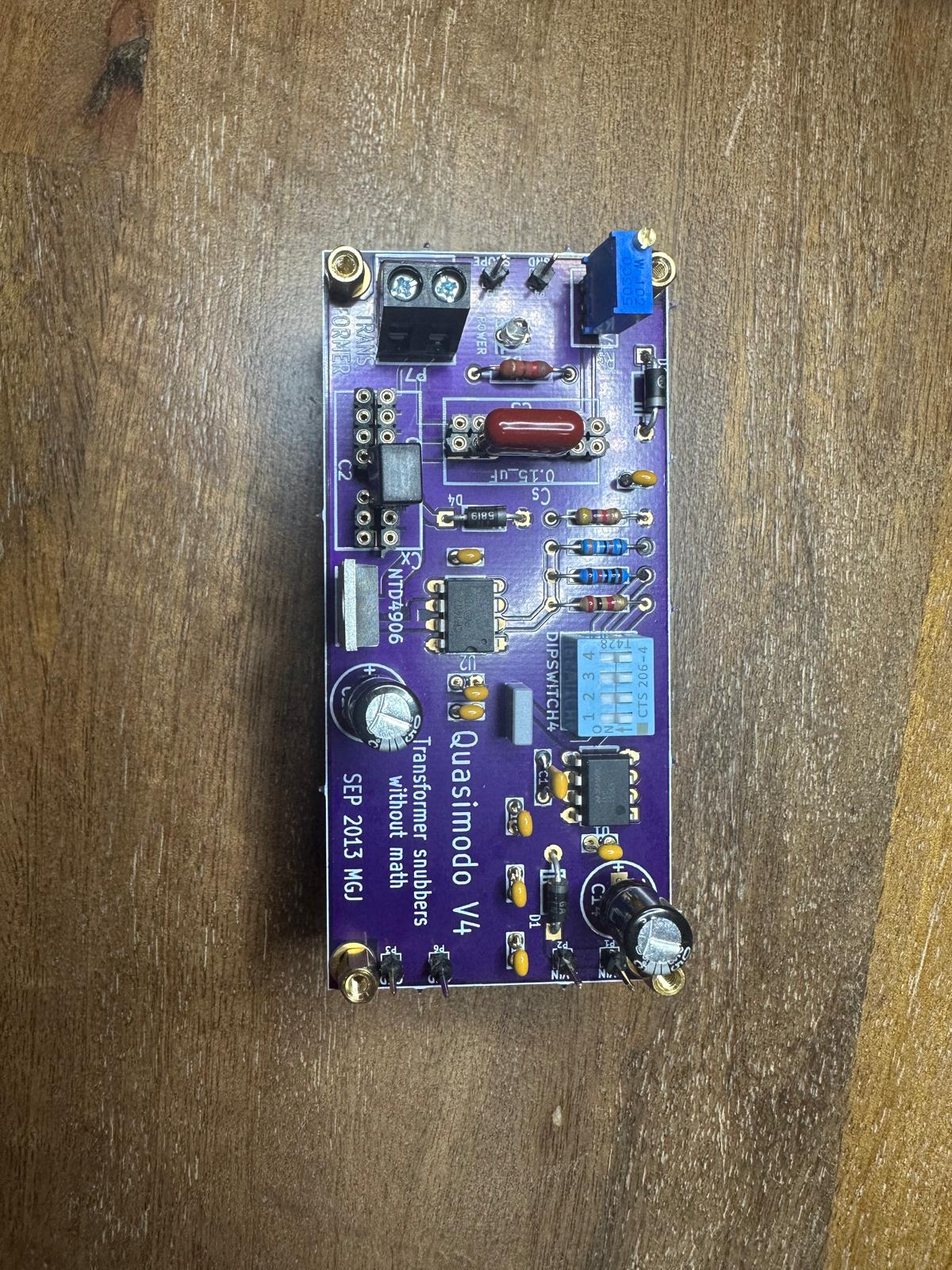

Thanks for so many pointers. Completed my first soldering project the quasimodo test-jig. I calculated Rs and will use that to complete Ubib project. Some of the leads ended up with more solder than needed. Hopefully with practice it'll become better. Also, my solder has lead so i need to get different solder and prolly a small fan for the fumes.

N-T-O, there's no need to get a different solder. Solder has had lead in it for over a century - don't chew on the solder and it won't hurt you. (Seriously, just wash your hands when you're done and don't be eating while you're soldering and you'll be fine. I've been playing with this stuff for nearly fifty years and it hasn't ended me yet.) Leaded solder is much easier to use, and you'll more easily get reliable connections with it. A fan for the flux fumes is fine, but the fumes contain no lead - lead isn't vaporizing unless you're running your iron at over 1749 °C/3180 °F (the boiling point of lead).
All that said, the joints in your photos above look pretty good - as you stated, a few are a bit heavy on the solder, but not terribly so. Your soldering looks good to me, especially given that you're just starting. With practice, you'll develop a feel and get better at it.
-Pat
