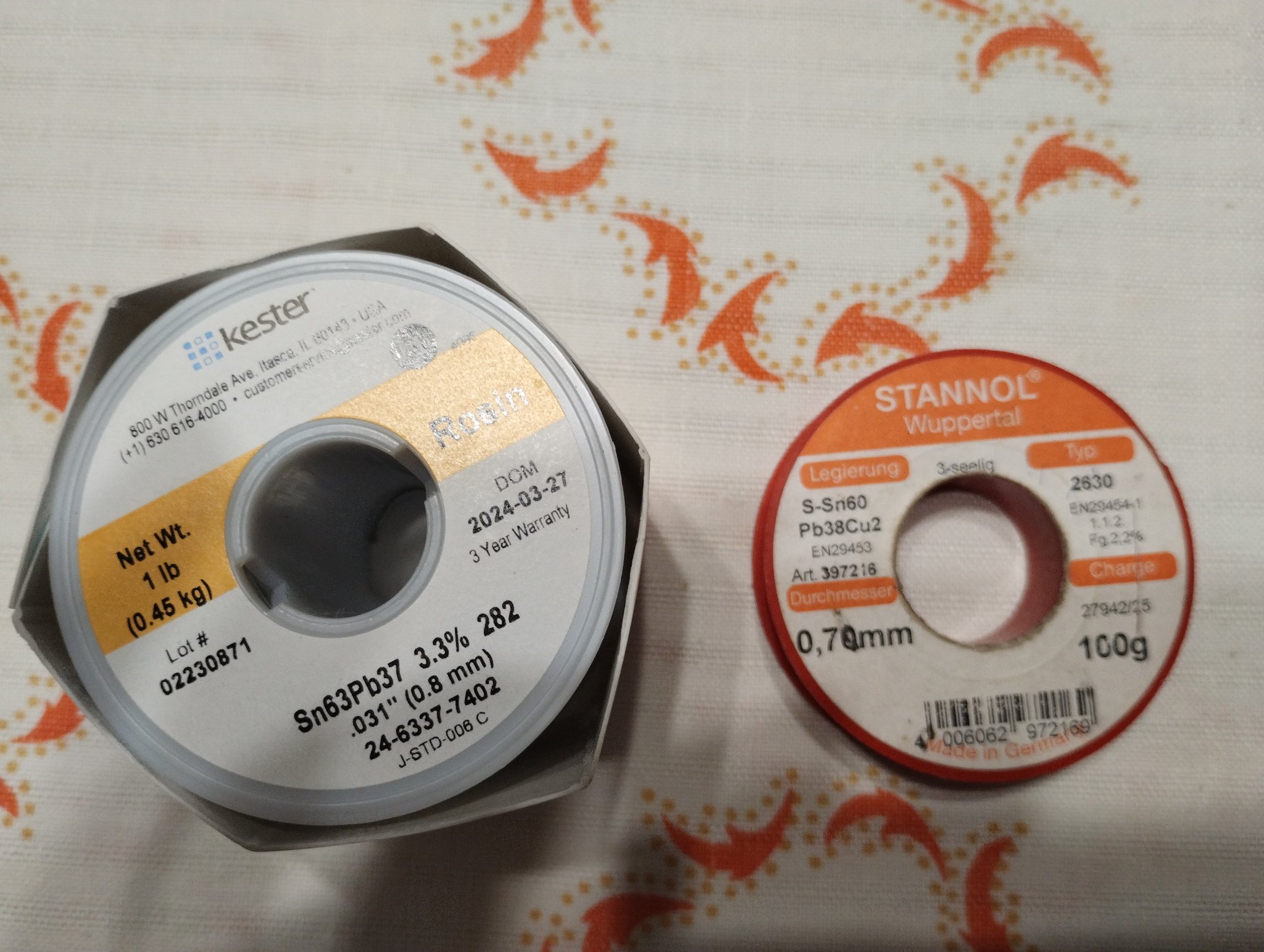

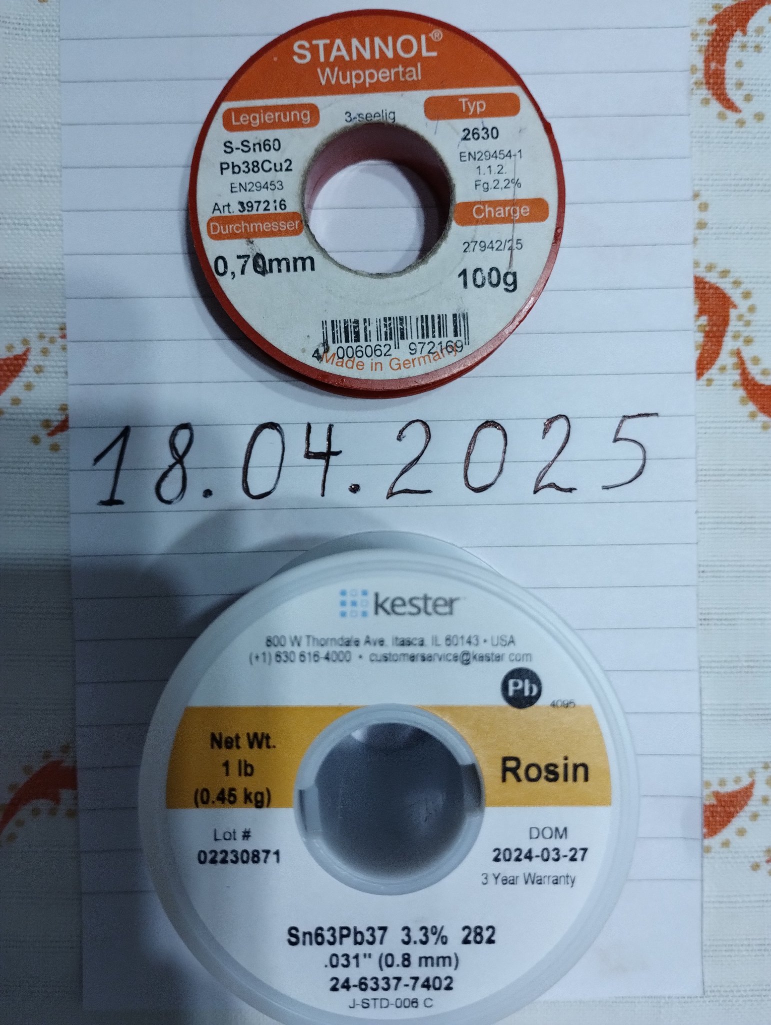

Logon, witty answer, but didn't sound convincing. Is there anything else I should know? OK. I wonder what this means - ''workaround'' #48? Probably ''for those who want to get around the law - village tricks for beginners?'' I look, read aloud and can't believe my ears. Enough nonsense. We've become the laughing stock of the world! Logon Logon, listen carefully and take notes: How to read EU legislation? Ask America's top distributors. The devil is in the details, the truth lies between the lines. So here's the solution /in my experience/: I bought a soldering wire about 1 month ago from DigiKey /Kester 24-6337-7402, €147/. Do DigiKey know the laws, our/EU/laws? Don't doubt. They know what they're doing, trust me. Incoterms DDP, free shipping and so on - the perfect distributor. I've said it before, and I'll say it again: Thank you USA!!!

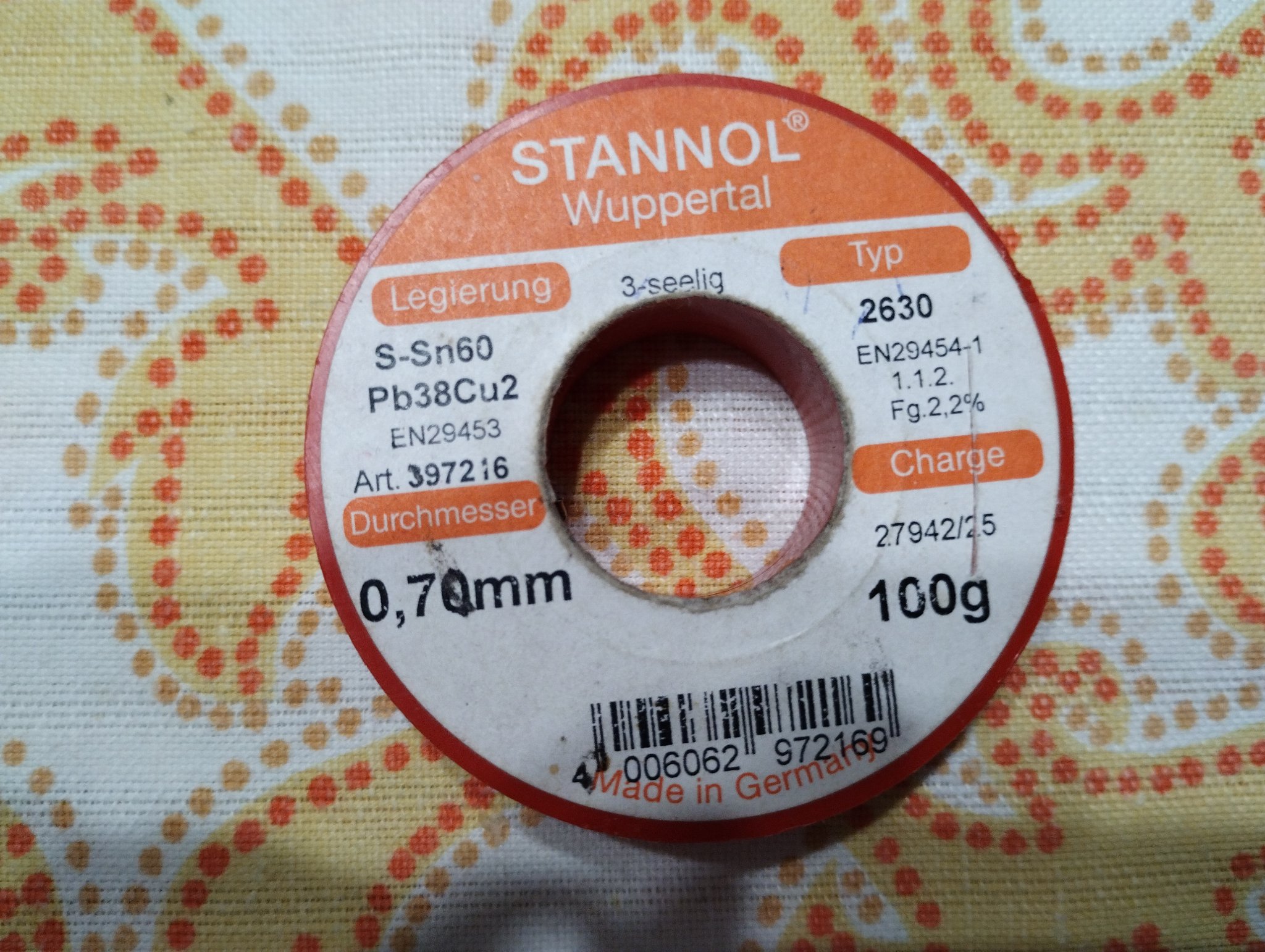

I've spent the better part of two decades /as a hobbyist/ using solder STANNOL-Sn60Pb38Cu2. Excellent product, but it is no longer produced.
I hope you find this information helpful /the EU members/.

Thank you for sharing your experience and I'm sure that what you say makes sense to you, but what I want to highlight is the fact that as you have already been told by more than one other member in EU there is a ban on selling lead-containing solder alloys to non-professional users.
How will they put this into practice and distinguish who is an amateur from who is a professional?
I don't know and I don't care to know.
Did I perhaps say that I am tearing my clothes off because I can't find what I want at the price I want?
No, I didn't say that.
There are such a huge amount of (good) products out there that everyone is spoiled for choice: you are happy with Stannol (and I have some too) I got along well with Cardas and now I get along well with a (good) 60/40 that costs a quarter of the price of Cardas. 😍
P. S.: In my opinion, the fact that even things prohibited for reasons of public health can be "easily" purchased does not exempt anyone from their responsibilities, neither the sellers, nor the popularizers, nor the buyers.
And since this is an international public forum (which must be written in English 😉) that's the only reason I'm not going to share the "workaround" I mentioned and that you still seem so curious about. 🙂

So, lead vs. lead free solder? 180°C vs. 220°C? Dunno - everyone will have to decide for themselves. About ''Buying lead solder'' - I will explain that in explicit, simple, concise and unambiguous detail to make sure it is fully understood:
1. Country selection - USA
2. Distibutor selection - USA /a wide celection of products - lead solder/, in my case DigiKey
3. Order - Incoterms DDP, DDP, DDP, 1000xDDP!!
4. Ship to address
5. CUSTOMS CONTROL: Let me be clear - customs are involved in the implementation and enfocement of EU legislation on inport from non - EU countries. IT'S NOT EASY!
6. Deliver to address
7. Hooray and... don't forget to say ''Thank you BATE VANKO''. I'm joking.
