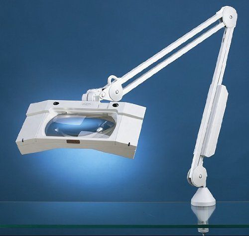

And, as time goes on, the most important soldering tool on my bench is a good magnifier lamp.

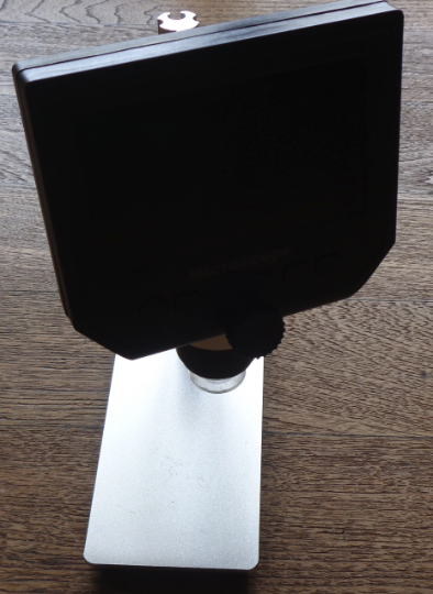

Yeah... You can see my microscope in the left side of the video above. #gettingOldSucks
That said, I use the microscope with SMD parts. My soldering is much better when I use the 'scope than when I try to solder 0603 without it.

Yes I am also using a 10x magnifying glass. The main problem it causes is I’m unsure if I have applied more or less solder. But I guess practice will make it better.And, as time goes on, the most important soldering tool on my bench is a good magnifier lamp.

It's just a personal preference, but when I need a magnified view of what I'm soldering or unsoldering I prefer a pair of normal so-called "reading" glasses which when necessary with as many as 7 diopters are preferable to other means which instead are not very comfortable for me (even if one has to get closer) and I don't need anything else except in rare cases for which I use this.
