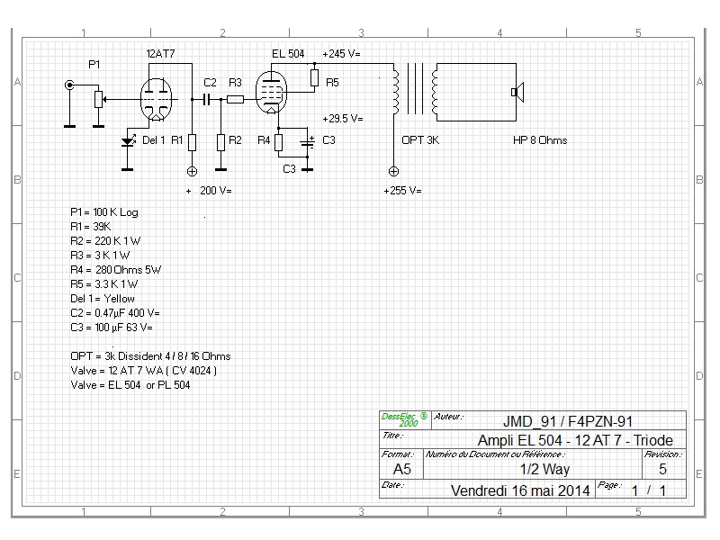

Well not to me it isn't obvious ! Physically, the anode and perhaps g2 are hotter than intended, that's a fact. But by what mechanism that might then translate to reduced life provokes my curiosity. As I posted above, I could think of 4 possible reasons, none of which might actually happen in practice or not a significant extent.....Without going deeply into the process what happens inside the overloaded and red glowing tube, isn't that obvious that the lifetime of such tube is essentially shortened.
I don't mean so hot as be incandescent or cause mechanical changes ! For discussion purposes lets say showing early signs of starting to glow faintly.
@Kevinr AFAIK outgassing from the anode (perhaps g2) is the main cited reason for reduced lifespan following overtemperature. But I'd venture that can only happen once, and quite quickly if at all - ie degradation would be rapid and show up in characteristics one might think - but IME it doesn't ? And yup, tubelabs stuff is hugely entertaining and intriguing IMO !
I'm only mooting intentional overtemperature as an armchair discussion. A valve like an EL36 would seem a lot more 'appliable' if it would tolerate say 20W or 25W anode diss IMO. Small signal valves have higher gm at high Ik too, for example. I'm not advocating, just curious.
Hi JM - yes that seems a good discussion example. I don't know the EL/PL504 triode curves that well, and published curves run out for va=Vg2 =190V AFAIK. But guesstimating that you end up with about -28V bias and so Pa+Pg2 about 21W. Versus design centre spec max 17W. But actually Design Max is 24W, so perhaps that anode doesn't even begin to glow ? I don't wish to seem like tubelabs, but could you sensibly go further I wonder ?

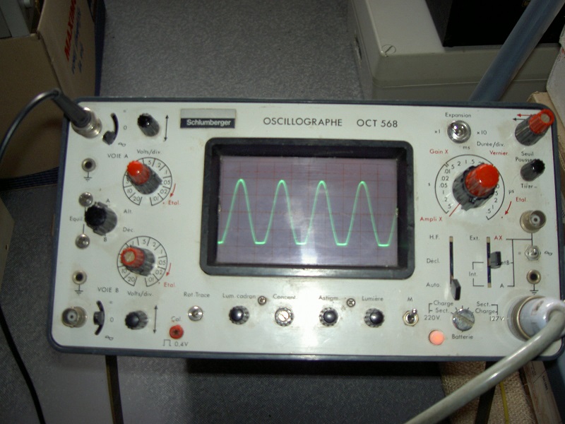

hello ,
i not problèm to risk dead the valve EL / PL 504 ... the OPT is 3 K / 8 Ohms , i tested other valve ... EL 502 !
so good performance and current to cathode is 115 mA in EL 502 vs 100 mA to EL 504 .
i joint the graphic to EL 504 , little distortion
the futur build is UL , so happy build to mixer Triode / Penthode .
