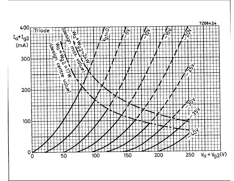

Yes, for the reasons you point out artosalo. But I think JM posted to illustrate how in that case exceeding Pa+Pg2 max was feasible - I think it ends up somewhere between 'design centre max' and 'design max' in that case.I would try to bias the PL504 well below 100 mA.

AFAIK there's no pubished Ik max for 6L6 but I'm sure someone will know, I doubt it's rated for 175mA continuous. Ik max (unlike Pa max) is not something I might be tempted to exceed without expecting lifespan penalty, FWIW. Did you mention you had an EL36, that would do 175mA ?It ain´t working with the low cap values...can´t get low enough..

No. That is too much for one 6L6 and maybe for two tubes too.
Triode connected 6L6/5881 goes to grid current when Ua = 100 V and Ik = 50 mA.
In other words, you must have more than 100 V to be left over the pass tube and then regulation stops when the current is 50 mA or more.

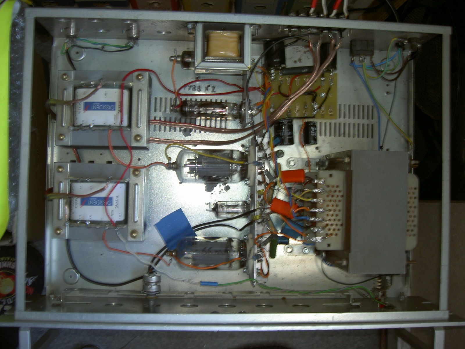

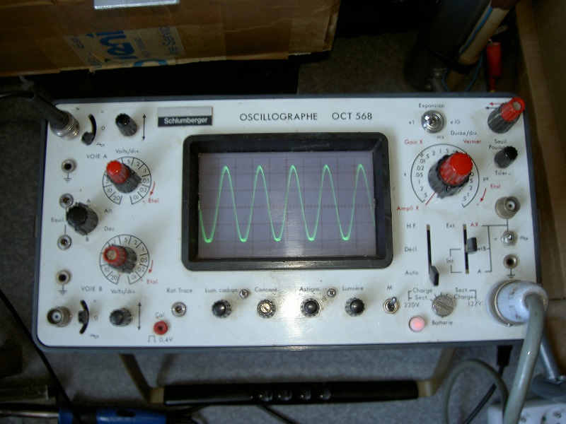

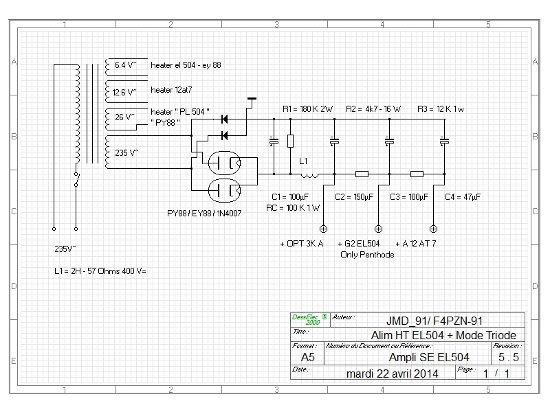

hello All 😉
i me re build me amplificator to mode " Triode " .
i joint the curve to oscilloscope ( 23 V CaC to 1 Khz for 8 Ohms ) and the schéma for EL 504 up EL 502 🙄 .
and big stock for long live " Class A " 😀
Alim HT SE EL 504 - EL 502 - 12 AT 7 - Rev 5.5 - mode Triode.jpg182.3 KB · Views: 291
Ampli Stéréo 2 x 8 W - 2 PY 88 - 12 AT 7 - 2 EL 502 - Mode Triode.JPG404.3 KB · Views: 308
