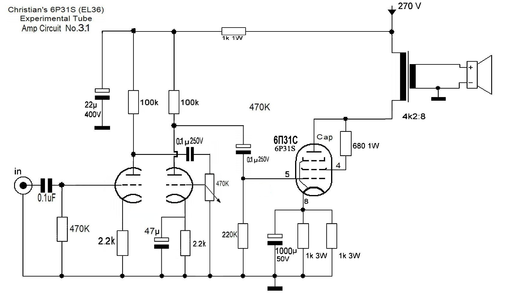

Hello Artosalo (and everyone else sharing),
I really enjoyed your 6P31S amp design, so I modified it to suit what I had around the workshop.
I had a lot of these 6P31S valves lying around so I decided to try to copy your design but to use a single triode for the preamp side rather than the 6N9S double triode (did u just "tie it together" and use it as a regular triode?)
I used a 6S4P (a cheap Russian audio triode) for the first stage.
Here is my schematic.
I changed the components around the 6S4P as per a pre-amp circuit I was familiar with so I hope it will be compatible. My tube theory is still kind of rusty as I need help reading tube datasheets to learn which components go with given tubes best.
Thanks in advance.
Feedback is welcome.

You have moved the volume potetiometer at the output tube. This means that the voltage amplifier 6S4P has full signal level at it's anode all the time.
My original idea is to have distortion cancelling. This requires that signal levels at the voltage amplifier and output stage are "tied together".
When output power is low, the voltage level at the anode of 1st stage should also be low, etc.
I suppose that now you have low(est) THD at full power, but higher THD at low output.

I like it, but could be a bit better. I think I will add some feedback or tone control perhaps. I tried using a 6N2P and doubling the pre-amp input with both sides of the triode but there was too much distortion.

Hi Artosalo,
Whether output power is low or not, the B+ shows a little variation. But the swing is lower at both stages and so is the distortion.
And keeping the first stage working at full power will inject more distortion from the first stage and the sound will be colored more by this stage, which is not necessarily bad, but if I decided to build a 300B amp, I'd like to have a more transparent driver so to listen to the output tube..and the OPT:)
