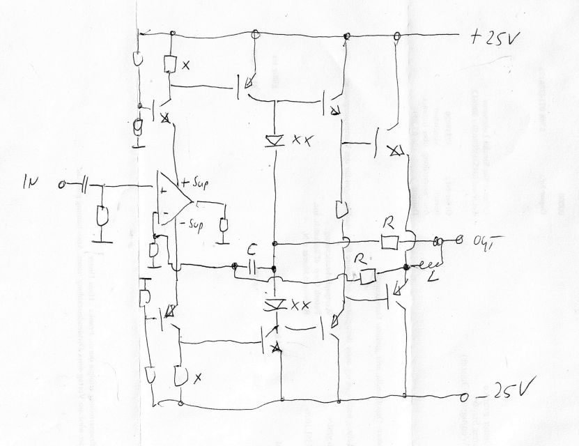

Why not simpler?
Current dumping can be simplified. Attachment is a sketch of a design.
The Opamps supply rails are used as outputs.
The problem is to keep bias of dumpers in class B.
A thermal coupling of diodes marked XX on heatsink will not ensure that.
Assume resistors marked X set bias as such that at room temperature idling current is 0 then the bias would not be
dynamically stable. Fast thermal runaway cannot be prevented.
Thus an overload or clipping protection circuit is mandatory.
It won't get much better with vertical FETs.
Hans Dieter

Yes that's much the same but no surprise it's a simple straight forward stuff. But I would not use darlingtons because one has to take care that in the power stage the BJTs have ton==toff
therefore I used the resistor between the emitters of the drivers.
However my design objective is first of all a particular sequence of the amplitude of harmonics close to the sprectrum of an acoustical music instrument the THD is not a big issue, next is the amp must fit into the speaker box backside enclosure and thus the size of heatsinks is limited and hence dissipation and output power. The famous equations of Quad hold for static sine signals
but possibly not for transient signals to evaluate is a matter of listening tests . Taking distortion reading with sine waves tells close to nothing about the musical qualities of an amp.
Very nice design. I've always been partial to the QUAD 405 and variations. I’ve built a few variations but was never entirely successful with MOSFET outputs due to the gate source bias. The 22 ohm resistor is a good way to overcome this with lateral mosfets.
In this version, and assuming very good sharing on the output devices, the peak current per device at 200 watts rms and 8 ohms would be 1.76 amps. At 4 ohms that would increase to 2.5 amps. The n channel devices will always have sufficient bias as the driving stage can supply plenty of current across the 47 ohm resistor. The current sink at 55 mA can provide 3.8 volts bias, which drops to 3.3 volts with the source resistors. From the output data sheet, it seems like the typical part requires almost 4 volts bias to develop 2.5 amps. Have you selected the output devices, or has this ever been an issue in the amplifiers you’ve built?
Again, very nice design and please do not take this as a criticism, just a question.
Thanks!
Thanks!
hahfran,
Very much agreed.Taking distortion reading with sine waves tells close to nothing about the musical qualities of an amp. THD is not a big issue
You won`t get it it with that IC.However my design objective is first of all a particular sequence of the amplitude of harmonics close to the sprectrum of an acoustical music instrument

Thank you Tom for input !
I'm always open to any suggestion which may improve this design.
47ohm resistor is part of current dumping bridge.
The bias resistor is R19 22ohm for laterals and 100ohm for IRFP verticals.
The full output power is given by class A stage voltage swing and not by voltage bias.
As I already mentioned, I run this amplifier in class AB with very little bias in class A. - Ids for laterals is ~40mA and for IRFP 60-100mA
But this is a error correction amplifier and should don't care too much about bias and therefore I don't match or select output devices.
Tibi
